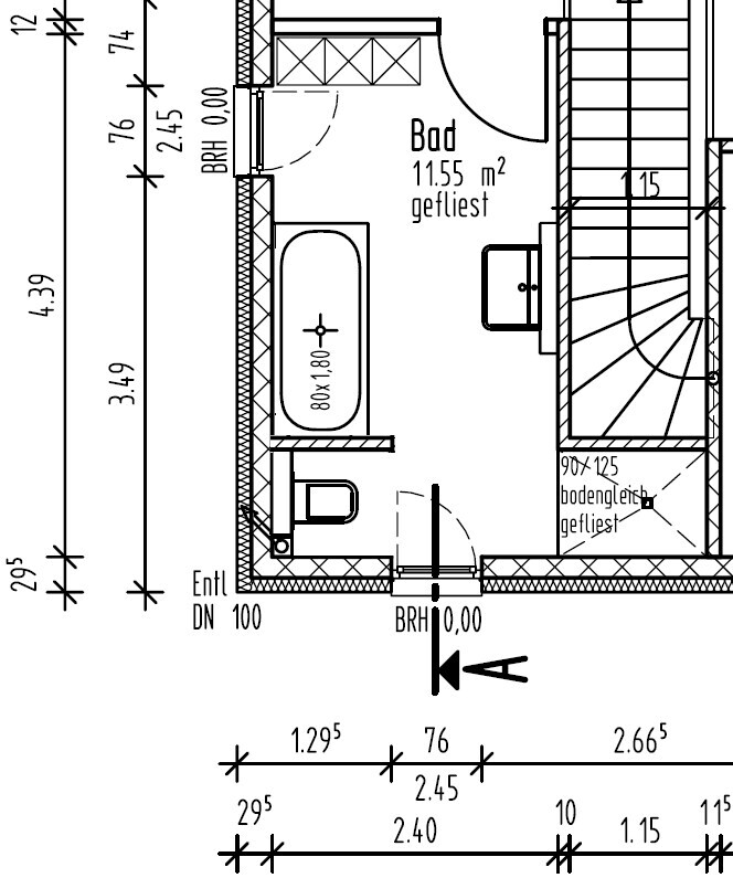

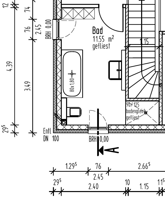

Our bathroom is currently planned as follows:

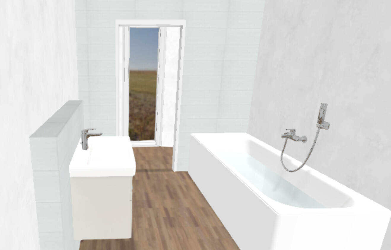

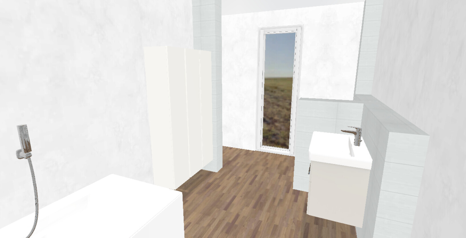

In a 3D view, it looks roughly like this:

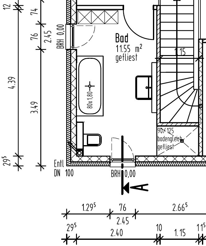

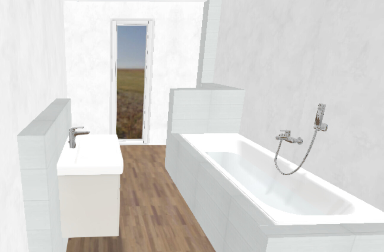

In the meantime, we came up with the idea of designing the bathroom differently:

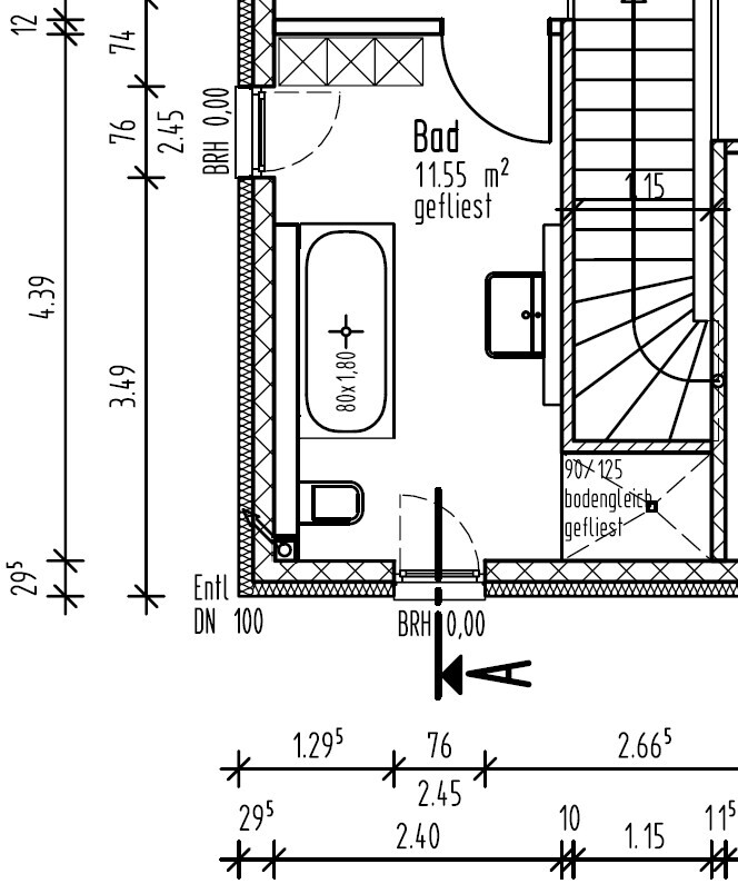

Alternatively, with a full-height wall and a door opening:
The original floor plan might seem a bit straightforward.
The other layout hides the toilet.
The question here is whether a clear width of 90cm (35 inches) could be a bit tight?
The half-height wall variant might make it feel more open, but the downside is that the bathtub doesn’t line up with the half-height wall. The wall behind the toilet has to be 20cm (8 inches) deep because of the ventilation pipe in the corner. The bathtub is 80cm (31.5 inches) wide. Accordingly, the half-height wall would only be about 60cm (24 inches) long, which is not much space for the toilet. If you want to extend the wall, a 10–15cm (4–6 inches) casing around the bathtub would be needed, which would then narrow the space between the bathtub and the sink again.
The alternative with the full-height wall has the advantage that the bathtub wouldn’t require a casing. However, the area behind the wall might feel quite narrow and corridor-like (90 x 365 cm / 35 x 144 inches clear width).
What do you think?
What do you think?

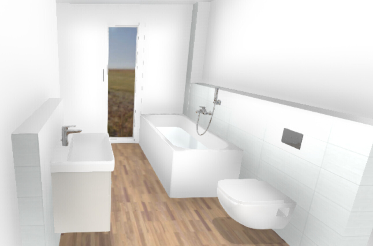

[IMG alt="narrow bathroom2.jpg"]https://www.hausbau-forum.de/data/attachments/42/42594-eb756f486a81d49a9335214744ece1e3.jpg[/IMG]IcThis could perhaps be an alternative.In 3D, it might look like this ... I extended the shower wall a bit so the wall-mounted cabinets can lean against it while also lengthening the shower.
-SCEPS- schrieb:
In 3D, it might look like this... I slightly extended the shower wall so the wall cabinets can lean against it, while also lengthening the shower.
Now adding a bathtub with a rounded corner (the one closest to the sink). However, the question is whether the privacy panel will make the area around the sink too dark?I would remove the walls. The bathroom becomes too small.
Although 11 sq m (118 sq ft) is not exactly small, partition walls act as barriers, making it visually feel like only 7 to 8 sq m (75 to 86 sq ft).

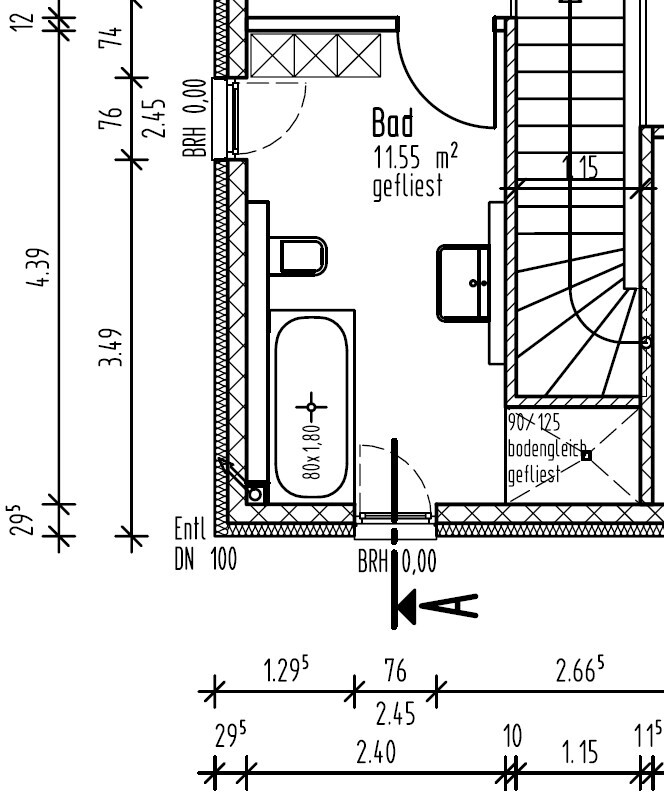

I like having the toilet opposite the shower, but without a privacy screen. Is that what you mean? In that case, the space between the bathtub and the washbasin is still quite tight.
Or did you mean it like this?
The WC wall adjacent to the bathtub looks a bit odd:
Or placing the bathtub in the middle between the toilet and the window:
