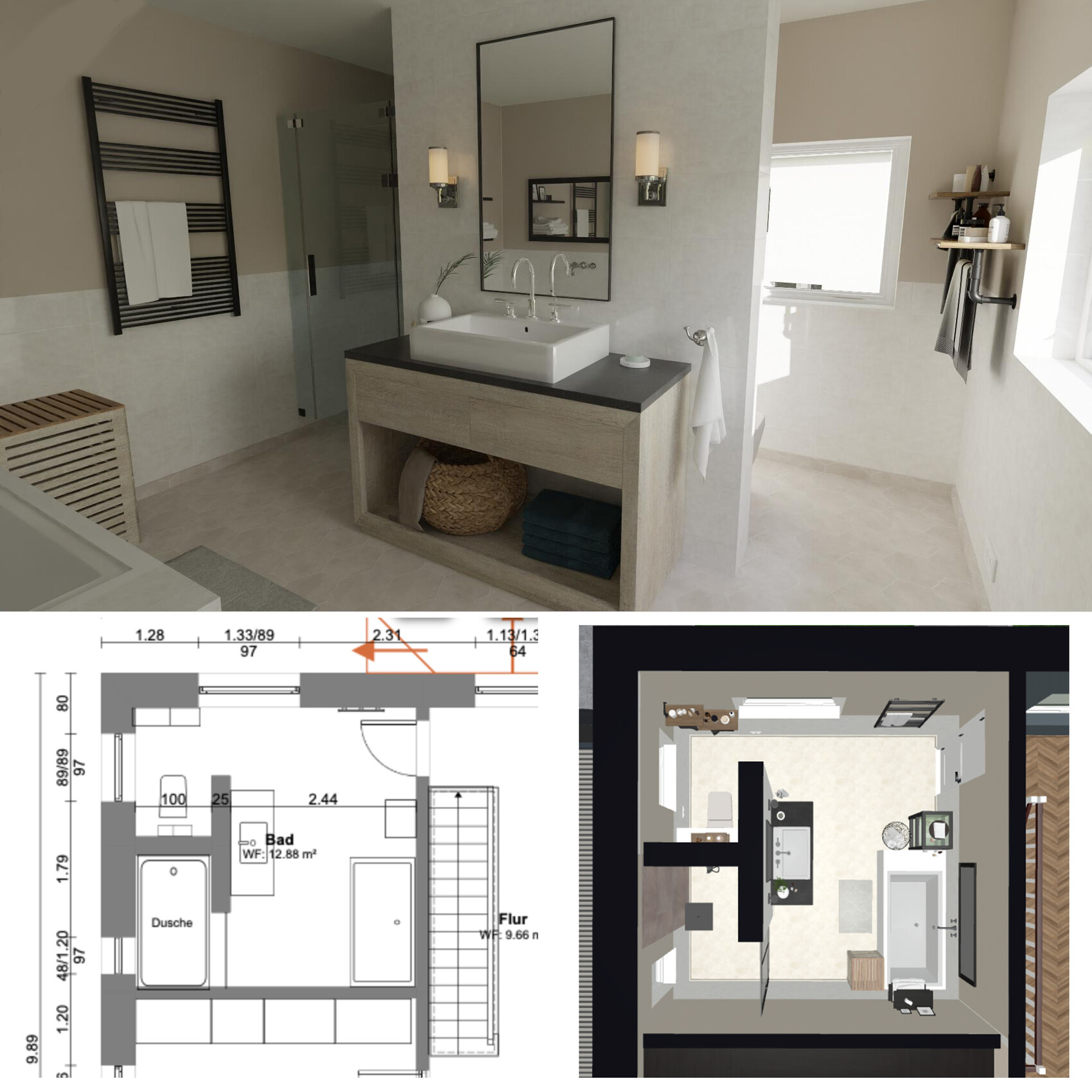

Of course, this is also about a new design; I never said otherwise. I just asked because I wanted to know where you would place the L-shape. That wasn’t clear to me.
As an alternative, I tried this T-layout. What do you think?
Modern bathroom with double sink, mirror, shower, shelf; floor plan and 3D view.

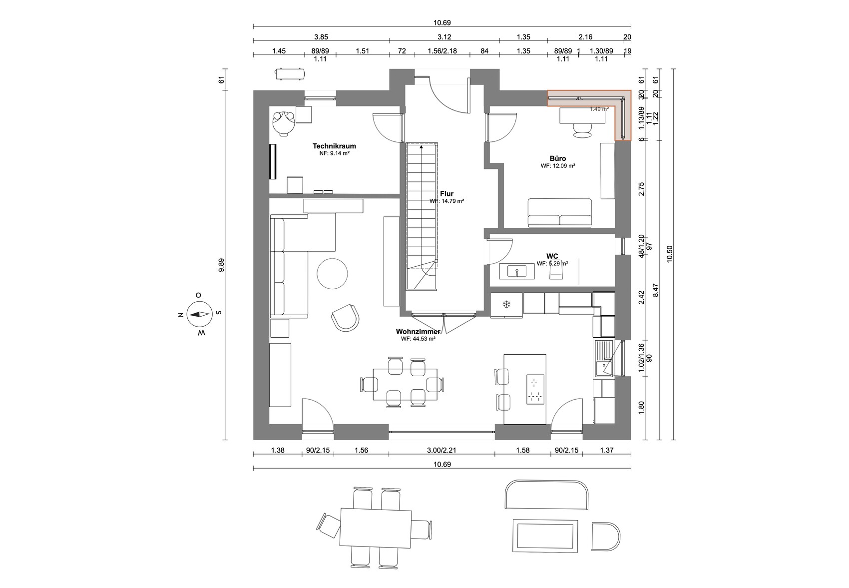

I’ll attach the ground floor plan for you. That’s a great tip about the partition wall, I had just made it thicker at first for safety. The house is a solid construction, but the walls will probably be drywall.
Floor plan of a house with living room, dining area, kitchen, office, utility room, hallway, and WC.

How is the view from the outside? There is a house on the right, so the neighbor can easily see what’s going on in the bathroom. Opposite is probably another house as well. So the corner window is more likely to be at the desk.
In my opinion, the T solution is the better choice for such a large bathroom.

After trying my hand at the bathroom, I actually wanted to say that three windows are one too many and not good for bathroom fittings. Also, I wanted to ask where the downpipe will go and only just now noticed the ground floor plan. And honestly? It’s not that great.
What happened to the space between the staircase and the partition wall to the open area? The open area, where it should be most spacious, is barely over 3 meters (10 feet) wide. No one can sit there watching TV if the table is occupied. There’s just a small niche for the lady’s shoe cabinet in the wardrobe—nothing more. And having the WC facing south with only about 1 square meter (11 square feet) of south-facing windows in the open area makes the whole place dark from east to west.
I had thought there was already a final plan and that now only the bathroom would cause problems, but honestly, this is not even ready for detailed planning.
Planning 180 square meters (1,938 square feet) in a DIY way, everything ends up as a compromise. The software doesn’t think for you. The software might produce nice renderings, but it doesn’t turn someone using a mouse into a planner or architect.
