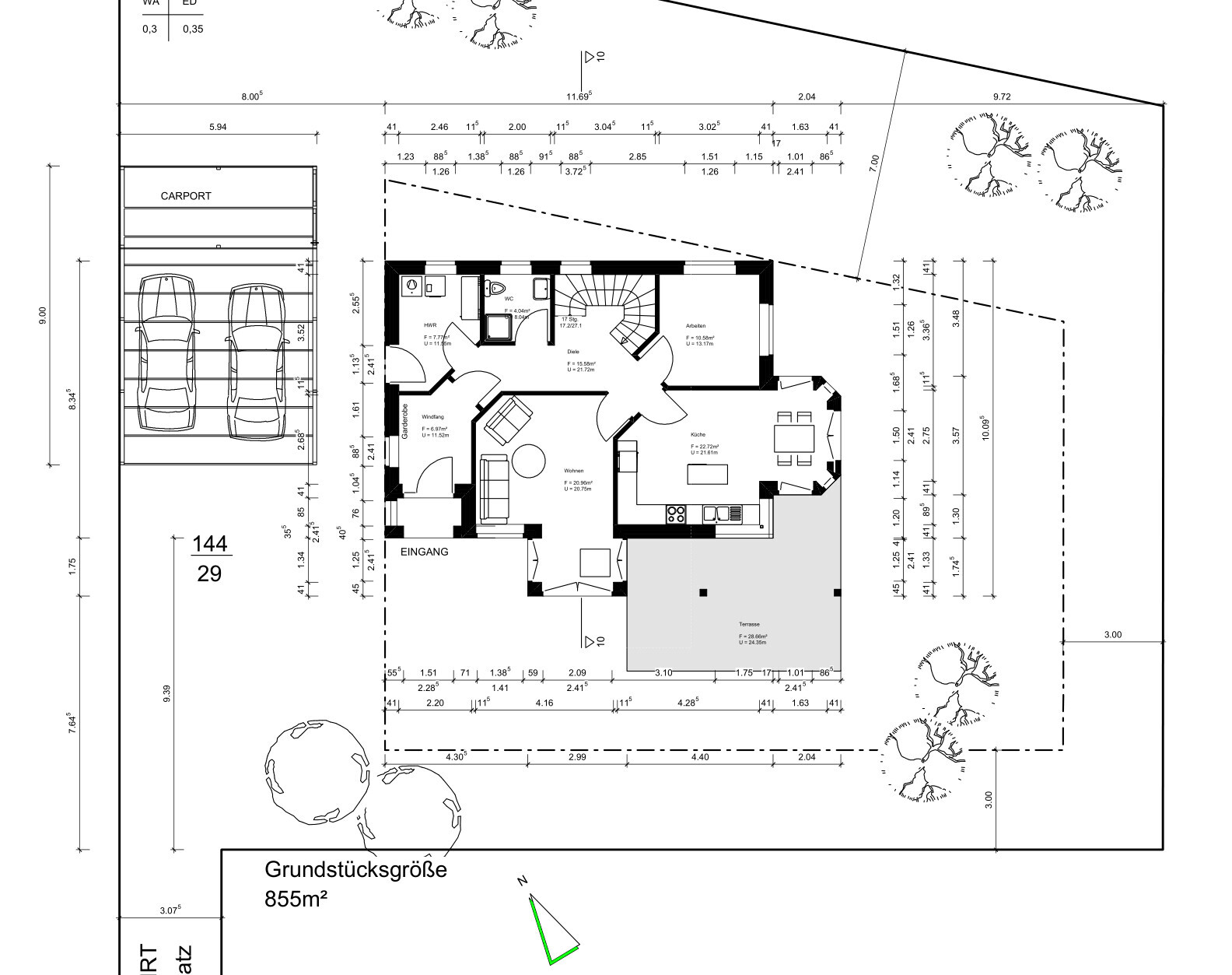

I have now also added the floor plan for the ground floor. I thought this might be irrelevant for the bathroom planning. Of course, I am also happy to receive feedback on this, even though there is not much left to change.
As mentioned, I am only looking for ideas for the bathroom but didn’t want to withhold anything from you.
At the moment, trades are being tendered, which means some minor changes could still be made during the shell construction phase. However, we would prefer not to redesign the rooms. The planning process has already taken long enough, and we are very happy with it (except for the solution with the "canopy" that wraps halfway around the house).
overseer schrieb:
Unfortunately, I don’t like standing “diagonally” in a room. Considering you don’t like standing diagonally in a room, you actually have an incredible number of angled walls and doors in both the ground floor and the upper floor. Your statement doesn’t match your floor plan. For this reason alone, it would make sense to straighten out many of these corners. Just on the ground floor, you have 5(!) interior doors where you enter the room in the same way as with kaho’s corner shower.
I know you don’t want to change the floor plan, but maybe your quote will at least encourage you to think thoroughly about it.
First of all, thank you very much for your help and suggestions regarding the bathroom; I really appreciate your ideas!
Unfortunately, we are drifting a bit away from the main topic. The floor plan of the house has developed quite dynamically, involving many compromises. Even though I’m aware of the irony, I like the sloped ceilings in the hallways and rooms, but I don’t necessarily want to stand at an angle in the shower. Sounds strange, but that’s how it is.
We have tried right angles in many previous iterations, but none of them were really good. We don’t like open-plan kitchens with living areas; they look great but feel too uncomfortable for us. Laundry, cleaning supplies, and cloakroom will all be on the ground floor. We also have enough storage. Overall, the ground floor layout seems to distract more than it helps.
