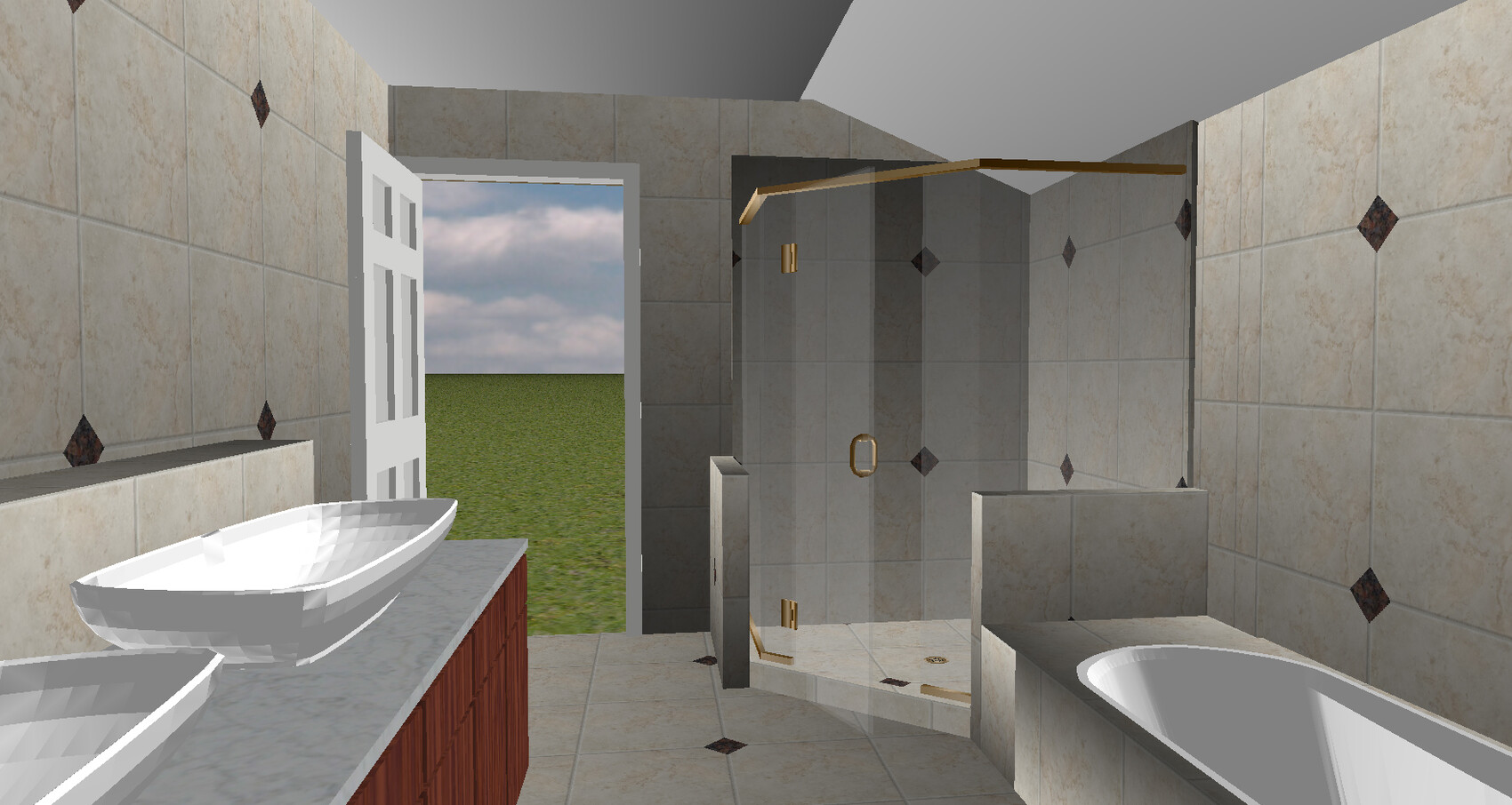

I can’t quite follow your point. The wall would be boxed out at 2m (6 ft 7 in). The shower then goes up to the ceiling under the slope. If it should be higher than 2m (6 ft 7 in), I would just box it out further forward.
Here is a quick sketch, although you’ll need a bit of imagination for the glass extensions.
kaho674 schrieb:
I’m having a bit of trouble following you. The wall would be boxed out at 2 meters (6 ft 7 in). The shower then extends up to the ceiling under the sloped roof. If it needs to be higher than 2 meters (6 ft 7 in), I would simply box out further toward the front.
Here is a quick sketch, although you do need some imagination for the glass extensions.
[ATTACH alt="vorschlaege-für-Aufteilung-des-badezimmers-15m-332016-1.jpg"]35883[/ATTACH] Thanks for the visualization, I always find that very helpful. I think it looks quite nice.
So - if building the half-height wall above does not create a triangular gap between the privacy wall and the roof slope, it should look acceptable.
overseer schrieb:
Thanks for the visualization, I always find that very helpful. I think it looks quite nice However, the door does not actually lead out onto the lawn.overseer schrieb:
Won't that make the shower area a bit too dark?One light provides enough illumination.
