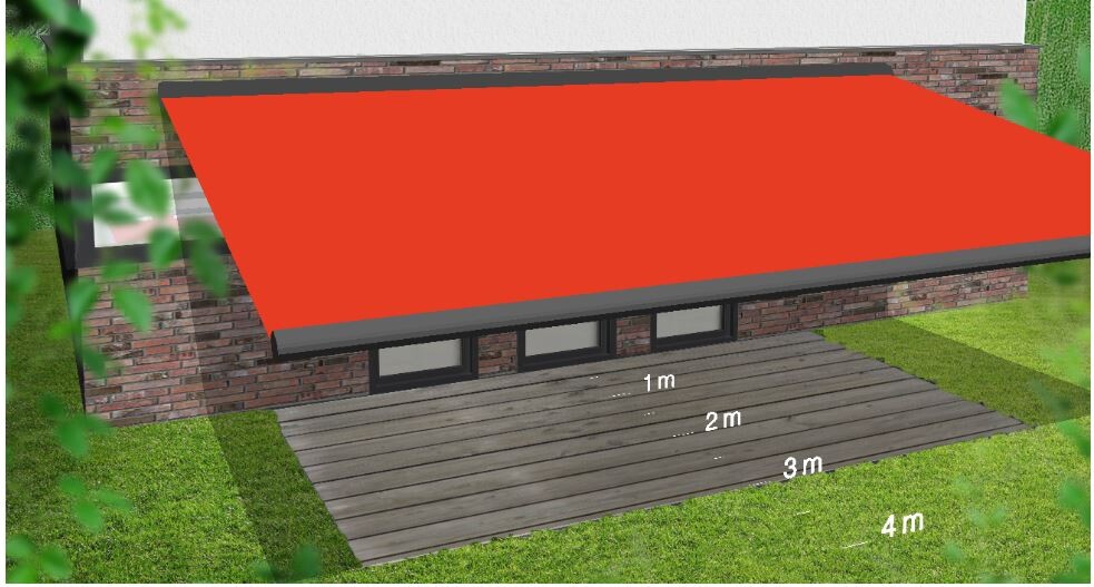

According to Markilux, the minimum amount of shade during midsummer on August 1, 2020, between 11 a.m. and 12 p.m. would look like this:
Since the ground floor ceiling extends 110cm (1.1 meters) (about 3.6 feet) over the seating area, we would have roughly a 4-meter (about 13 feet) shaded area where we could sit.

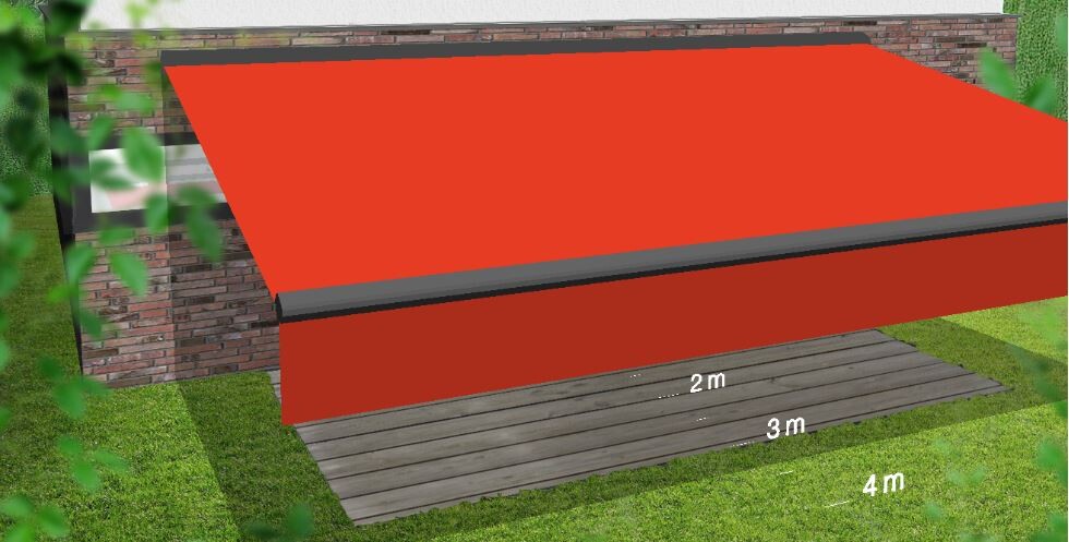

Is this correct? In that case, we might want to consider adding a valance. That could give us a bit more coverage. Here’s an example with a 50cm (0.5 meter) (about 1.6 feet) valance:
It doesn’t make that much of a difference and would certainly increase the cost quite a bit...
