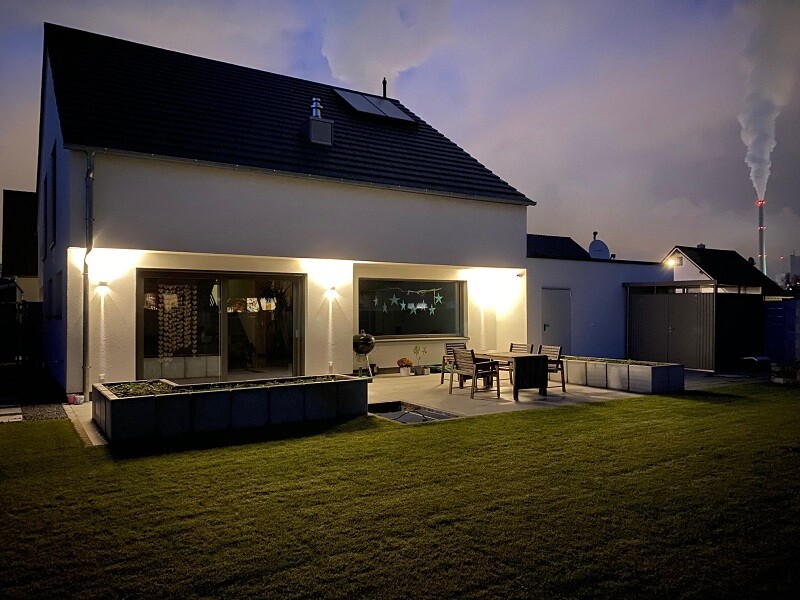

Here is a picture:
The upper floor slightly protrudes. There is a bend in the middle of the exterior wall. The middle light would basically be where the awnings would be divided if there are two. Unfortunately, the downspout is all the way on the far left, so I cannot make two awnings of equal size.

Here is a picture:
Matthew0326 Mar 2020 11:45Why do you even need one on the left side? In the photo, it looks like there is just a "traffic zone" there, while the social area seems to be on the right... So, based on the photo, I would personally add an awning on the 5 meters (16 feet) to the right, and then sunbathe on a lounge chair in the garden.
