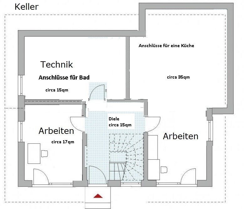

Ypsi aus NI8 Jul 2020 22:42Please keep: floor plan with technical room in the basement / pantry on the ground floor updated and include measurements. Only then can you receive help here.
pagoni20208 Jul 2020 22:53Thirteen schrieb:
The utility room will not be removed. It is planned to be converted into a pantry. The pantry does not need to be that large; perhaps the space could be used differently.
I always find it difficult to have only one full bathroom per floor and almost none downstairs. While it may be fine when the children are small and cute, it soon becomes stressful. Therefore, I would definitely suggest having a shower/toilet room in the basement; otherwise, any guest—even if rare—would have to go upstairs.
From your new basement floor plan, it looks like you might have a complete apartment down there (possibly even rentable), so I would definitely consider a separate entrance at the ground floor. However, the rooms should also be arranged in a way that makes a separate living space possible at some point.
You never know what life might bring, but having your own (or at least an independent) apartment in the basement can really be a lifesaver.
We have actually already considered this, which is why we would like to have kitchen and bathroom connections installed. However, we haven’t quite found the right solution yet. Maybe someone here has a great idea on how to design the basement to make it a suitable living space for later use.
The basement, dictated by the terrain, must be utilized; you cannot count its area as a bonus and waste it carelessly. Every square meter has a cost. Therefore, the basement level needs to be made fully functional. There is a causal connection between “the main house provider does not acknowledge the basement” and “the main house provider does not consider that the basement still needs to fit within the budget.” This is ONE house, and none of the parties involved can neglect to think of it as a whole.
pagoni20208 Jul 2020 23:41I’m not really an expert in floor plans, but I had a similar situation in my old house. At some point, it was extremely valuable to have it set up that way or to create it with simple means. There are countless scenarios imaginable—some negative, some positive. You just have to make sure that the stairwell doesn’t divide the rooms, or that the rooms can be used together without having to go through the stairwell.
In my case, the problem was that you could only access the heating/tank room through the basement, so I ended up adding a door from the outside. The utility room should be accessible either from the stairwell or from outside.
In the end, I divided the place into three units and sold them one after another as individual apartments. That’s life. The neighbor had a similar house, but due to the location and the stairwell, this option wasn’t possible. Maybe it makes sense for you, so I would definitely plan for it—that’s doable! Another option could be to use it later as two separate apartments... at that stage, it’s often worth having a clever idea and preparing a few extra pipes. Kids get older, a partner... university... emergencies in the family, etc.
You can’t foresee everything, but this turned out to be very important for me.
@11ant describes it absolutely correctly; I would have the basement built from the start, so in your case, only solid construction (e.g., poured concrete or masonry) would be an option for me. As I said, we used the basement (similarly to yours) in many different ways over the years. For a while we moved the bedroom and dressing area down there, then it became a larger office with storage, then an apartment for our adult child, and eventually rented or sold.
THAT is a significant increase in value, and I would seriously consider how to integrate the “basement,” which is essentially living space, into daily life. Just as a basement, it’s too expensive, and upstairs there isn’t enough space to make it generous.
