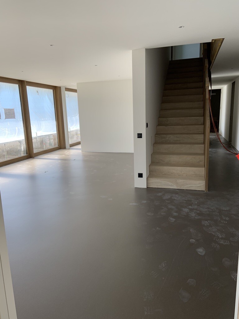

We are also building on a slope; here is our "basement level":
The main entrance is on the ground floor, but we have prepared a door so that an entrance can be made later at the basement level (currently a standard patio door with a three-point lock), also keeping in mind the possibility of creating separate units in the future.
