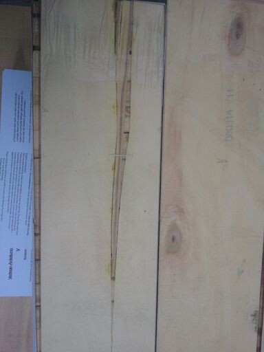

we ordered three-layer oak click parquet online.
There are gaps in the underside, which are partly held together with binding threads.
I found this a bit concerning and contacted the seller, who said:
"These gaps are located in the backing veneer layer, which acts as a counterbalance to the top layer. Normally, this is not a problem.
If it bothers you, you can take pictures, but the manufacturer’s response will be as I described. No problem.
The thread: the backing veneers are sewn by hand … the thread you see is the yarn used for this."
So far, I have not been able to upload a photo (error despite 20kb).
What is your opinion?
Thanks and regards
KF55W

This should not be a problem, as this veneer is used as a back veneer solely to counterbalance the face veneer on the front side. Therefore, the veneer only expands or contracts along the grain direction.
