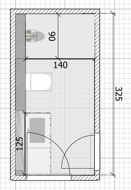

Toxic85 schrieb:
For us, the long side is the kitchen wall. I didn’t mean that you should move the door. I just wanted to explain how it is in our case. To clarify, here is our bathroom:
Draw the desired furniture to scale everywhere, especially in the living/kitchen area.
Where exactly is north, and where will the terrace be located?
The bedroom is quite narrow. There’s only 65cm (25.5 inches) of space on each side of the bed.
The walk-in closet is also very narrow. A wardrobe needs at least 50cm (20 inches) of depth, leaving at best only 80cm (31.5 inches) of space between them.
