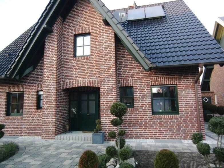

DarthVader schrieb:
Then we also showed him which houses we like and showed him some pictures. Here is one of them:
You won’t get that for 200,000 euros; for 140 square meters (1507 square feet) of living space without facing bricks, it already costs around 200,000 euros. I know this quite well because we are currently building it with two Frisian gables.
Regarding the architect, you need a creative mind who also keeps the budget in mind; in my experience, that is a rare breed among architects – at least among those I have dealt with over the years, and that was quite a few.
As for the cladding, you should cross it off your list given your target budget and instead use paint to create accents; just my humble opinion.
