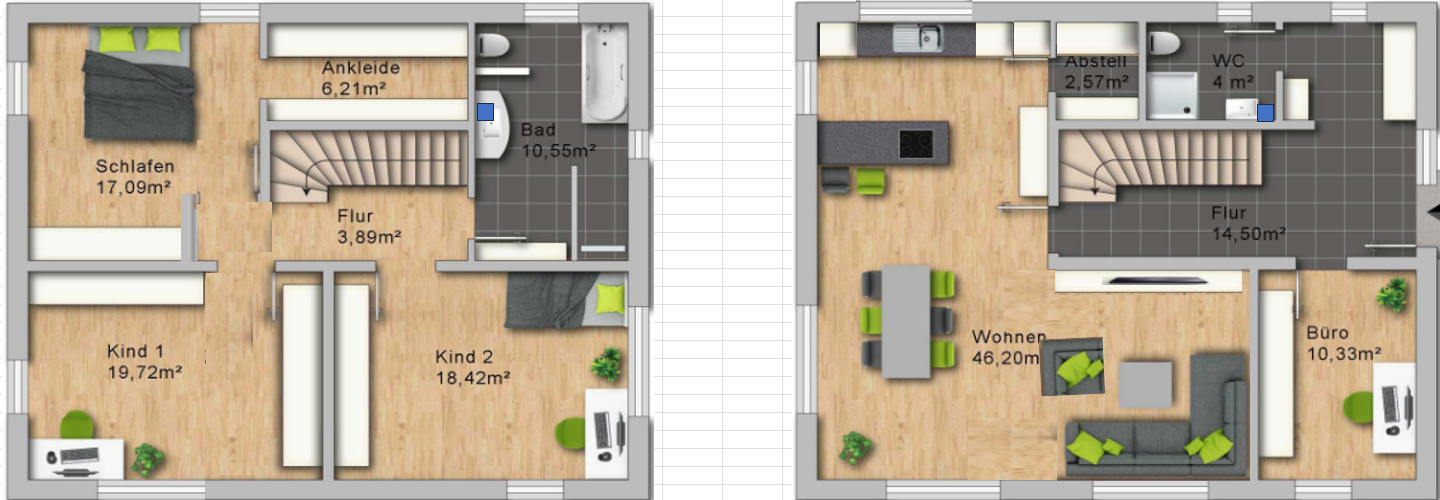

As a basis for discussion, I am attaching the standard design from Company C. We had planned to extend the original 9 x 11 m (30 x 36 ft) floor plan by 50 cm (20 inches) on the entrance side (to fully utilize the building envelope of 9 x 11.5 m / 30 x 38 ft) and allocate the additional space to an office, guest toilet, bathroom, and second child’s room.
The living area would thus increase from approximately 153 to 158 m2 (1,645 to 1,700 sq ft). The entrance was planned on the north side, with the garage and parking space on the west side. Unfortunately, we only have the design without dimensions.

hanghaus202313 May 2026 06:14I cannot understand the architect’s idea of moving the house 1 meter (3 feet) forward. The 5 meters (16 feet) would have been sufficient for a parking space, even without a double garage. Then you wouldn’t need to park one car behind the other. Who would want that?
hanghaus2023 schrieb:
What did the architect’s design look like? Or was it only about the location on the property? The architect’s design only included the building’s exterior shell and its position on the plot.
I don’t understand the architect’s idea of moving the house 1m (3 ft) forward. The 5 m (16 ft) would have been enough for a parking space, even without a double garage. Then you don’t have to park one behind the other. Who wants that? Basically, one parking space is completely sufficient for us. We only own one car, and a second one is not planned. Also, there are usually free parking spaces available in front of the property. So, parking one behind the other would not be an issue for us in everyday life.
One reason for moving the house was, among other things, a walnut tree located relatively centrally on the plot. We would actually like to remove it or replace it with another tree. However, to give the environmental authority as little “leverage” as possible during the evaluation of the preliminary building permit and at least keep the option of preserving it open, the house was positioned this way. If it makes the planning easier, it could of course be reconsidered during the building permit application process.
I don’t understand the garage versus carport discussion.
So here is my opinion about your house.
Without considering the cardinal directions, I like the overall layout. Everything feels very harmonious.
After reading the text again: I especially like the entrance being on the north side. That your bedroom is then on the south side is also very positive for me personally. However, I would do something different with the children’s rooms: I suggest making the rooms identical, exactly the same size (19.07 m² (205 ft²)), and each with only one (large) window facing east.
Regarding the living room, I wonder if I would always want to look at the TV from the side, with windows to the left and right of the TV. If you want to keep the room layout as it is, I would shift the north window of the living room slightly further south (if you are sitting on the sofa, move it more to the right and the TV further to the left). But maybe this would make the living room a bit darker, or create a sort of home theater feeling…
One more thing that comes to mind: if the parents are lying in bed, they might hear the flush sound from the upstairs bathroom every time.

hanghaus202313 May 2026 10:28H
hanghaus202313 May 2026 11:44I made some adjustments.
The children's rooms are the same size. Depending on the view, the windows might still need some optimization.
The chute for laundry is marked in blue. The utility room is probably located in the boiler basement. The washing machine and dryer should then be placed against the stair wall in the basement.
I made some adjustments. I also like the idea of having equally sized children's rooms.
I've already heard from a few friends that windows can be a major cost factor in house construction. That's why I would only include one.
Regarding the TV issue: Haha, I'm so silly. You are a genius.
- Simply swap the sofa and TV instead of repositioning the window.
