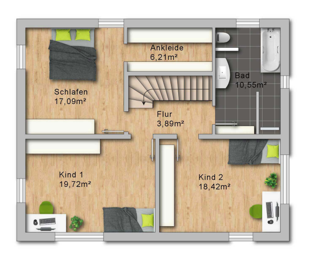

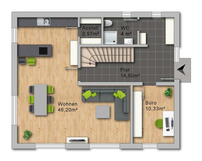

As a basis for discussion, I am attaching the standard design from Company C. We had planned to extend the original 9 x 11 m (30 x 36 ft) floor plan by 50 cm (20 inches) on the entrance side (to fully utilize the building envelope of 9 x 11.5 m / 30 x 38 ft) and allocate the additional space to an office, guest toilet, bathroom, and second child’s room.
The living area would thus increase from approximately 153 to 158 m2 (1,645 to 1,700 sq ft). The entrance was planned on the north side, with the garage and parking space on the west side. Unfortunately, we only have the design without dimensions.

I don’t understand why, considering the daily routine mentioned, the windows and living areas are placed on the east side while the secondary rooms face west. After work, the west side is much more important than the east.

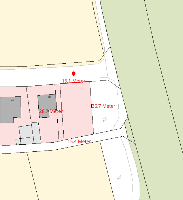

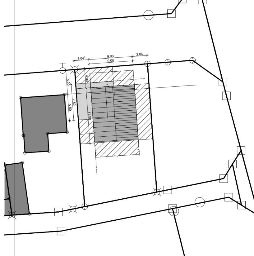

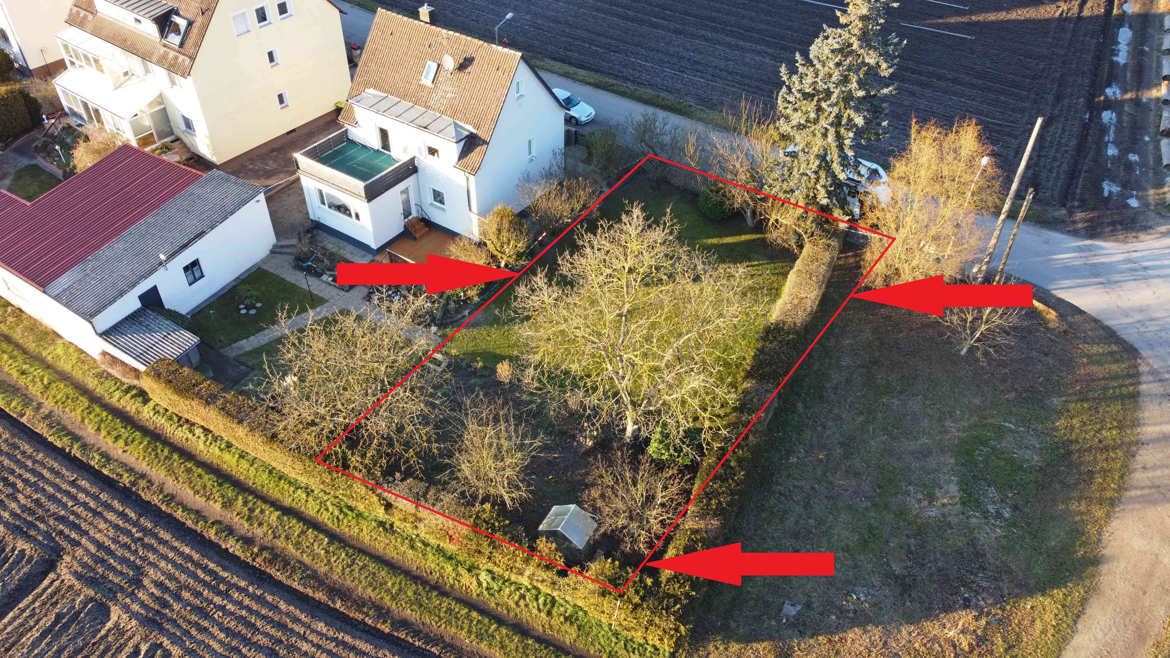

The parking space is only 4 m (13 feet) wide. If the building authority accepts the solution with the proposed parking spots, that’s good. A small car will also fit on the green parking space.
Our plan was to place a pre-fabricated garage (3 x 6 m (10 x 20 feet)) on the west side, near the end of the house, and the other parking space directly in front of it. So blue would be set back a bit and green shifted left on your picture.
hanghaus2023 schrieb:
But the walnut tree blocks a lot of light.
Yes, that is also our concern. In addition, it would complicate the construction phase (excavation slope, root barrier, etc.).
Will the plot to the east also be developed?
The plot to the east belongs to the city and, based on all the information we have, is not planned for development.
mmyellow schrieb:
I also like the idea of the children’s rooms being equal in size.
The designs in the first post are the 9 x 11 m (30 x 36 feet) version (I probably should have made that clearer). With the expansion to 9 x 11.5 m (30 x 38 feet), there is some extra space to make the rooms almost equal in size.

Have you taken a close look at my floor plans? They have already been extended to 11.5 m (38 feet). The children's rooms are the same size. Above all, I believe the access points have been improved somewhat. The one from the bedroom as well. I don’t like entering a room and immediately facing a closet.
Are there also elevations?

tbhr27 schrieb:
Our plan was to place a prefabricated garage (3 x 6 m) (10 x 20 ft) on the west side, relatively close to the end of the house, with the other parking space directly in front of it. So the blue area moves slightly backward and the green area also shifts left on your picture.
My blue window should be a covered parking space, with a glass roof so that light can still reach the windows. There are patio canopies that can be used for this purpose, which generally cost about half as much.
If the walnut tree can be removed, then the house could also be moved 1 m (3 ft) further back.
The kids’ rooms are the same size. In my opinion, the access points have already been somewhat improved.

Are there any elevations available?
Unfortunately, we only have this picture from the company catalog:
My blue window is supposed to be a covered patio, with a glass roof so that the windows also get light.
What advantages do you see in a covered patio compared to a garage? At first, we were leaning towards a covered patio, but then switched to a garage (costs are relatively similar, somewhat wider driveway with the same external dimensions, no scraping ice in winter). If the garage is moved to the back, there would be no windows blocked there at least with the standard design.
If the walnut tree can be removed, then the house can be moved 1m (3 feet) further back.
How would you use the extra space in the front garden, or why prefer 5m (16 feet) instead of 4m (13 feet)? Whether it is possible depends on whether we are allowed to cut down the tree or not.
