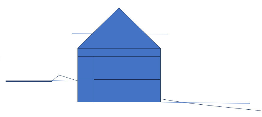

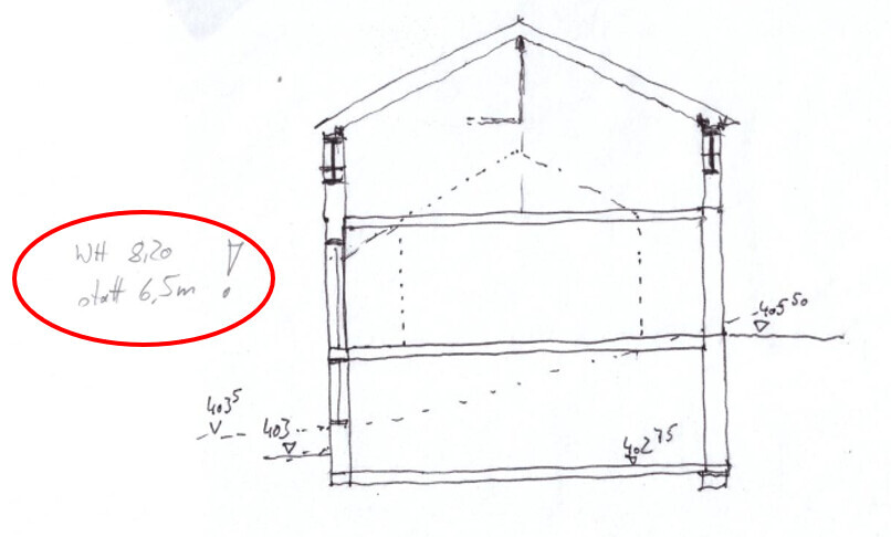

Slope: South-facing slope, access from the north, slope drops about 2.5 m (8 ft) to the south in the area of the house.

Basement, stories: basement with garden access on the south side + 2 full stories

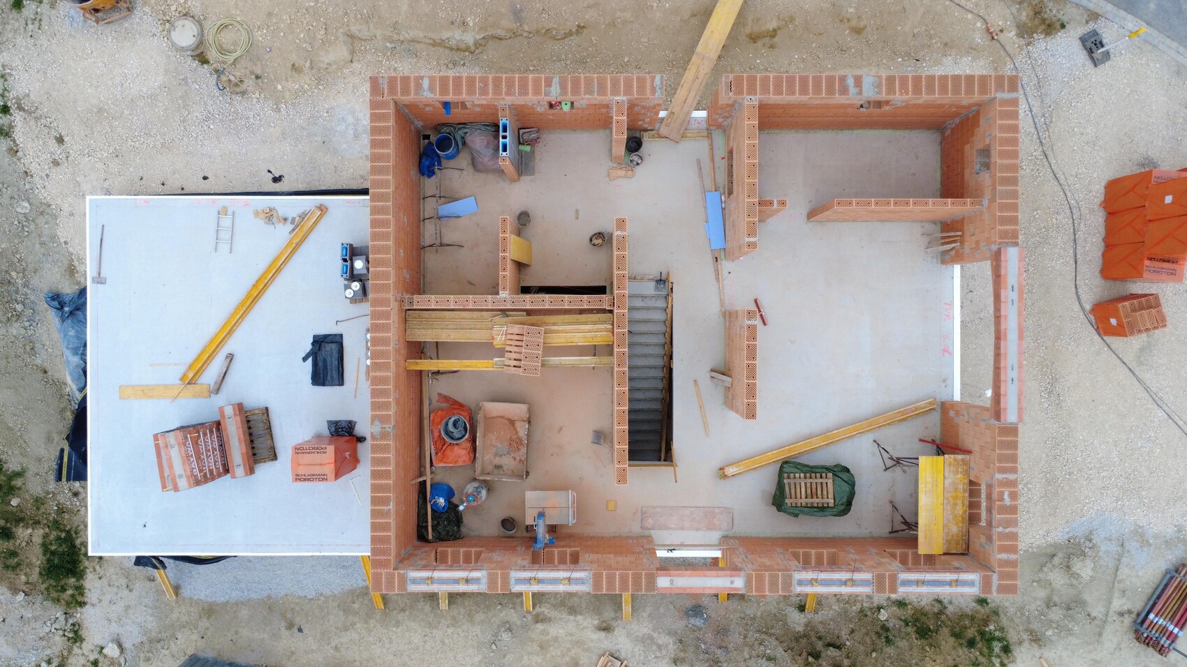

After more than a year, here’s finally an update from us.
The shell of the building is partially completed. It’s really exciting and demanding, but the anticipation outweighs it.
So far, I like best how we designed the large window facing east. We created an “arched opening” here. The external venetian blind was installed a few days ago. I truly enjoy seeing the arch every time — it turned out really cool.
