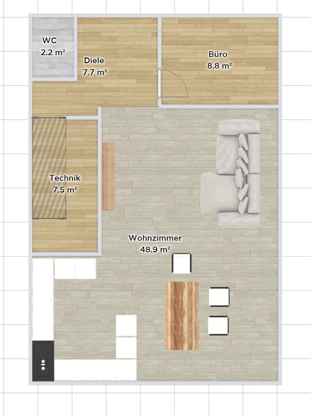

Harald_071123 Jul 2024 20:28At the moment, I like this design best. The only concern I have is the note and the idea about "walking through the living room" or the TV area; I still need to think that over.
@ypg From my research, a utility room of 7.5m² to 8m² (80 to 86 sq ft) should be realistic. Have you had different experiences?
The staircase is drawn with a width of 1m (3.3 ft). Is that too narrow?
@K a t j a This is the kind of staircase it is meant to represent; unfortunately, the software doesn’t offer the exact representation. The furniture dimensions are realistic and correspond quite precisely to our furniture (sofa 3.15m wide (10.3 ft), table 2m x 1m (6.6 ft x 3.3 ft), TV stand 2m wide (6.6 ft)); only the kitchen is just roughly sketched in. In a living-dining area of nearly 50m² (540 sq ft), I think this should still feel spacious enough.
Harald_071123 Jul 2024 21:39K a t j a schrieb:
I’m a bit skeptical about the space under the stairs. It’s not empty air or anything. It looks really tight to me. What exactly is supposed to fit in there? Ideally, you should furnish it as well.I’m guessing house connections, the heat pump indoor unit, the fuse box, possibly the solar inverter if it can’t go in the garage storage, and the washing machine and dryer.
I still need to figure out how to cleverly fit all that in.
Harald_0711 schrieb:
Can you do without it: knee wall / storage space inside the house, You’re the first person who says they can do without storage space. The only way to explain that is that you don’t do anything at home, not even changing batteries.
@ypg A technical room of 7.5m²–8m² (81ft²–86ft²) should be realistic based on my research, or have you had a different experience? What kind of research? What exactly did you research? Many devices had to be removed because they were installed too close to the wall, making it impossible to access them later with tools.
And you want to move around in that room when doing laundry or taking out the ironing board.
By the way, I refer to this:
https://www.hausbau-forum.de/threads/die-liste-die-jeden-bauherren-zu-interessieren-hat.34418/
Harald_071123 Jul 2024 22:36ypg schrieb:
You’re the first person to say you can do without storage space. The only explanation for that is you don’t do anything at home, not even changing batteries.
What research? What exactly are you researching? Many devices have had to be removed because they were installed so close to the wall that later you can’t reach them with tools. And you want to be able to move around the room when doing laundry or taking out the ironing board.
By the way, I refer you to this:
https://www.hausbau-forum.de/threads/die-liste-die-jeden-bauherren-zu-interessieren-hat.34418/ Is this forum here to help and share information, or to accuse people of not doing anything at home?
The storage room behind the garage is intended as a basement replacement and is 2sqm (22ft²) larger than our current basement. Obviously, that’s not a huge difference, but - drumroll please - cordless screwdrivers, drills, and so on (Bosch and Festool case systems greet you) fit very well.
Also, what I meant by that sentence was that the planned kneewall (or knee wall) in the upper floor is not absolutely necessary.
I don’t know if it’s still possible to add an attic in the upper story with the current plan, but that could be an alternative.
And what do you research when it comes to a utility room? For example, by asking Google how large a utility room for a single-family house with a heat pump should be, and then looking at several manufacturers' websites. But I’ve already realized that I need to look into this topic more carefully.
Thanks again for linking the other article.
motorradsilke23 Jul 2024 22:43Harald_0711 schrieb:
Is this forum meant for helping and exchanging ideas, or for telling people they don’t do anything at home?
The storage room behind the garage is planned as a basement substitute; it is 2 square meters (about 22 square feet) larger than our current basement. Of course, you can’t expect huge improvements, but—drumroll please—cordless screwdrivers, drills, etc. (Bosch and Festool case systems, greetings) fit very well there.
Also, by this I meant that the planned knee wall in the upper floor isn’t absolutely necessary.
I don’t know if it’s still possible to add an attic space in the upper story with the current plan, which might be an alternative.
And what do you research regarding the technical room? For example, by asking Google how large a technical room for a single-family house with a heat pump should be, then looking at several manufacturers’ websites. But I have also gathered that I need to take a closer look at this myself.
Thanks again for linking the other article. Please note that unlike a basement, you cannot store anything frost-sensitive in this storage room. So paint, silicone, adhesive tapes, batteries, flower bulbs… must be brought inside the house during winter (and not to the attic).
