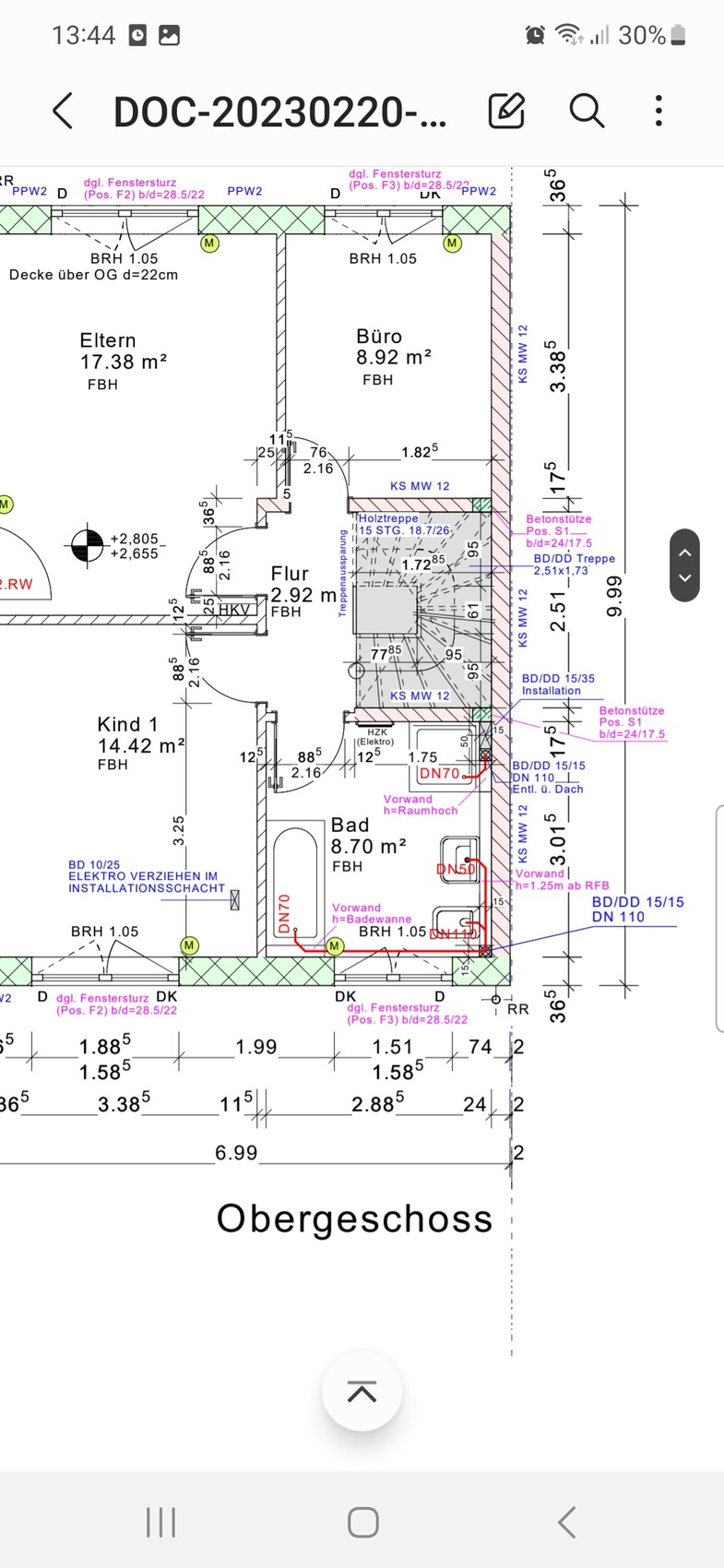

Now that I have to pattern the bathroom, I’m told the drain pipe is fixed in the corner where it’s marked... but apparently it can be moved... I’m not exactly sure. So, the limits are at most the wall below and to the right of the window and the wall on the right.

So, the maximum walls would be along the bottom right next to the window and on the right side. That the toilet can only be positioned there.
With your wishes like the sink on the left side, the toilet would also need to be placed on the left side. And in that case, the toilet drain would have to be oriented towards the left wall. Since it is now on the right, having the shower, bathtub, and toilet all on the right side doesn’t really work out well. That’s just how it is.

xMisterDx23 Apr 2023 19:13Drilling a 150mm (6 inches) core hole shouldn’t require an excessive amount of effort. The only question is whether it is structurally feasible, considering the reinforcement in the ceiling.
Given the current openings and the double window with a sill height of 105cm (41 inches), you are locked into the present design. Unless you move the toilet and washbasin to the “upper” wall, shift the shower to where the bathtub is, and place the bathtub where the toilet currently is. However, this only works if the shower is then positioned in the middle of the room, free-standing with two glass walls on the left and right.
Bauherrin1236 May 2023 09:20Hello dear members, the man who is doing our bathroom said it would not be a problem at all. However, I wasn’t surprised—he wants to install the sink as a surface-mounted unit… and build a stud wall to hang it on. I told him that he should put the pipes inside the wall since the sink side is my interior wall facing the children’s room. At first, he hesitated but then said it would be more work. How do you feel about this plan? I’m looking for a sharper picture right now and maybe someone can explain how surface-mounted and plastered walls compare… I mean the sink should be fixed directly to the wall and not to a stud wall.
I also uploaded the floor plan as it was originally planned.
