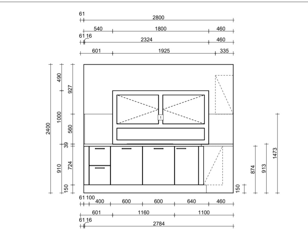

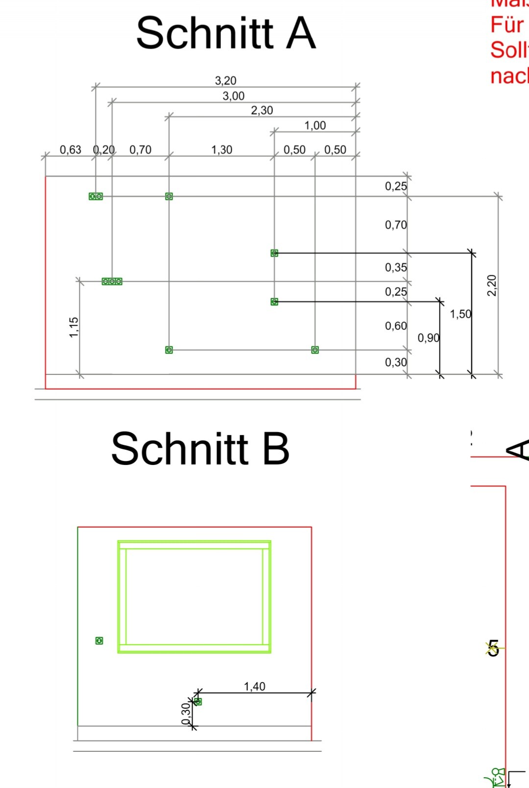

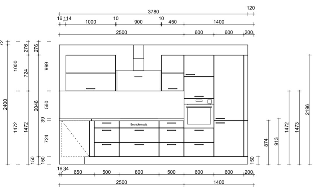

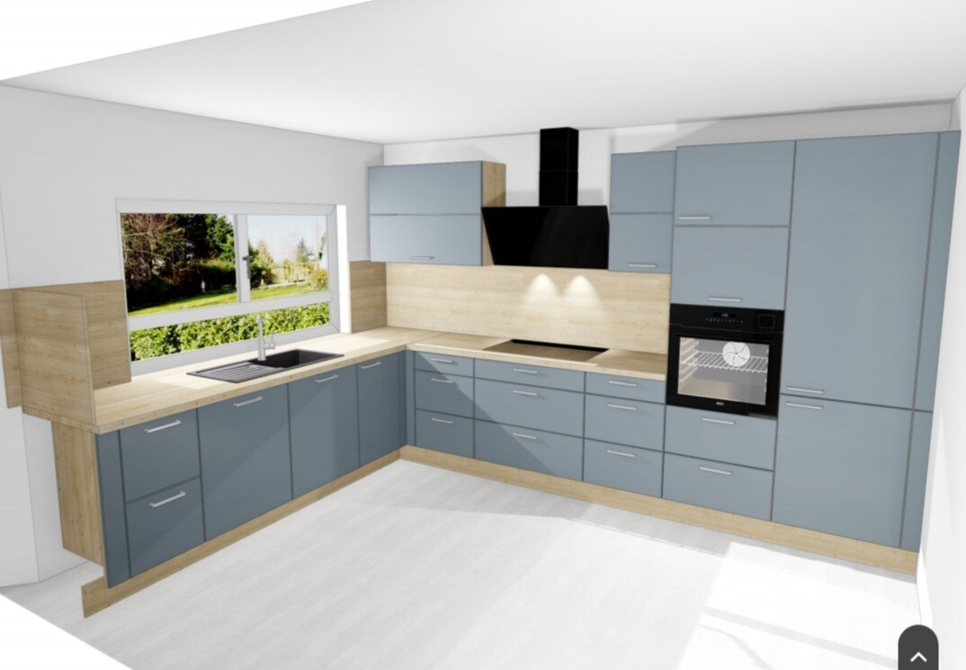

My next question: I had a kitchen planned but have not purchased it yet. The dishwasher is located to the left of the sink, basically against the wall in front of the window, the second cabinet from the left.
Since I don’t have an installation plan, the electrician kindly created one based on that, and I’m supposed to review and approve it. Does anyone have experience with this? The first two pictures are from the electrician showing where the sockets will be, and the last three pictures are the kitchen plan. I would be really grateful if you could take a look and point out anything you notice… Yes, unfortunately, the order in which we build and work here is a bit chaotic, but I believe that somehow we will manage it.
