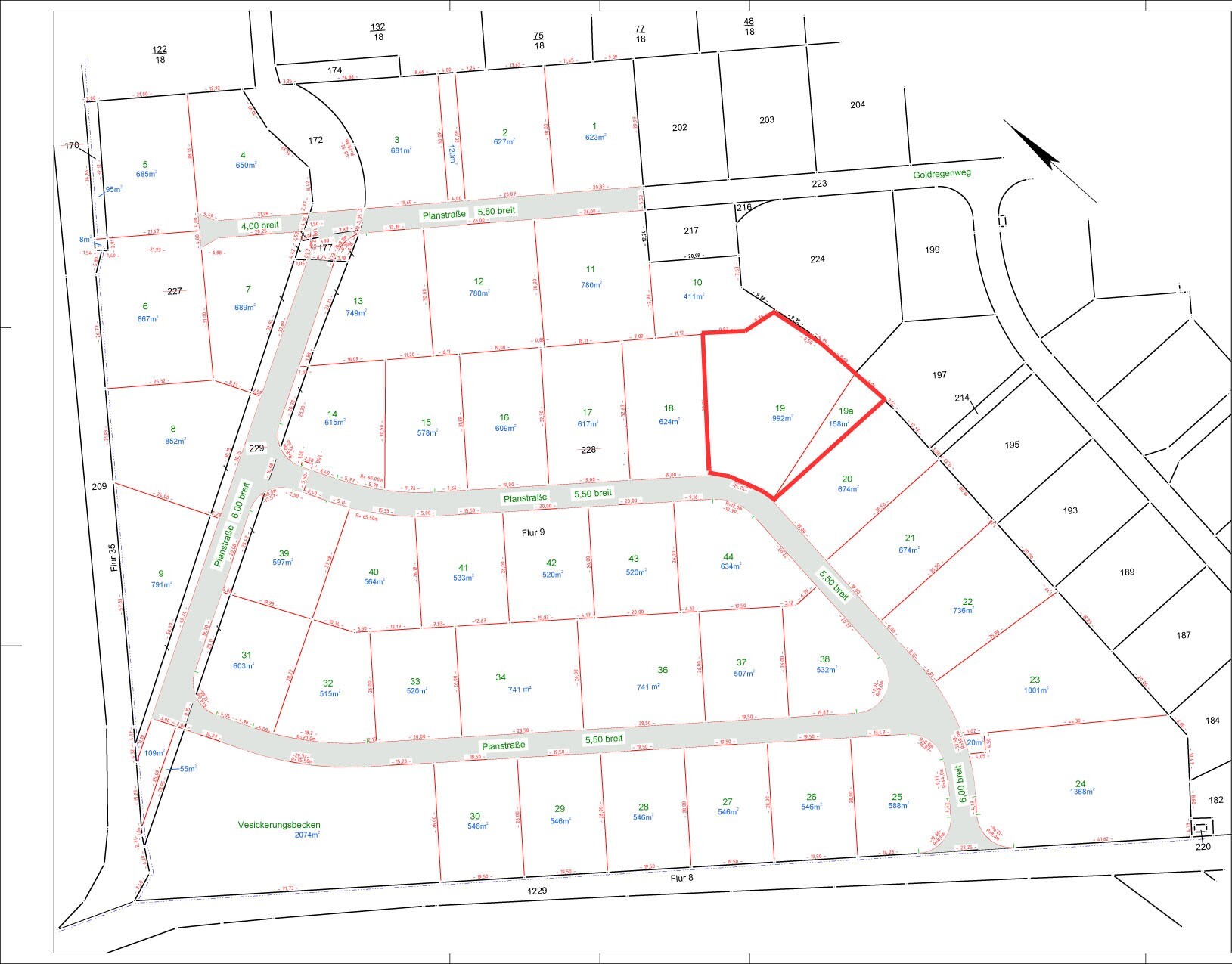

Hello, we are currently planning the construction of our future home. We have a fairly clear idea of how the house should look and have already presented our plans to four construction companies. They all basically accepted our ideas without much criticism, gave a few minor suggestions here and there, and provided initial cost estimates. Since the companies all took our ideas quite quietly, we assume we are on the right track 🙂
We would like to hear your opinions on the floor plan before we hand over the fine-tuned plans to the construction companies for detailed pricing.
Plot size: 1,150 sqm (12,379 sq ft) - Parcels 19 + 19a - (plot contractually reserved, buildability likely from Jan 22)

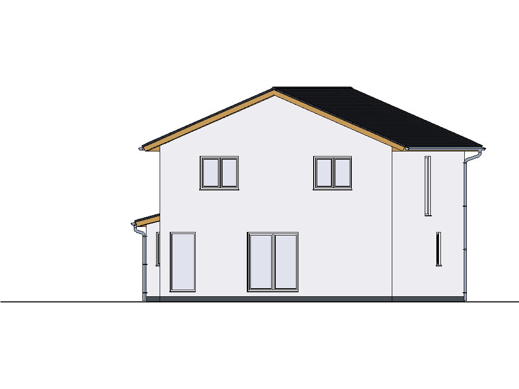

Architectural style, roof style, building type: urban villa with flat gable roof (KfW55 standard)

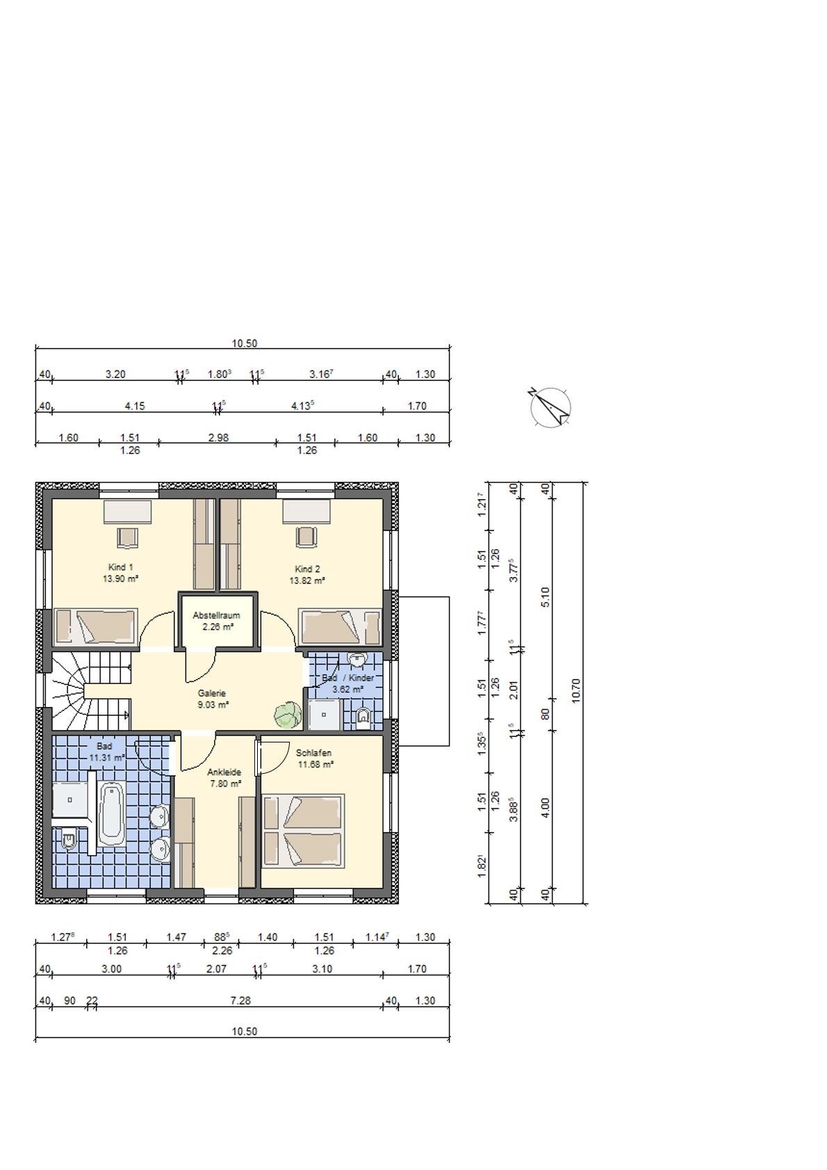

Upper floor: 2 children’s rooms, master bedroom, dressing room, children’s bathroom, master bathroom

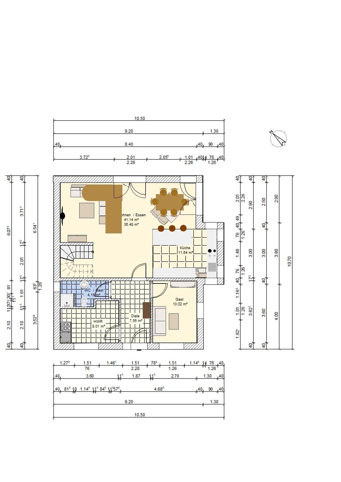

1. The living room-kitchen area was taken 1:1 from a model home where we liked the feeling of space very much.
2. Bedroom and master bathroom are accessed via the dressing room.
3. The master bathroom is also taken almost exactly from a model home.
What do you not like? Why?: We wonder if the hallway is sufficient. It will definitely not be spacious, just functional, but is there enough space?

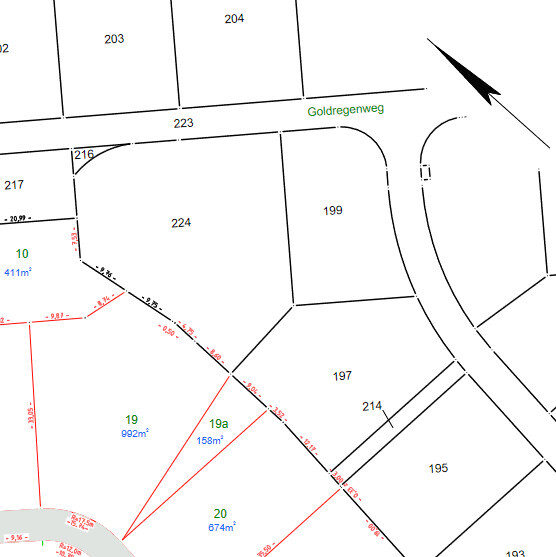

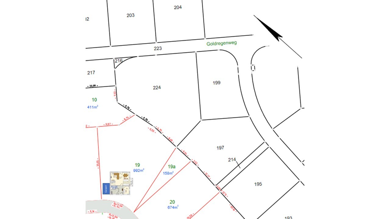

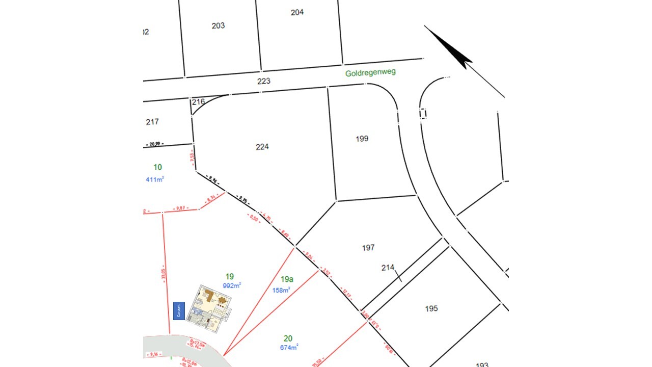

- Positioning/orientation on the plot: we are still unsure about what looks good or unusual and how the room orientation toward cardinal directions makes sense. We also have photovoltaic with a corresponding south-facing roof in mind. (I attached 2 orientation ideas)
- Does an additional window near the couch in the living room make sense?
- Can the stairwell/gallery window be smaller, will the light be sufficient?
- What are your general thoughts on the floor plan?
Due to my limited "Sweet Home 3D" skills, the ground floor plan looks a bit odd. I superimposed an earlier floor plan as a reference under the new one. Please only pay attention to the stronger outlines for the sofa and dining table. Sorry about that, but it’s the best I could do.

In the site plan, I can almost see nothing of the access road.

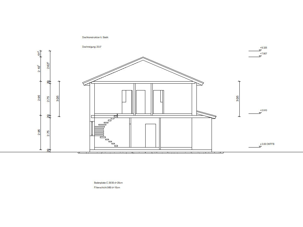

Do the drawings truthfully represent the flatness of the site?

Dining doesn’t work and there’s wasted space in front of the stairs.
Why are there two different size figures? With/without stairs? Where are the 52 m² (560 sq ft)?
Upstairs: Remove the storage room so the hallway leading to the children’s rooms can be eliminated.
Swap the bathtub with the sink and move it into the corner. I would rather remove the kids’ bathroom, since storage space will be desperately needed without a basement.
Kids’ bathrooms are a “nice to have” if you have plenty of space. Three showers for currently three, and later four people, is not practical in 150 m² (1,615 sq ft) without a basement.

I wouldn’t worry too much about the orientation, whether one way or the other. A few degrees here or there don’t really make a difference.

In the foyer, the wardrobe and possibly a dresser or sideboard will face each other and thus narrow the hallway.
The same applies to the shower bathroom: you basically press your private parts into the corner when using the sink, or you could rest your head on the sink while using the toilet. Haha...

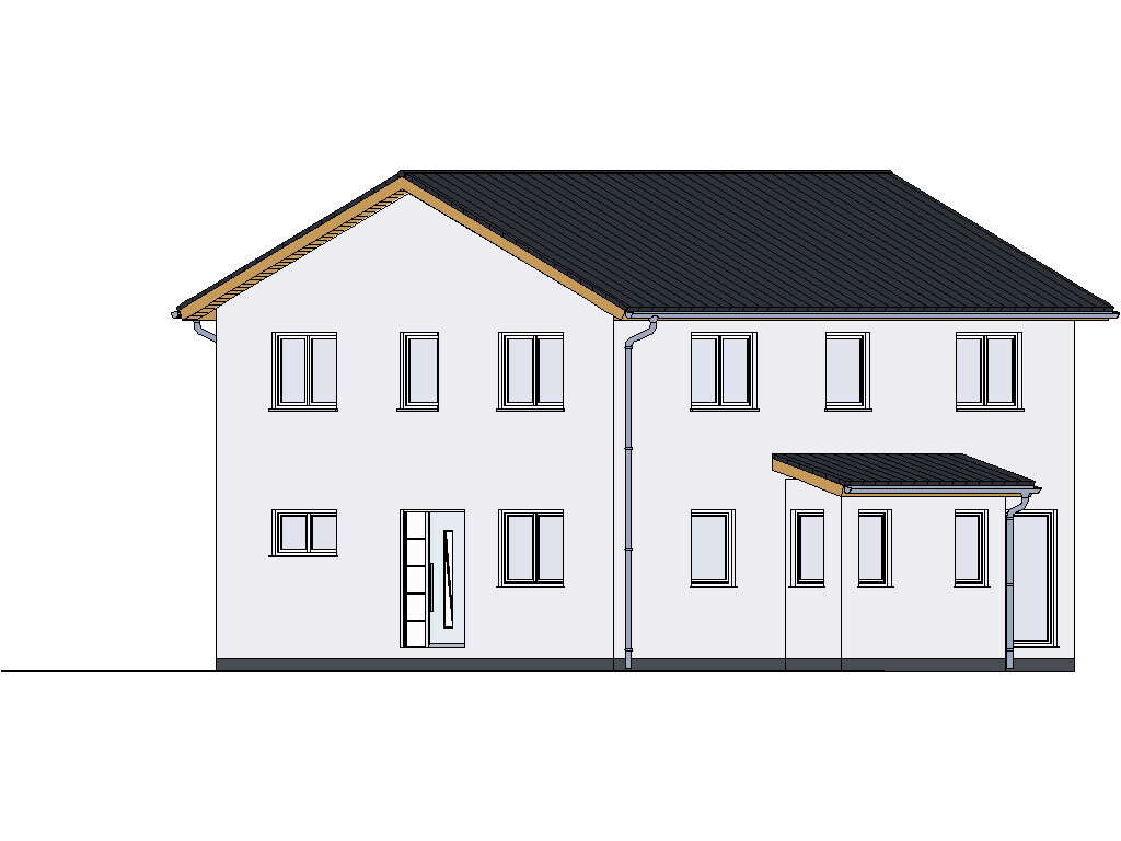

The kitchen bay window looks randomly placed from the outside. Inside, it turns out to be too tight for a kitchen, and the bay window had to be added to create enough space.
Still, a) the kitchen, b) the dining area, and c) the living area are arranged quite tightly and appear “small.”
The staircase
Concrete may be useful in the foyer, but it does nothing for coziness nor for the storage space underneath. Rather, it looks somewhat lost there because the central area is quite free and really not usable for any of the three areas.
Since you plan for two children, when the family gets older, there will be virtually no privacy in the evenings, with guests, or when the teenager comes home with friends and scares the parents on the sofa.
The work/study room upstairs takes up more space than it offers.
I find the kids’ bathroom acceptable, but the master bathroom is too narrow at three meters (about 10 feet) to furnish it properly.
The walk-in closet, with three doors, is more like a hallway. With just one wardrobe about 2.5 meters (8 feet) wide and some dressers, it’s not really a spacious wonder. In a standard bedroom of an apartment, you could fit more closet space.

And I’ve realized that there is quite a bit of wasted space in front of the stairs, while the hallway is too small.
The dining area between the kitchen island and the wall is 2.90 m (9.5 feet) wide – is that really too little for a dining area?
On the other side of the kitchen island, there is about 1.40 m (4.6 feet) of space. It’s not generous, but is that also considered too small? (We currently live with a micro kitchen, so maybe we simply lack a reference / feel for what’s normal.)

Thanks! The plot size matches what we wanted, and with the interesting shape, there are definitely exciting design possibilities.

I attached the parceling plan for the entire development, so you can also see the new street.
The development is newly serviced, and apparently both the new area and all adjacent plots are level. I haven’t asked the land seller explicitly yet, but I intend to do so.

One reason I’m asking for help here: I have no knowledge about room orientation regarding cardinal directions.
But I think you missed the north arrow at the top right of the plans? The utility room is in the northeast, not southwest. I attached updated plans with the corrected north arrow for position 1.

Kitchen and dining area at 5.50 m (18 feet) is tight, and the kids’ bathroom is also too small if I’m reading the width of 1.70 m (5.5 feet) correctly. Or you’ll end up with a tiny bathroom that won’t be comfortable to use when the kids grow up. The same goes for the master bathroom, where the distance between the sink and bathtub is quite narrow.

On the site plan, Ialmostdon’t see the access road.
Do the drawings truthfully represent the site’s flatness?

...Almost all rooms are oriented incorrectly in terms of sunlight/daylight, comfort, and energy capture in living spaces.
Instead, utility rooms like the bathroom and pantry/laundry are in the best southwest position, the kids’ rooms in the dark north, and the master area overheats at night in the south.

The shower bathroom: when using the sink, you’re basically pressing the toilet with your knees, or you can lean your head on the sink while using the toilet. Haha...
The kitchen bay window looks arbitrarily placed from outside, but inside it’s clear it was added for extra kitchen space.
Still, kitchen, dining, and living areas are quite tight and small.
The stairs made of concrete might be useful in the hallway, but they don’t contribute to coziness, nor does the storage underneath. It looks a bit lost there because that central area is pretty open and not really usable for any of the three spaces.
Since you plan for two children, once the family is older, there will be no privacy in the evenings, with visitors, or when the teenager arrives home with friends and startles the parents on the sofa.
The storage room upstairs takes more space than it gives.
Kids’ bathroom is okay in my view. The master bathroom is too narrow at three meters (10 feet) to furnish as shown.
The walk-in closet with three doors is more of a corridor and not really a space miracle compared to a standard apartment bedroom closet with 2.50 m (8.2 feet) wardrobe and dressers.

I would say the bay window is a matter of taste; we quite like it. It probably originated from a functional need but prevents the usual "boxy villa look."
