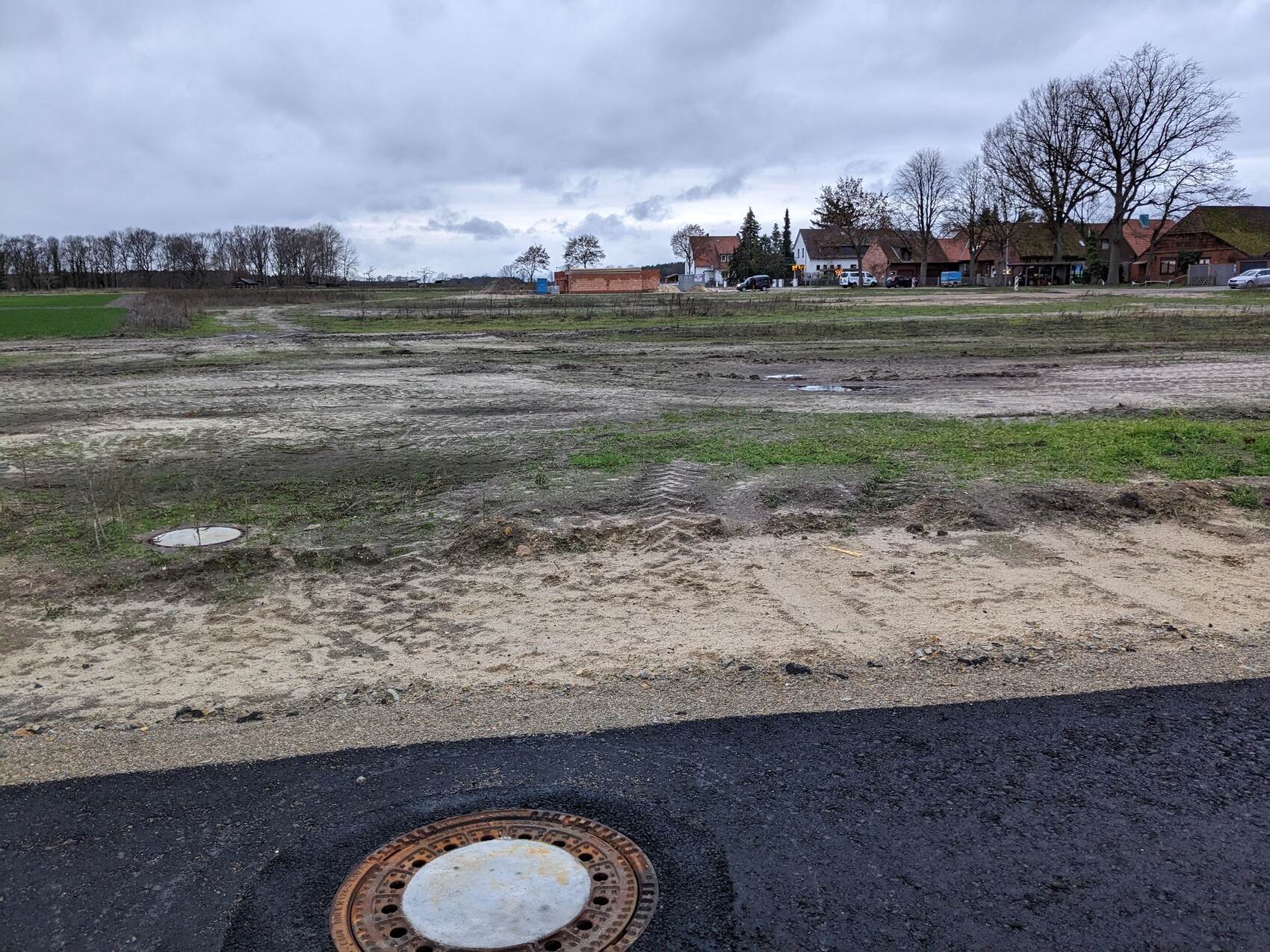

Regarding the photo: I am standing at the intersection shown on the development plan, looking towards the plot. By our estimate, the drain cover in the sand should be at the front left of our property.
K a t j a schrieb:
I don’t fully understand the general concerns regarding the knee wall yet. The eaves height is 4m (13 feet). That means about 1m (3 feet) of knee wall—in small houses like this, usually even more depending on ceiling height. The marked 40cm (16 inches) or whatever it was doesn’t seem necessary, right?
There seems to be enough difference overall, but a good portion of it is already “used up” just to get from the street to the house. For the timber house, the rain-protected sole plate height is a critical aspect. By the time we actually reach the usual reference height, the top of the finished ground floor slab (OKFB), the “climber on the hill” will already have half a dozen sweat drops on their forehead. The initially mentioned worst case of a 40 cm (16 inches) knee wall will probably be exceeded but unfortunately only marginally.
K a t j a schrieb:
I haven’t read anywhere that the street is actually higher or lower than the finished floor level. What makes you conclude that?
I don’t conclude that at all. The crucial point is that the street (not the ground floor slab) is the significant reference here. If the street were higher—we’d theoretically gain some height—but this would do little, especially for timber construction where the sole plate with its underside (always at least at the top of the ground slab = top of the finished ground floor level, OKRFB) should stand at least 15 cm (6 inches) above the finished terrain (GOK). The choice here is only between a mound and a moat. The top of the gutter cover is basically the "backwater level" in terms of rainwater; with masonry construction, the whole situation improves by only about 15 cm (6 inches) anyway.
