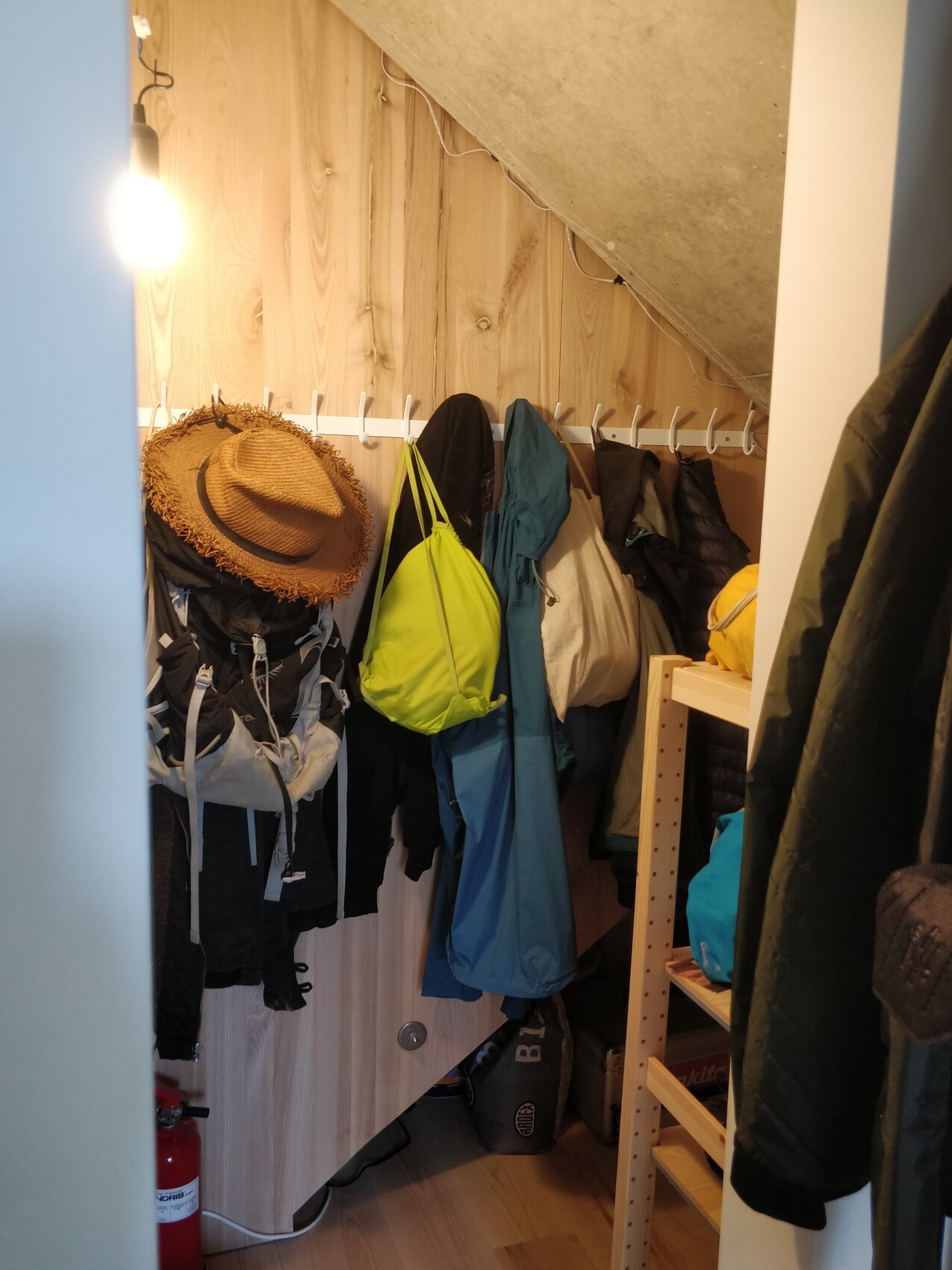

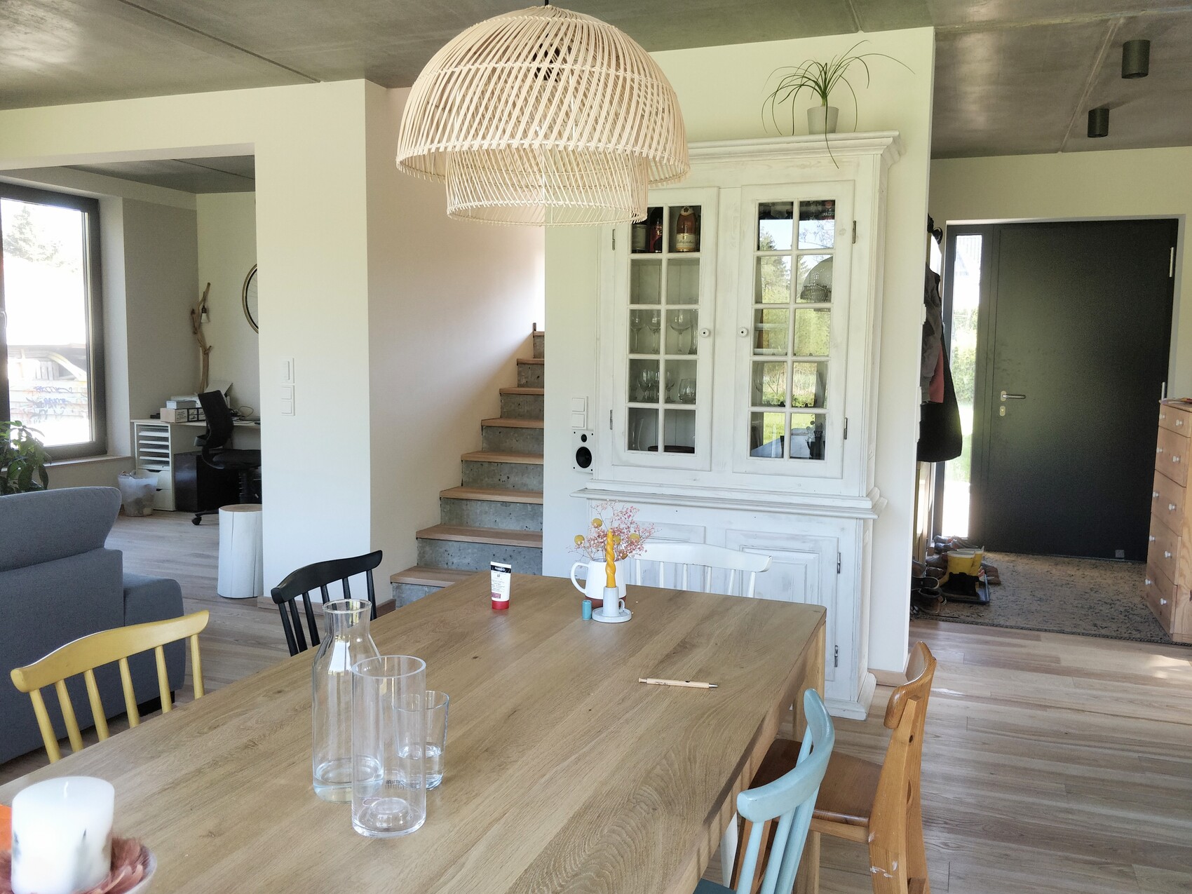

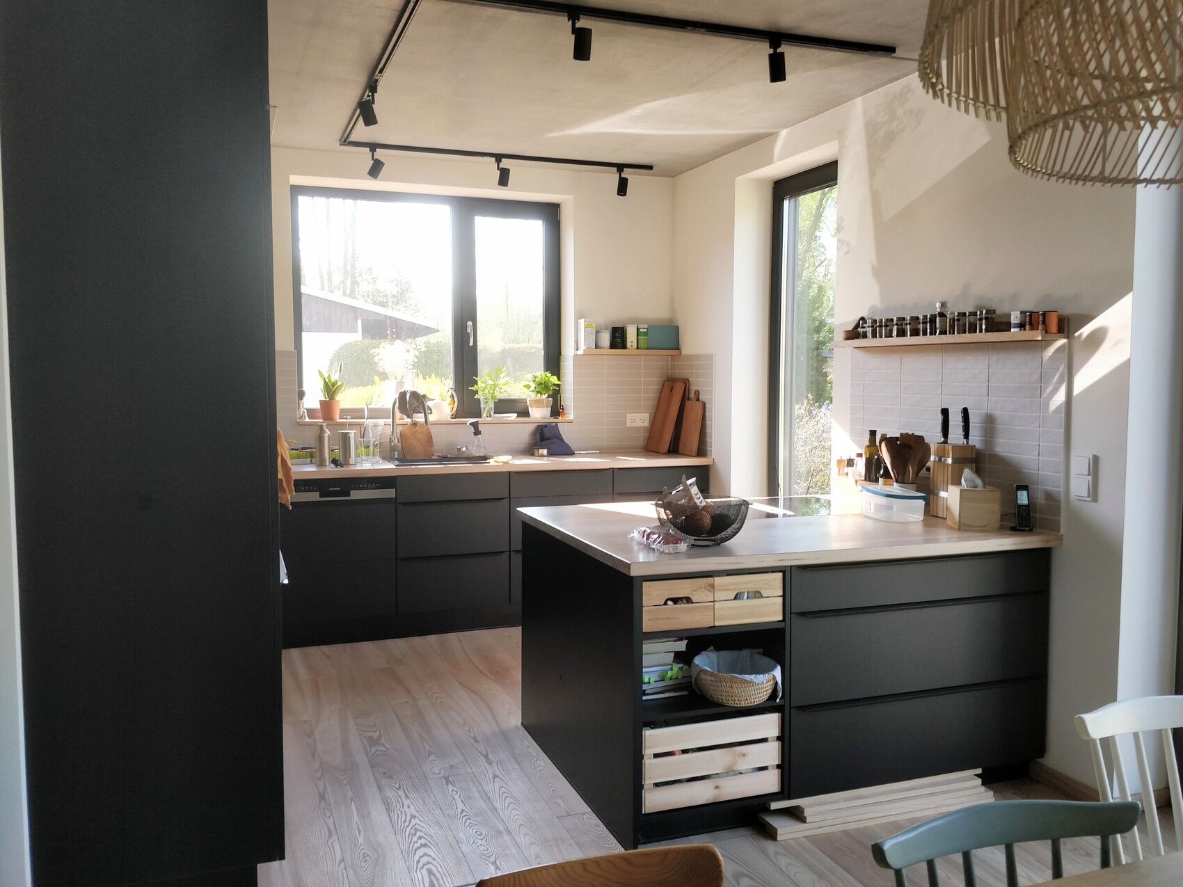

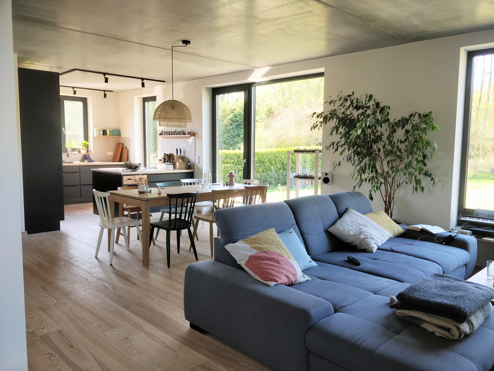

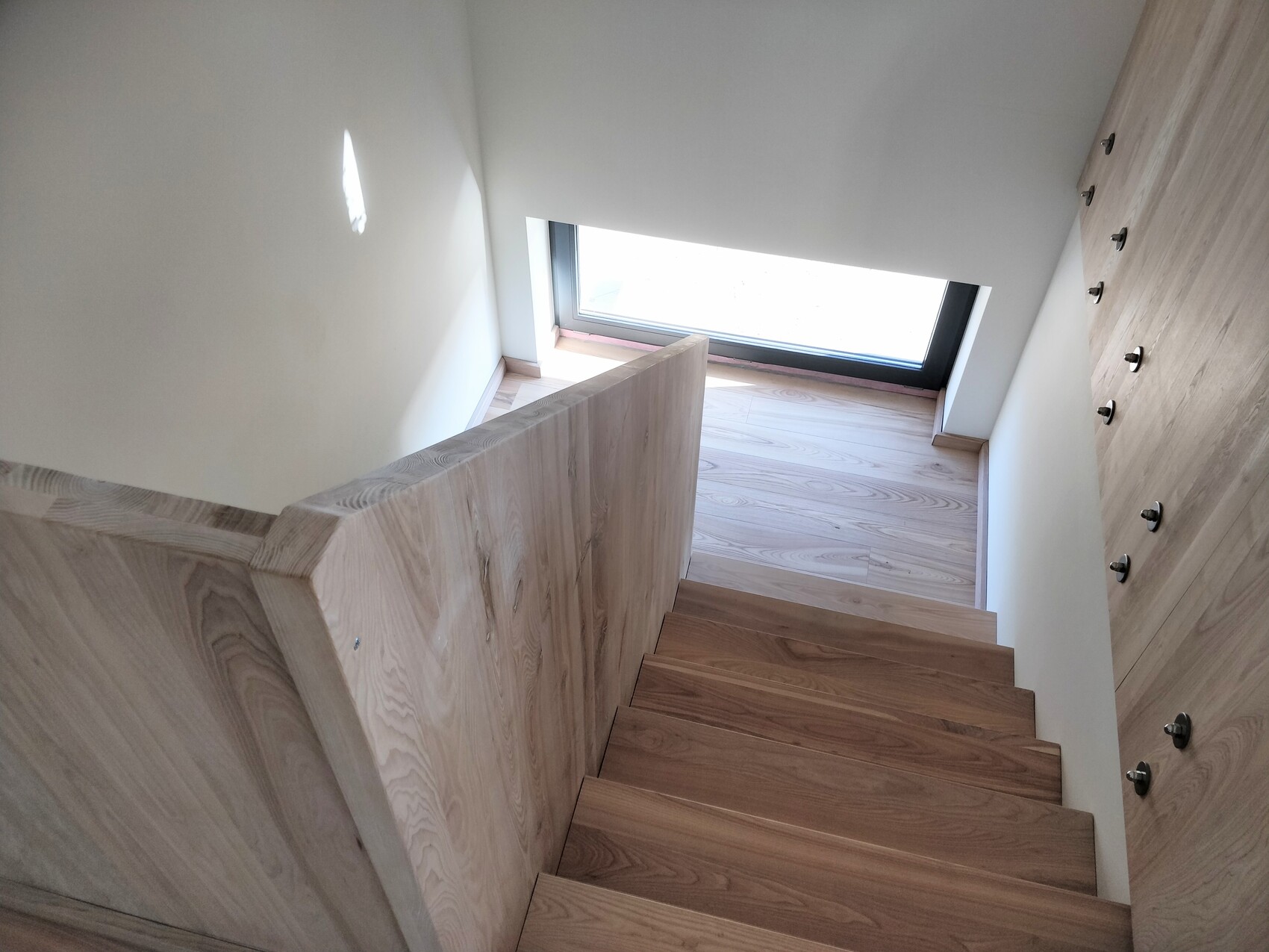

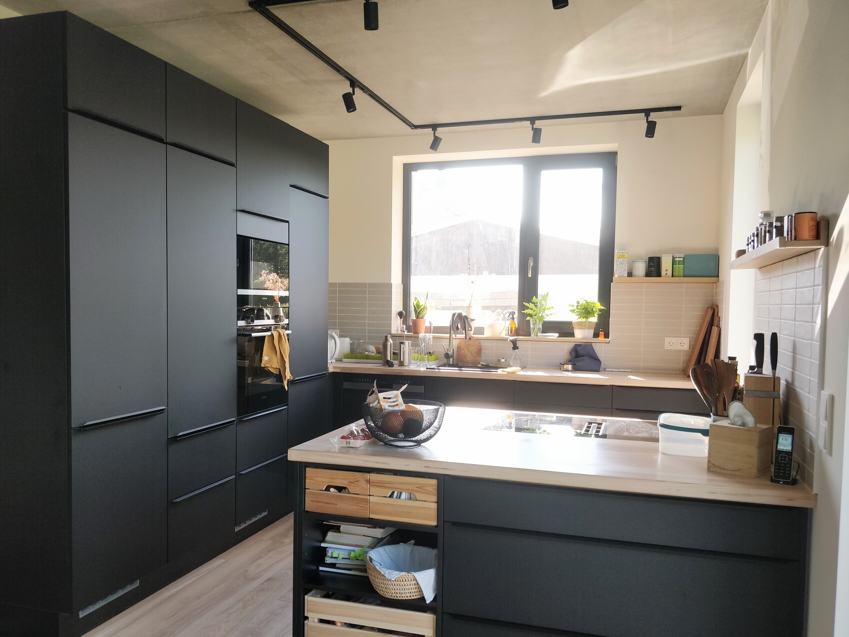

Hello, oh my, it’s actually been half a year since we moved in. I wanted to take and share photos much earlier, but as usual... other things had priority. For example, in winter we had to remove all the window sills again because we had forgotten the moisture barrier behind them.
But now, at least some impressions from our furnished and lived-in house. There are still some cluttered corners, but those will probably stay like that for a while – maybe never fully disappear. However, we really feel comfortable here.

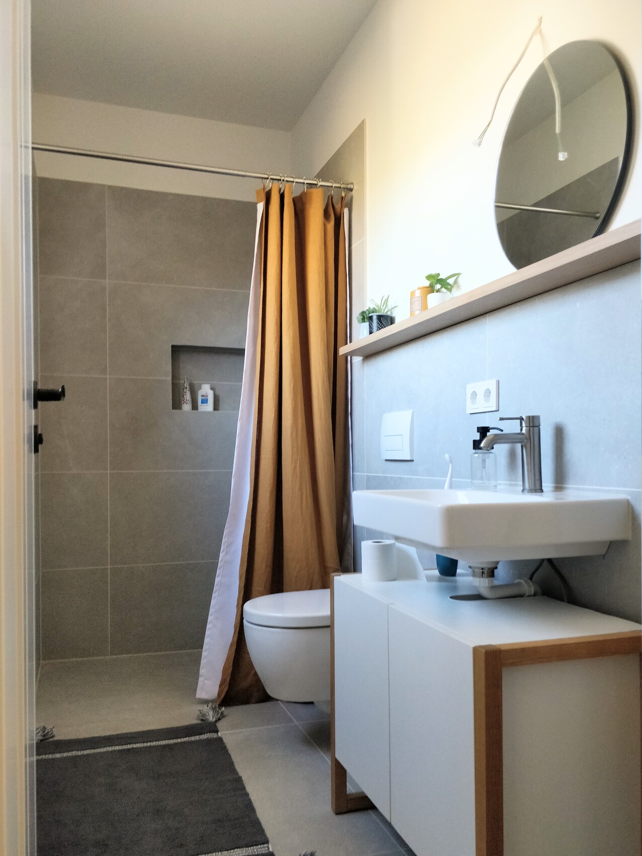

How did you manage with your budget?
In some areas, it’s clear that cost-conscious decisions were made. This is not meant negatively. It often allows more room for personalization.
Take the shower curtain alone—the color and texture make me curious to feel it. It doesn’t seem like a typical plastic item.
You can tell in some places that cost-saving decisions were made. That’s not meant negatively. It often leaves more room for individuality.
Just the shower curtain alone. The color, and I’m tempted to feel its texture. It doesn’t look like a plastic piece. Overall, when we moved in, the cost was about €224,000 (without pile foundation and kitchen, including the concrete slab and external shading). The budget was €230,000, so it actually worked out very well. I should mention: this really only covers the house itself, excluding additional costs like land development, surveying, or landscaping. That’s how I had stated it when I created the thread. Additional costs for things like land development, pile foundation, and the kitchen add another €100,000 on top. Whatever is left now will be invested in the surroundings.
So, we didn’t quite have the budget to move into a house on a perfectly designed plot with a blooming garden 😉. Garden landscaping will happen gradually. We recently commissioned a covered entrance and a porch. The terrace will be built later this year as a DIY project, and the driveway paving will also be done later this year. However, paving is incredibly expensive, so that probably won’t happen. We’re considering a gravel or crushed stone driveway cover and will see how that works out.
The shower curtain is nice, isn’t it? 🙂 It’s made of linen with a waterproof liner and was quite expensive for a shower curtain. But still cheaper than a glass screen.
Although I have to confess, since moving in six months ago, only ONCE have my sister and her husband used the downstairs shower on New Year’s Eve. Otherwise, it’s been completely unused by us so far. This reminds me of the saying that a second shower is often unnecessary... maybe it will come in handy when the kids go through puberty.
We are generally satisfied with the floor plan. A few small things become apparent in daily life that aren’t perfect, or that we initially underestimated:
- My sewing and home office space is upstairs in the walk-in closet with a sliding door separating it from the bedroom. The sliding door does not block much sound at all. Sewing while my partner is trying to sleep is almost impossible. Also, my home office is quite isolated, and when the delivery person comes, I have to rush through the ENTIRE house to open the gate. I’m already thinking about moving my desk and sewing area to the gallery sometime. There’s enough space there.

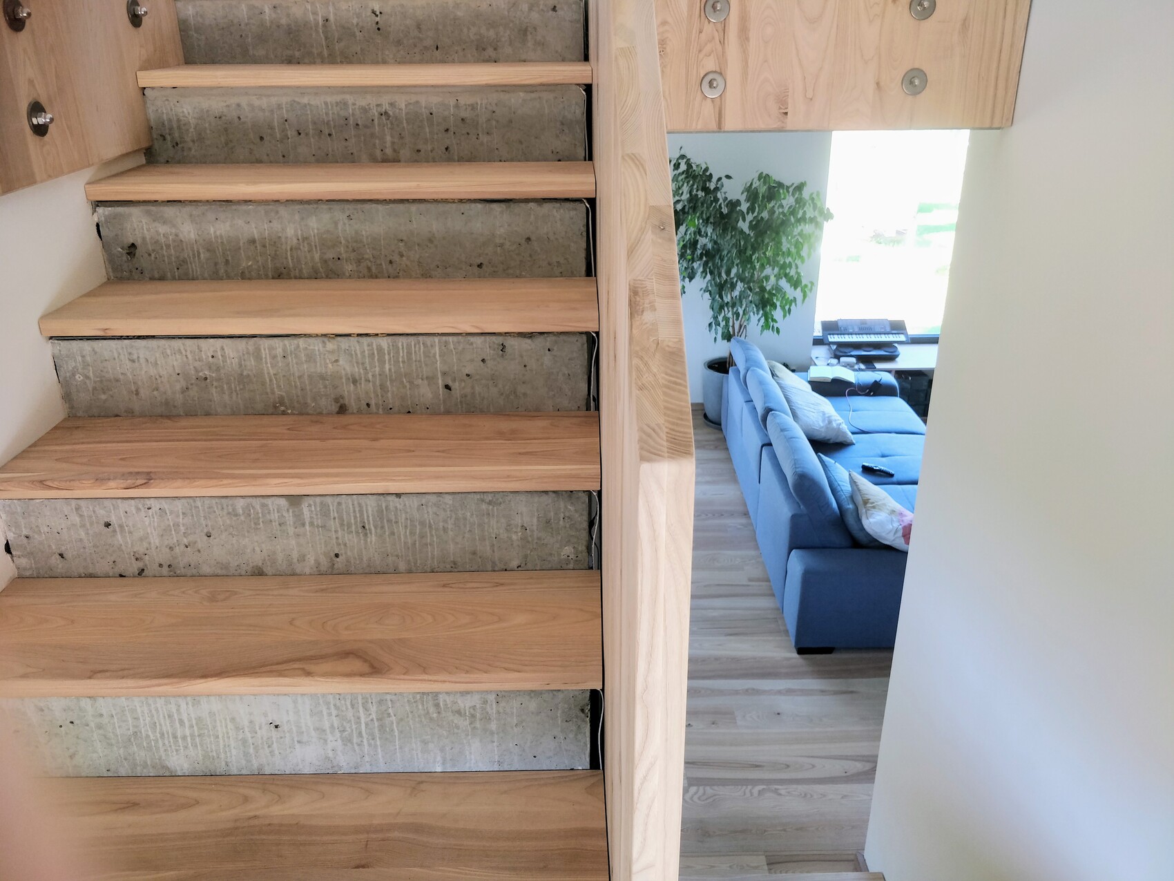

- We still really like the staircase in the living room in almost every situation. But when everyone wants to use the bathroom upstairs at the same time, the way to the downstairs bathroom is longer than if the staircase ended near the front door and thus close to the guest bathroom. Generally, I don’t like walking barefoot through the sometimes sandy entrance area to the guest bathroom in the mornings. But having a bathroom right next to the living room/kitchen isn’t ideal either. I don’t know how that could have been optimized. Hopefully the hallway won’t be so sandy once our entrance porch is finished.
- When the kids are home in the afternoon hanging out or roughhousing on the sofa, it can be hard for my partner to concentrate while working in the home office. We could still put up a wall and a door between the living and work areas. But then we wouldn’t be able to hang our hammock anymore 😉. And between hammock and peace for working, the hammock will probably win 😉.
Well, in the end, you always have to make compromises, set priorities for your own wishes, and cannot fulfill everything. This is especially true when more people live together. But fundamentally, we feel very comfortable, and there’s no major flaw that makes us regret anything we would have done completely differently afterwards.
