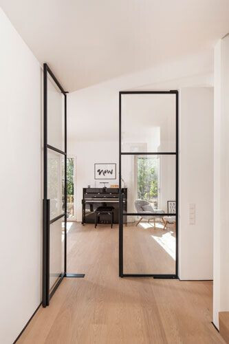

The partition wall with the fireplace is planned to be longer but remain open toward the exterior wall since the living room is somewhat smaller, and this could make the space feel more open. The entire wall will shift slightly toward the exterior wall so that the fireplace is positioned at the lower end.
My wife envisions a large glass door here, with a fixed part and the door opening to the left. Similar to the door shown here:

Regarding the partition wall and door around the hallway/dining/stair area, I would completely omit it at the staircase start. Unlike @pagoni2020, I see the floor plan as narrower: the table across, the kitchen under 5 meters wide, and remove the offset between office and living room.
Regarding the partition wall and door in the hallway/dining/stair passage, I would omit it completely at the stair start.

Ruksson schrieb:
My wife envisions a large glass door here, with one part fixed and the door opening to the left. Something similar to this door: However, that doesn’t really correspond to your layout. You don’t have a clear sightline to a distant piece of furniture; instead, the fireplace is immediately there. Because of the fireplace, your design lacks openness in this area. Still, I think the door looks great 🙂
