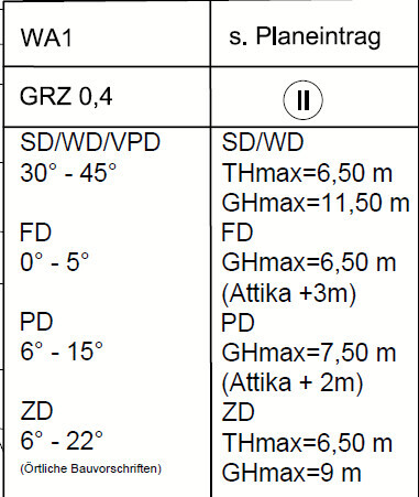

We have chosen a townhouse style and therefore decided on a hip roof or pyramid roof. The local regulations regarding the roof pitch are somewhat unusual.
To have a pyramid roof, the house must be square. In my opinion, a hip roof with a 30° pitch doesn’t look good. Therefore, a rectangular shape is not possible.
