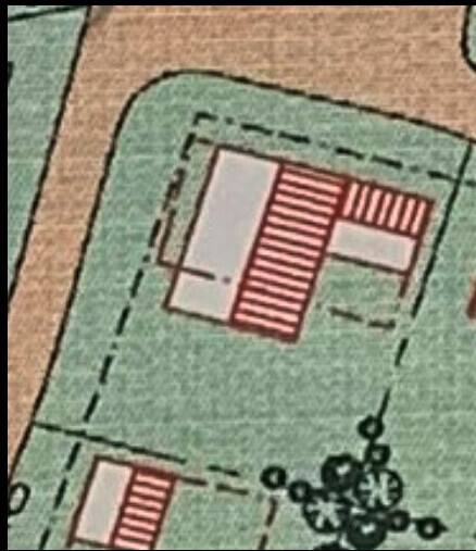

Site plan of a property with building footprints, pathways, and trees
If you take a look, the house is somewhat misaligned, and consequently so is the property. However, this does not significantly affect the overall planning or this thread.
Hanger1 schrieb:
5 m from the north and west
The 5 meters from the north and west is not quite accurate; it seems to be closer to 3 meters on the north side, while the 5 meters on the west refers to the height of a potential house. Then there is 1 meter on the east side for the garage.

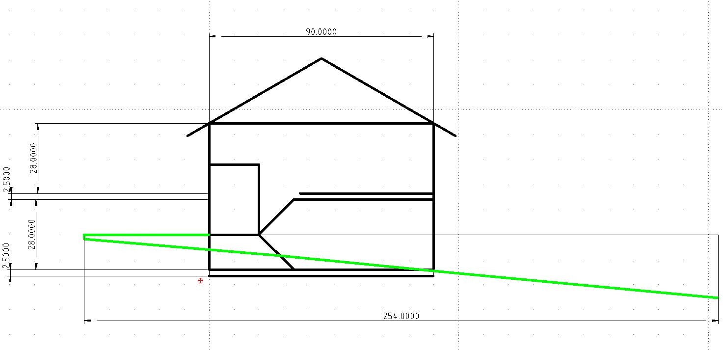

We did some research on possible solutions and came up with the idea of a sort of split-level layout. The entrance from the north side is close to street level, and the upper floor (sleeping area) and basement (living space) would be reached via a half flight of stairs.
What do you think of this? I sketched an example just to illustrate the idea better. The entrance area and stairs are obviously not final yet.
Technical drawing of a house with a gable roof, interior lines, and a green diagonal line.
In the development plan, there is the following clause:
Plinth height:
The top edge of the unfinished floor slab on the ground floor of the lot, where the natural ground level is higher than the adjacent street, must not be more than 40cm (15.7 inches) above the natural ground level. The measurement is taken at the midpoint of the house on the valley side, parallel to the street.
In such cases, what is defined as the ground floor? The basement, the upper floor, or the entrance level?
