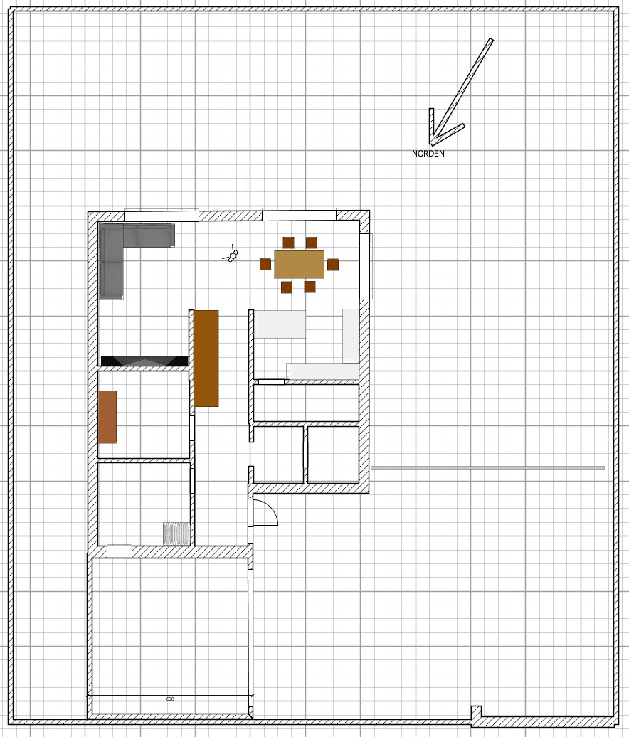

we will begin building a single-family house at the end of August and I would like to share our current house plan here.
Plot size 567 sqm (approximately 6,104 sq ft)
Slope no
Floor area ratio (FAR) 0.4
Site coverage ratio 0.8
Building setback, building line, and boundary 2.5 m (8 feet) from the property border
Number of parking spaces 2
Number of storeys 2
Roof type pyramid roof
Architectural style urban villa
Orientation garden facing south
Style, roof type, building type urban villa
Basement, storeys 2 full floors without basement
Number of occupants, age 2 people, 26/27 years
Office: family use or home office? office possibly also as a guest room
Open kitchen, kitchen island yes
Number of dining seats
Fireplace no
Balcony, roof terrace garden terrace
Garage, carport detached double garage, prefabricated construction
Orientation living and dining rooms facing the garden
Planned by: initially in collaboration with the developer
What do you particularly like? Why? staircase in the living/dining area
What do you not like? Why? window layout, living room feels like an “extended” hallway due to sofa placement
Estimated price according to architect/planner: ~361,000 euros (excluding garage, additional construction costs)
If you have to give up, which features/finishes
- can you give up? not yet considered
- cannot do without: electric shutters, blinds in living/dining area and kitchen, staircase in living room, so-called T-solution in the bathroom
I would like to emphasize that these are still some of the first drawings. The furniture, kitchen, etc. have only been placed as placeholders for now.
It should also be mentioned that the main entrance can only be on this side, as we have a “small” driveway at the edge of the plot in front of the garage.
In short, what I am not completely satisfied with in the current plan:
- window distribution
- living room, because the sofa can only be placed this way due to the casement window
I am very grateful for any further tips or criticism!

Flottertoni8 Feb 2020 16:32Hello everyone, I’ve reconsidered the design and made the following adjustments to the house.
Changes:
- No passage between the house and garage
- Direct connection from the garage into the utility room (plant room)
- Terrace on both the south and west sides
The interior layout will likely still be changed. For now, my top priority is the overall floor plan.
The house remains 10.25 x 10.25 m (34 x 34 ft) in size.
The bay window on the north side will be slightly enlarged to include the entrance.
Do you have any ideas for the room layout?
It’s important to us to have a straight staircase starting from the living room → a solid concrete staircase with wooden treads (but with open space beneath the stairs, so it’s not a fully filled staircase).
We’re not yet happy with the fact that you can see straight through the house from the entrance.
Thanks to all of you!

Grantlhaua8 Feb 2020 21:34Silly question, but what is the purpose of the door from the utility room to the garage? You can already walk into the garage without getting your feet wet.
F
Flottertoni8 Feb 2020 22:00It was just marked like that and, as mentioned above, can still be changed.
So far, the focus here has only been on the positioning of the garage and the general layout of the interior.
