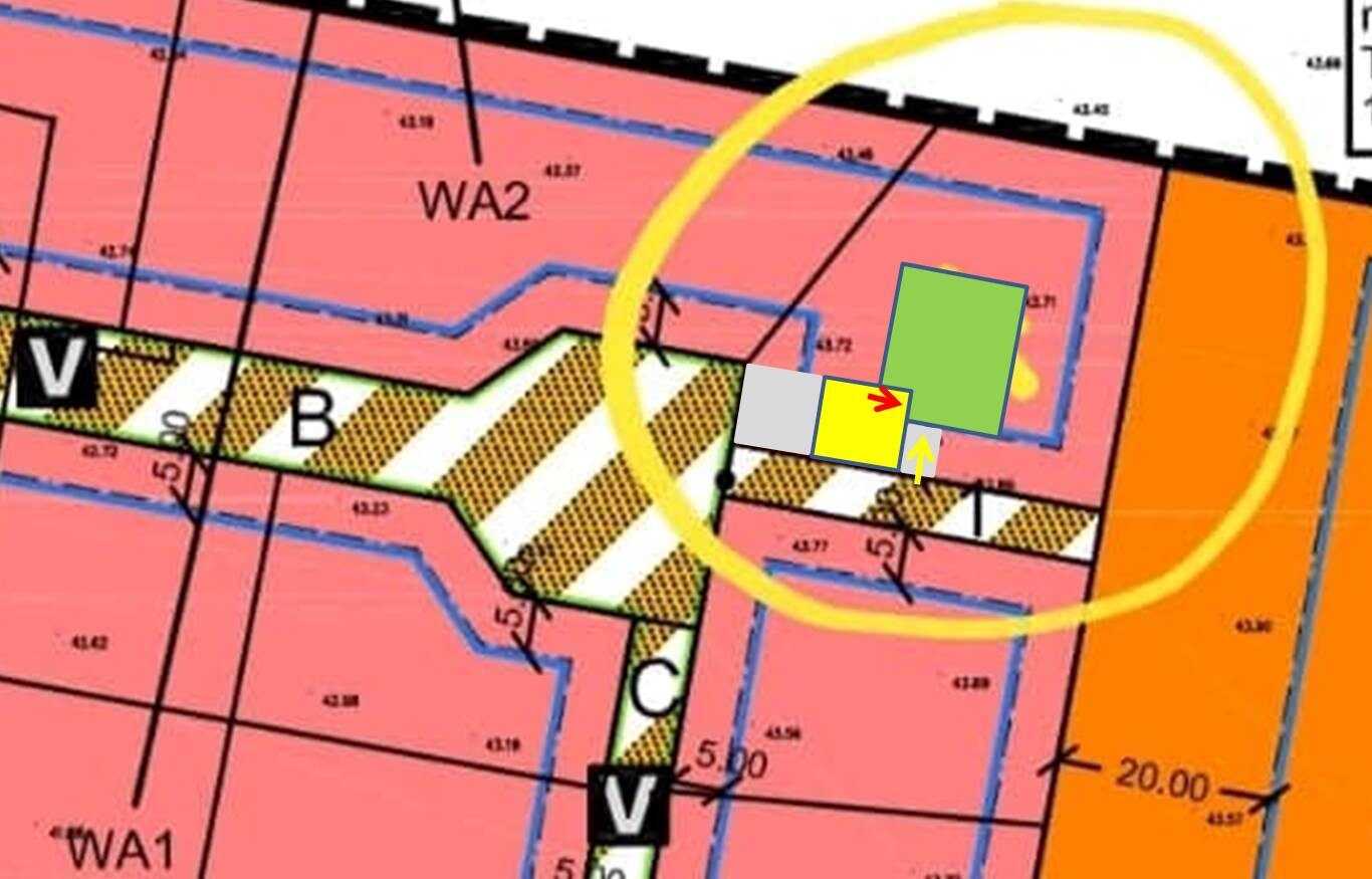

Is it actually allowed for the garage to be built outside the designated building area as a boundary structure?
One could possibly arrange the garage and house as shown in the sketch. The house would then have a slight L-shape, but there are workable floor plans that suit this design.
The entrance and access through the garage would then exit at the same point, requiring only minimal additional space.

@RomeoZwo Yes, your idea extended a little further. Place the house on the eastern building boundary to fully utilize the south/west sun.A driveway that is too long should be avoided.
Additionally, it is important to differentiate between maximizing sun exposure and the design of the garden or natural light inside the house.
I would probably also position the house along the eastern boundary.
Yes @RomeoZwo, that’s roughly how I have it in mind as well. Just as @desixtor and @ypg pointed out – shifting it all the way to the east boundary to make the most of the western sunlight and terrace. Whether this is allowed under building or planning regulations still needs to be checked… Garage and carport boundary construction is actually permitted in one part, since it’s adjacent to a public walkway. The question is, though, if that still applies when the dwelling and garage are considered a single structure.
The second issue, in my opinion, is that the entrance would have to be moved to the west, because from the street there is no visible entrance on the south side (the garage is in front). By the way, the walkway leads nowhere/into a field, as the assisted living unit has not yet been built.
That would mean the entrance is on the west side, directly next to the terrace???
@11ant, you seem to always stubbornly stick to your opinion and never accept others’ ideas, especially when it comes to garages attached to the house. And examples like baby monitors, ghosts, or mom’s voice are completely subjective and just really inappropriate.
