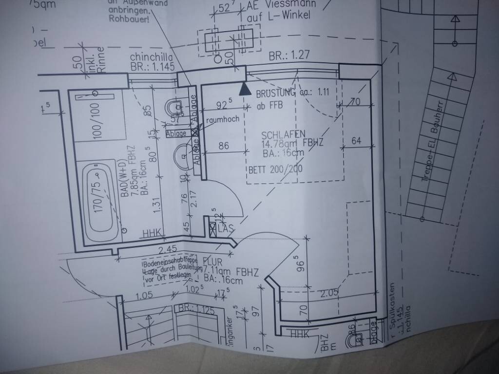

Here is the new bathroom floor plan. However, the bed will be arranged differently...
Unfortunately, there is now very little space for the washbasin, so we are considering removing the privacy screen to ensure that an 80cm (31.5 inches), or even a 100cm (39 inches) basin will fit in the bathroom. We’re not very happy about this, but we consider it a worthwhile compromise for having our own quiet bathroom.
How would you solve the issue of the washbasin/privacy screen/cramped toilet? The sanitary fixtures can no longer be moved...
Then have your husband carry the decorations and other stuff up and down all the time. I think having a proper staircase to the attic makes sense, especially if there are no other storage rooms. I can imagine you already have quite a bit of stuff.
It's great that you have your own private area with a separate bathroom. I would skip the privacy screen.
