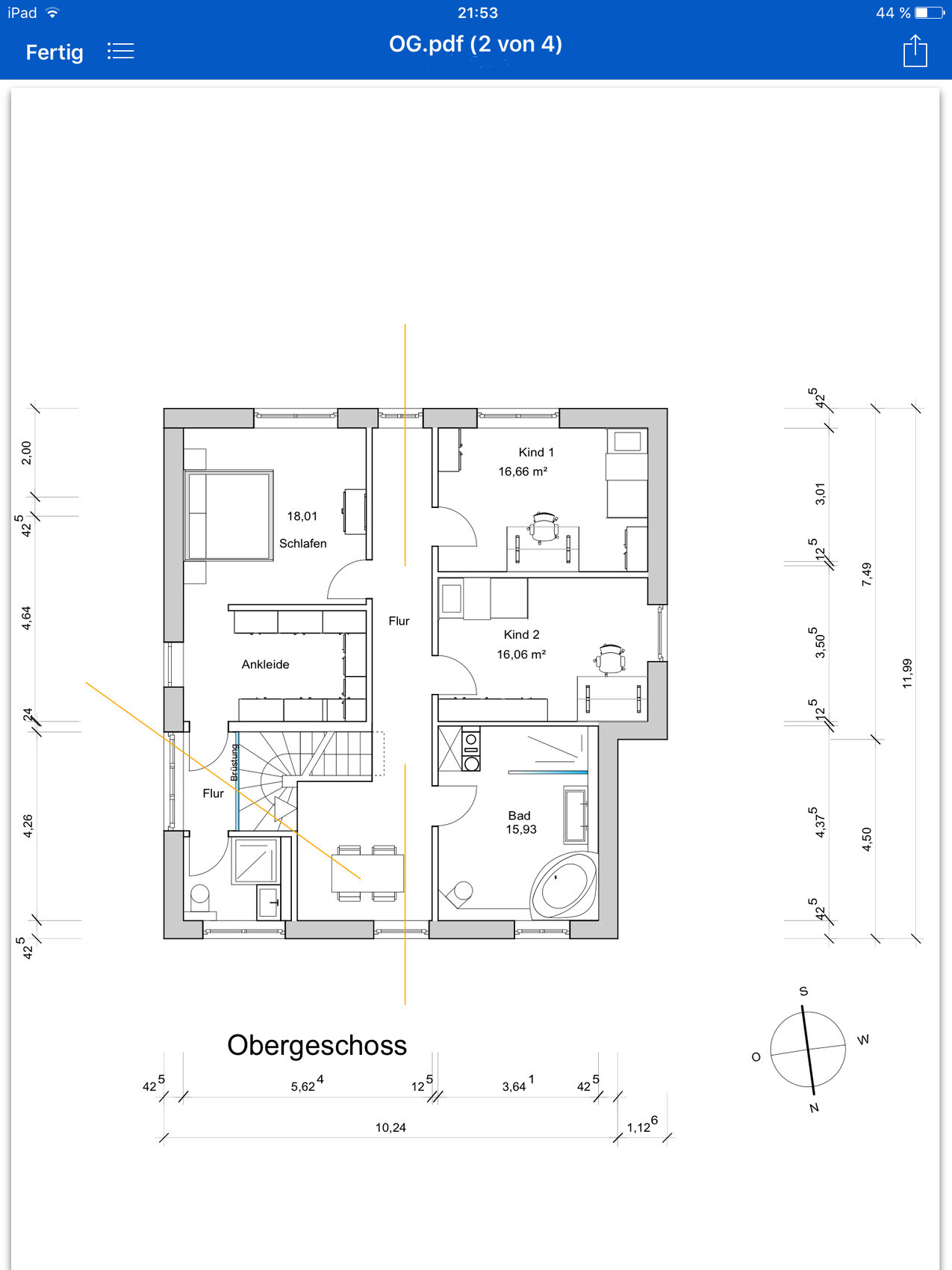

We have just received new drafts from our architect, which partially include your ideas. I would appreciate it if many of you could provide feedback.
A few brief notes:
- The small bathroom on the upper floor will become a storage room
- The walk-in closet will be slightly widened towards the bedroom
- Bathroom fixtures are not final
Additionally, a few questions:
- Would you suggest adding a horizontal window above the sink on the west side in the large bathroom?
- Is a wider window recommended for the second children's bedroom?
- Do you have any other ideas?
Looking forward to your feedback.
Grobi

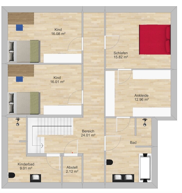

I'll start with the upper floor:
Your email address is visible.
I’m not quite sure about the purpose of the storage room—especially since the only access is through the master bedroom. Also, the very generous seating area by the stairs puzzles me. Such spaces always look nice, but are rarely used in practice. To me, it would be a waste of space, but if you like it, that’s fine.
The house size easily allows for 2 large children’s bedrooms, a bathroom for the children, and a master bedroom area. So why give that up?
Children’s rooms on the left side of the plan, master area on the right.
It’s often desired that the master bedroom faces east for the morning sun, but you don’t get that since there’s no window on that side.
So I assume you don’t have a preferred direction for the children’s bedrooms/sleeping rooms—especially considering that Child 2 is assigned a small window facing northwest.
Attached is a redraw of the upper floor with a different room layout (2 versions):
- Bathroom planning is completely disregarded here.
- A long corridor with windows on both sides could still remain if desired. I would probably cut the corridor short on the north side (bottom of the plan) and assign that area to the storage room. A 24 m² (258 sq ft) corridor alone on the upper floor is quite excessive.
- The children’s bathroom could be reduced to the niche “behind” the stairs, keeping the stair window. However, this means one would have to use a small ladder from the stairs to clean that ledge, as it would no longer be directly accessible.

matte1987 schrieb:
I don’t really understand the purpose of the storage room – especially since it can only be accessed through the master area – nor the very generous seating area by the staircase. Such spaces always look nice, but are rarely used. To me, it would be a waste of space, but if you like it, that’s okay.The lady of the house really likes this open area on the upper floor, so I don’t need to argue about wasted space. I do understand your point, of course. The storage room is intended to be somewhat enlarged (see your version 1) and should definitely be accessible from the hallway.
matte1987 schrieb:
The house is definitely large enough for 2 big kids’ rooms plus a kids’ bathroom and the master area. So why skip that?If we swap the dressing room and bedroom with the kids’ rooms, it no longer fits with the rear façade design. The hallway window (south side) is exactly aligned with a window element in the living room. A direct connection from the dressing room to the bathroom would be nice, but the second door limits the freedom to arrange furniture (also consider the chimney running through the bathroom). Having an additional bathroom certainly has its advantages, but we’re not completely convinced about it.
matte1987 schrieb:
It is often preferred that the master area faces east to catch the morning sun, but you have none of that since there is no window. So I assume you don’t have a preferred orientation for the kids’ rooms/bedrooms. Especially given that you place Child 2’s room with a small window facing northwest.We’re still considering whether to add a window on the east side in the bedroom. However, it would be located above the bed, which I find less ideal. The small window in the kid’s room will definitely be enlarged by one element.
