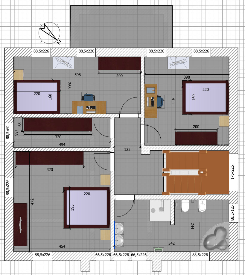

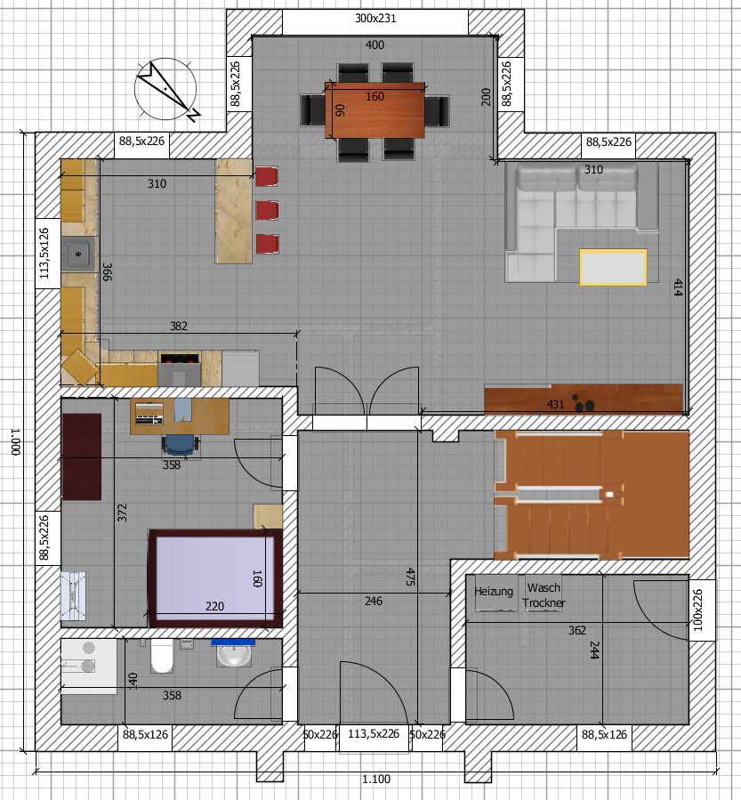

Good morning,
I’m reaching out again. We are soon entering the final planning phase. After parting ways 2 ½ months ago with our preferred builder just before signing the contract, we decided to take matters into our own hands. On one hand, to build the house more cost-effectively, and on the other, to tailor it more individually to our wishes without overpaying.
We have already requested and compared quotes for most trades. Some are still missing, for example interior doors, interior and exterior plastering, and stairs. But the shell construction, windows, heating, ventilation, plumbing, carpentry, electrical work, and roofing are already settled.
Soon we would like to submit the building permit application (sometimes called planning permission). Currently, we are finalizing the floor plan with our architect. Since you gave valuable advice a few months ago, I would like to ask for your input again now.
A few notes:
- We have already arranged for the “Sleeping” room on the upper floor to be slightly reduced in favor of the storage room and the children's room in the next plan update.
- The fireplace will be further detailed, and the double door to the living room will be shifted slightly further to the left to enlarge the wall for the living room cabinet.
- The staircase is drawn incorrectly; it should actually be a half-landing staircase.
Notes on the floor plan:
Ground floor:
- Living area: 88.72 sqm (approx. 955 sq ft)
- Usable area: 63.51 sqm (approx. 684 sq ft)
Upper floor:
- Living area: 78.4 sqm (approx. 844 sq ft)
Total:
- Living area: 167.12 sqm (approx. 1,799 sq ft)
I welcome any questions or feedback.
Thank you and best regards,
Michael

BeHaElJa schrieb:
Please furnish the rooms – without that, your show home has no foundation.I will transfer the architect’s exact measurements to my drawing and add our furniture to it. I’ll try to upload it later today.

What @BeHaElJa means is that the room proportions won’t create pleasant spaces. Overall, they are too long and too narrow.
I can’t judge this properly at the moment, but what I see doesn’t convince me either. Everything is large, but the functional aspects are lacking. Since I also don’t see the utility room you mentioned, which is urgently needed for technical equipment, storage, and laundry, I tend to consider the design more of a write-off than anything else.

I can't believe an architect drew this design; if only because the chimney flue is placed within the load-bearing wall of the staircase enclosure. Leaving aside the generic, run-of-the-mill planning.I didn’t want to say it, but I thought exactly the same... Unfortunately, Tapatalk has issues with displaying images properly, so I couldn’t see the details clearly, but the bland, cookie-cutter design is obvious and the chimney definitely caught my attention.
At the moment, everyone seems to be focusing solely on the costs... I have the quotes from the companies and have calculated everything in an Excel spreadsheet. You don’t actually know the exact figures or the terms under which I am getting what.

Which rooms do you consider too long and narrow? I can only see the storage room and the toilet as potential candidates.
Building expert, please explain the standard/typical plan in more detail. Because just saying that doesn’t provide much to go on...
I have roughly arranged the possible furniture layouts. I noticed that the bathroom window by the bathtub at the top does not have the specified clearance. This will need to be corrected.
Since we are temporarily keeping the old couch, the living room currently looks like this. Overall, there is a living room, dining room, and bedroom, along with the actual furniture that will be taken along.

Bauexperte27 Nov 2015 13:51Invi85 schrieb:
Bauexperte, please explain the standard planning in more detail. Because with that statement alone, it’s difficult to understand much...The rooms are arranged without any thoughtful concept; nothing more, nothing less.For example, the utility room – with its 8.5 sqm (92 sq ft) – will not be sufficient, as the planner has designed it as a walkthrough room; it cannot realistically serve as a proper utility room. Also, the drainage for the ground floor shower-toilet, kitchen, and the upper floor bathroom are arranged in opposite directions. I won’t even get into the extra costs and questionable benefits of a trapezoidal garage. Even the storage room upstairs won’t work because you forget that only rough dimensions have been planned so far; some interior plaster will still be applied. Then, a 60 cm (24 inch) circulation width is very tight if you need to carry something into the room or want to bend down. This space – if it were slightly wider and placed elsewhere – would be ideal for collecting and doing laundry, which would improve quality of life.
This draft is not even a rational arrangement of rooms; otherwise, it would at least reflect Bauhaus principles. The layout of the front rooms on the ground floor also fails to consider that a floor height increase is planned. The corridor to the shower-toilet will, once built, make you feel like you’re in a bunker. I also don’t see any space for a coatroom, despite the generous entrance area; you might end up leaving children’s equipment in the garage.
The users responding here have already offered many good suggestions. And… even if you’re frustrated, it’s best not to insist on sticking strictly to your desired budget. You can prove me wrong if, after you have all the final numbers, it turns out otherwise; I honestly would wish you the best of luck 😉
