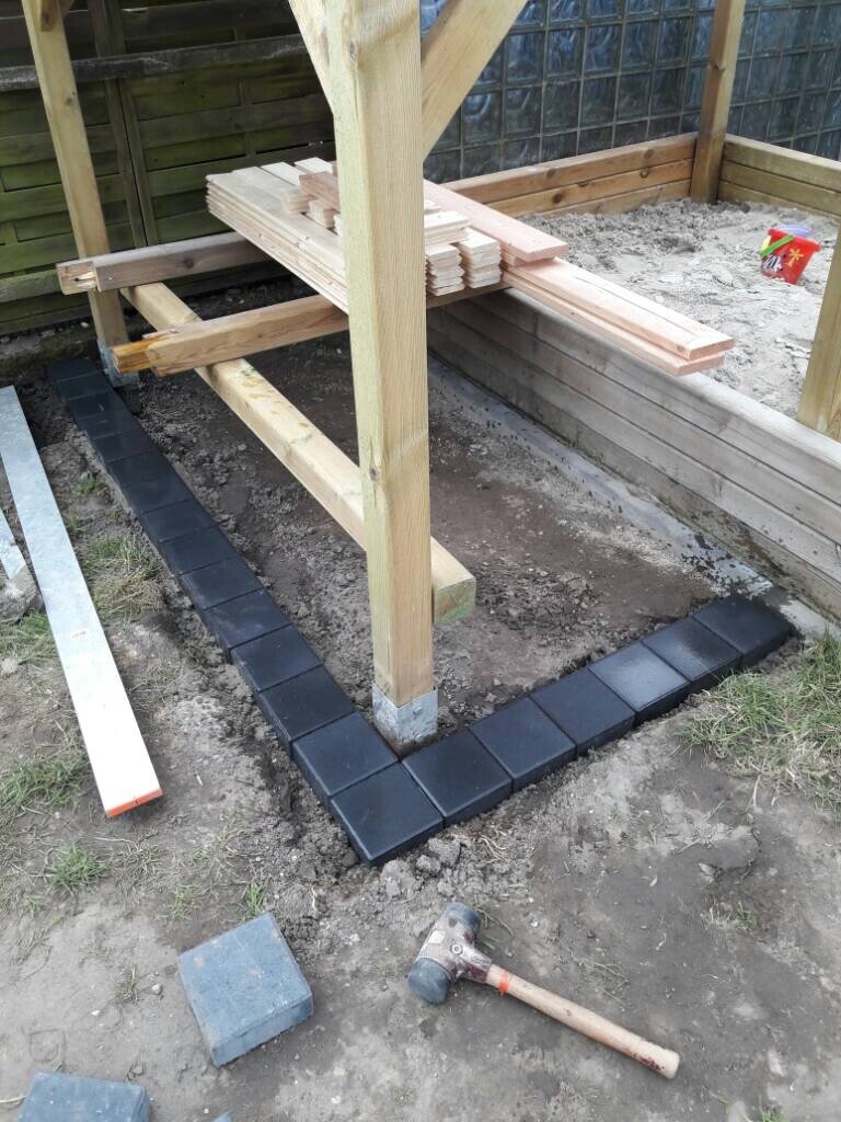

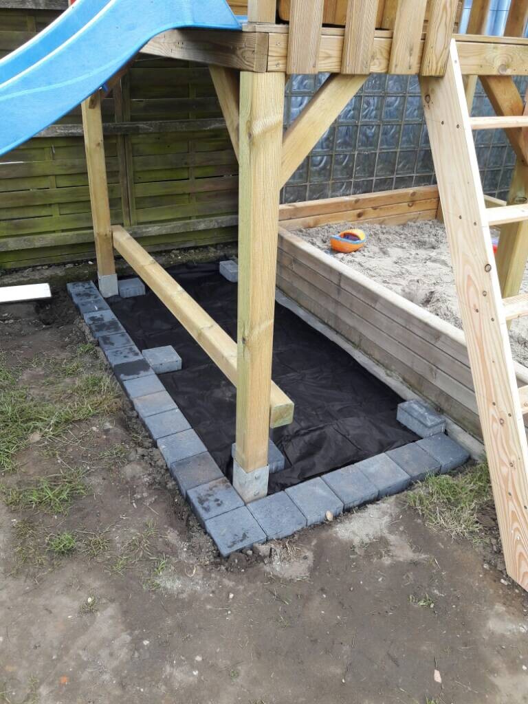

Secured? Hmm: On the right side of the sandbox, each post is fixed with 4 wood screws, 140x8 millimeters (5.5x0.3 inches), directly into the sandbox. So the entire sandbox is supported by the posts.
On the left, the two driven sleeves are each fastened with 2 carriage bolts, 110x10 millimeters (4.3x0.4 inches). We initially decided not to cast concrete.
And now for the weekend. In advance: We didn’t complete everything as planned. But what we did manage turned out well. We set the lawn edging stones in mortar, excavated a shallow trench, and laid down the weed control fabric. Gravel will be added there later.

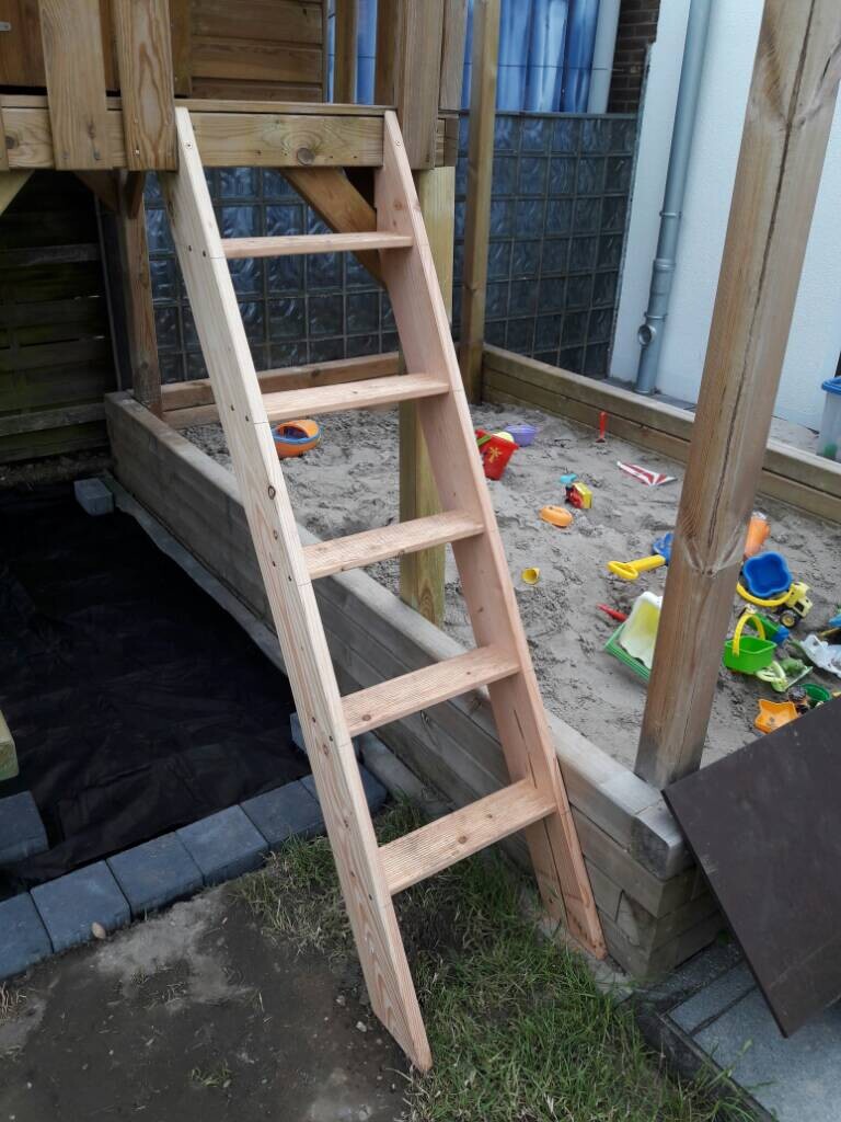

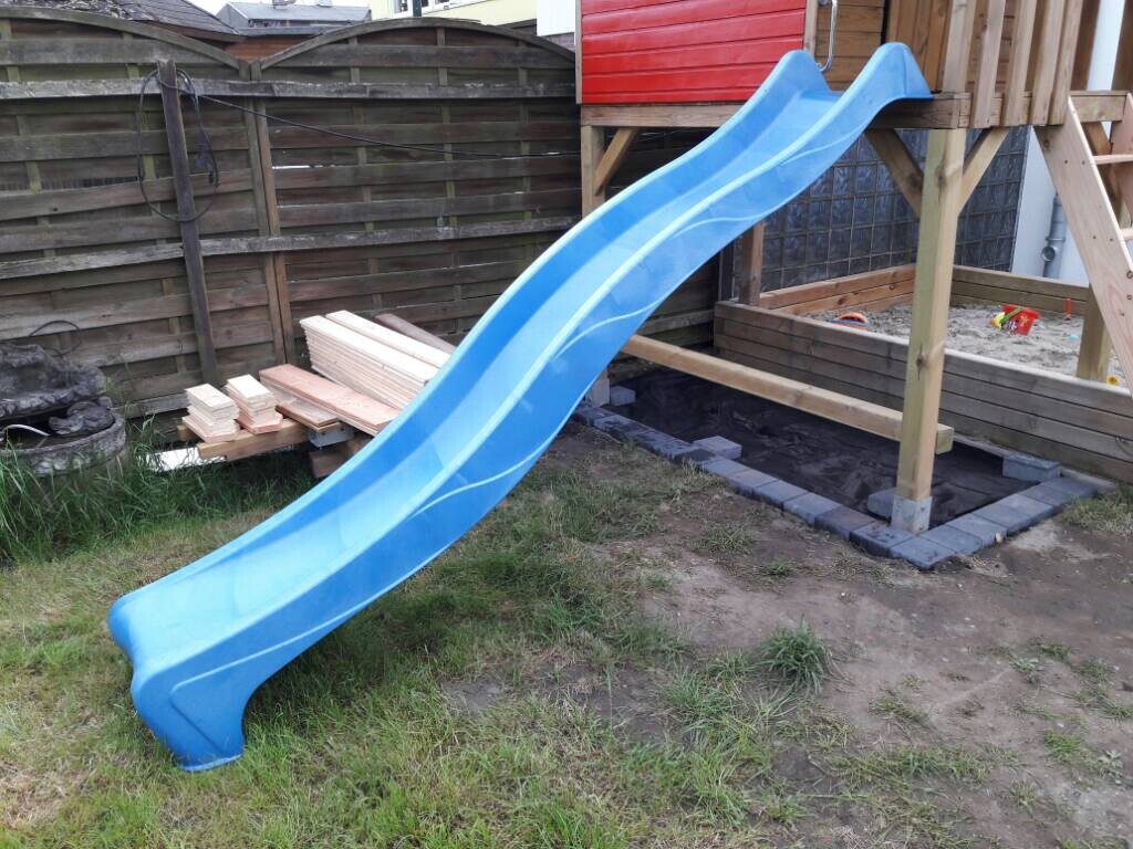

Then I built a staircase, which I think was successful. There’s probably not much to say about the slide.

Wooden ladder as stairs to a play tower in the garden with toys around
Blue slide on a wooden playset in the garden with sandbox
