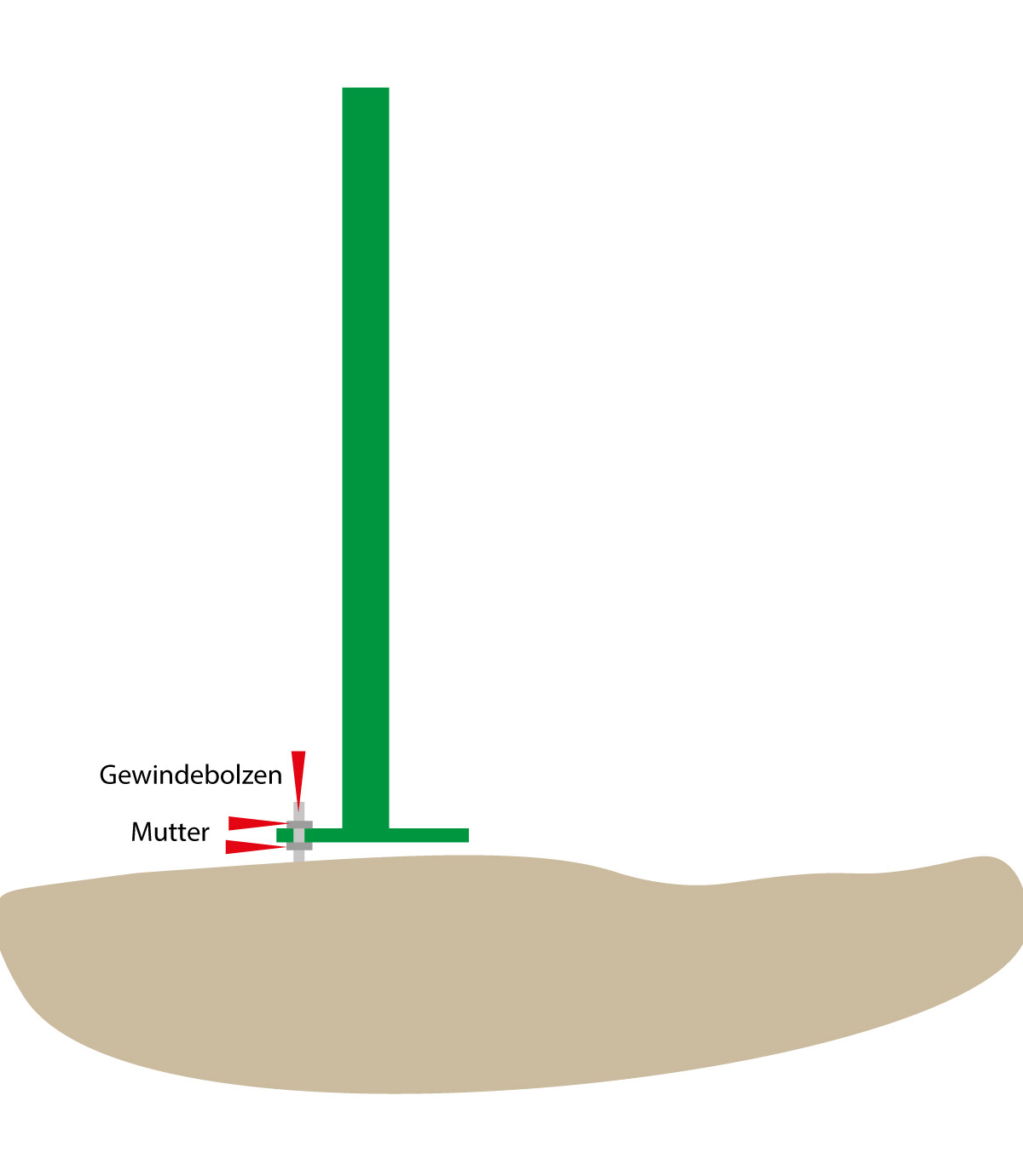

Changeling19 Mar 2020 14:48We have a sandstone wall made of thick, irregularly split blocks. It looks great, but what is the best way to install our fence there? We have standard welded wire mesh panels with corresponding posts for screwing on. Has anyone faced this challenge before? On one hand, the stones are not all the same height, and on the other hand, the relatively small base plate sometimes sits unevenly on the irregular stone surface.
First, I would stretch a string line and make sure it is perfectly vertical.
Then, position the posts, drill the holes, and as shown in the drawing, do not fasten the posts directly to the concrete or stone. Instead, use a nut to lock them from the opposite side. This allows you to properly level the posts. I assume there are four holes per base plate.
Finally, fill the gaps between the base plate and the masonry with mortar.
