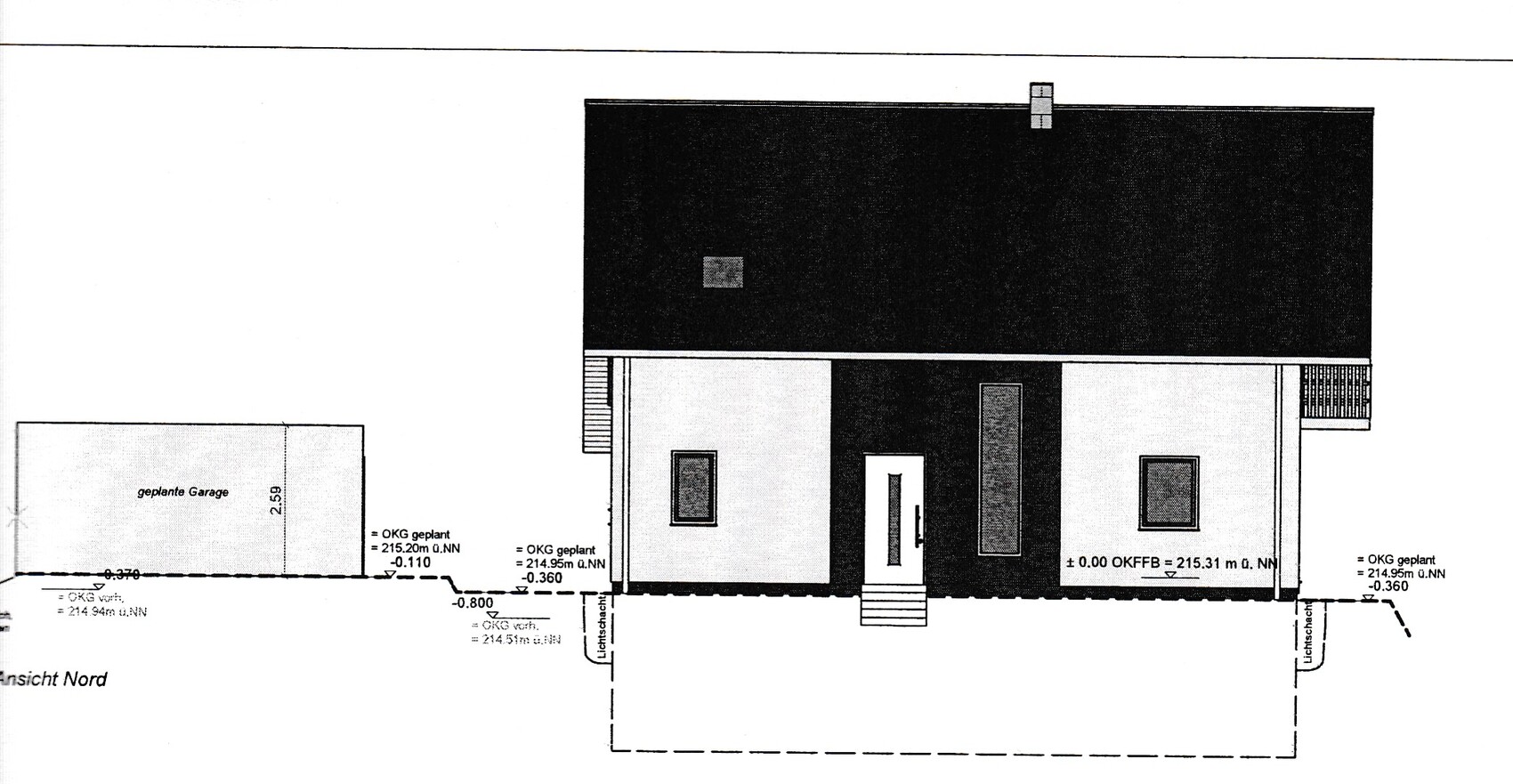

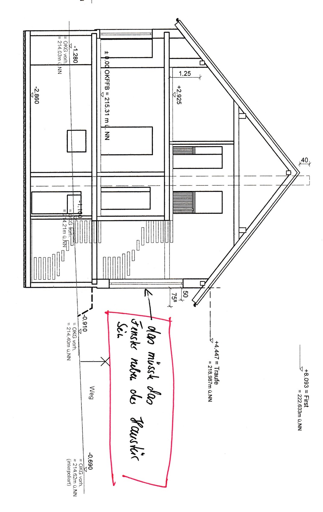

alter002925 Apr 2016 16:28I need to ask a question. Maybe someone here has experience with this. The company I chose seems to build good houses, as far as I can tell. However, in my opinion, the planning office is a disaster. We also planned a window next to the front door. It is supposed to be 300 x 76 cm (118 x 30 inches) in size. That canât be right, can it? Take a look at the plans. When I asked whether the glass can be replaced in case of damage, I was told: "After consulting Mr. Ka..., he pointed out that, among other things, cleaning the glass is only possible to a limited extent."
nordanney25 Apr 2016 17:07alter0029 schrieb:
We have also planned a window next to the front door. It is supposed to be 300 x 76 cm (118 x 30 inches) in size. Thatâs not possible, is it? Yes, it is possible. You yourself say that you planned it. Why should the window replacement not be feasible?
alter002925 Apr 2016 17:10Because, if Iâm not mistaken, there is a ceiling in between. The ground floor is 2.60 m (8.5 ft) high, and we have not planned a gallery on the upper floor.
