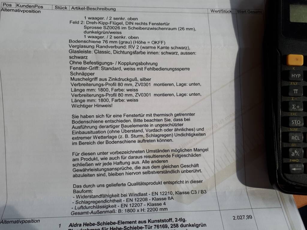

Another option to consider is the parallel sliding door mentioned below. The extra cost would be moderate compared to the standard terrace door. What concerns me is the “safety notice” with the disclaimer of liability. Is this something to take seriously, or just a precaution by the manufacturer because the scenario happened once in a thousand cases? At least initially, a terrace overhang is not realistic.
