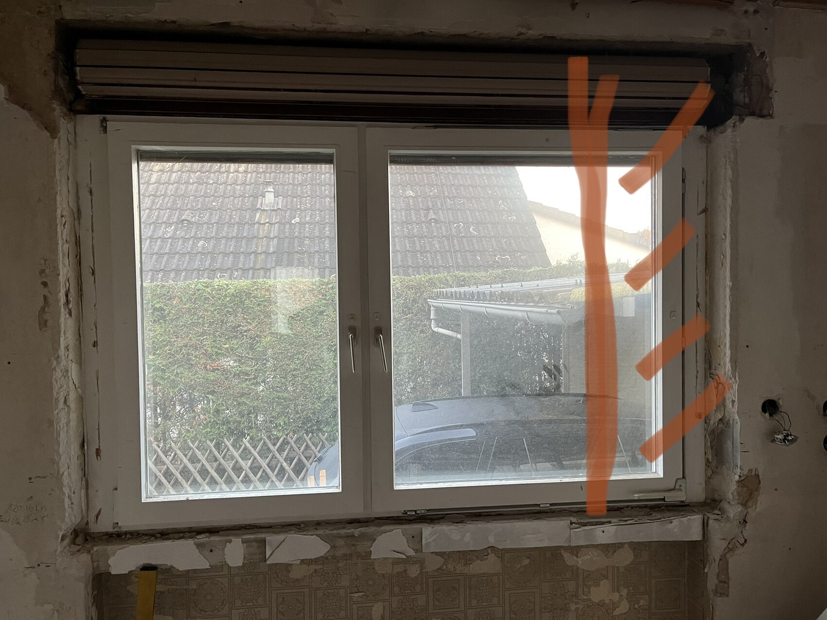

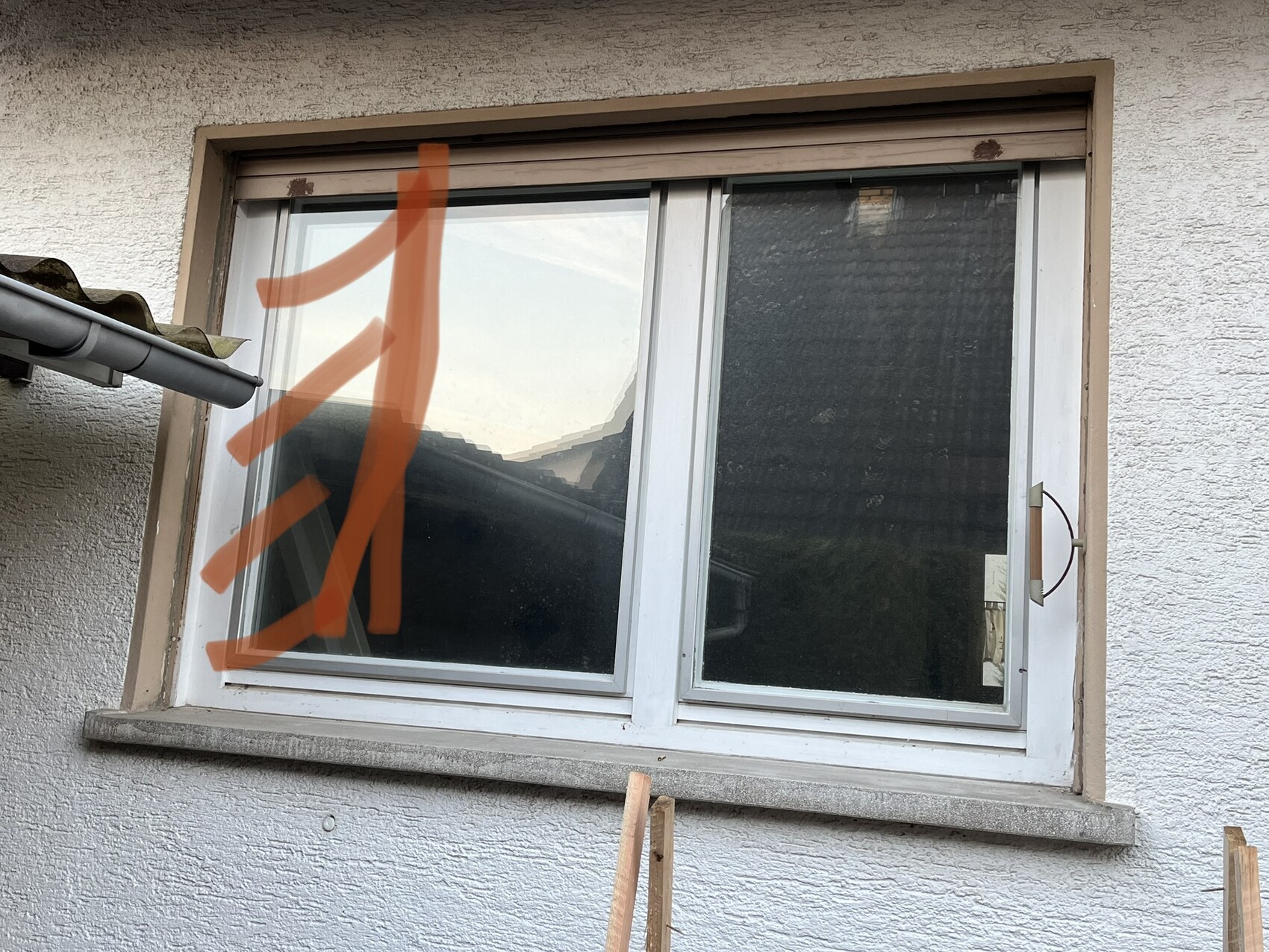

Regarding the topic, the former dining room is to become our kitchen. Unfortunately, things were built rather haphazardly in the past, and my father-in-law was an expert in the art of “works but looks awful,” so I would like to change some aspects. For my plan, the window is firstly too low, and secondly, the carport roof intrudes on one side of the window.
I would adjust the window height using the roller shutter box, removing the interior roller shutter and installing an exterior one instead. My bigger questions relate to reducing the window reveal from about 2.10 meters (7 feet) to 1.60 meters (5 feet 3 inches). What type of bricks or blocks are best to use? How do I create a stable and secure connection to the wall? In such small works, can I use adhesive to bond the bricks, or must I mortar them in every case?
Since I want a smooth masonry finish (flush plaster) after adjusting the reveal, I plan to install the window with continuous sealing tape (external sealing tape, internal insulation tape). Should I also use compressible foam tape? Are there recommendations for window tape brands, or do products from Amazon work just as well? What do I use to bond the window tape to the masonry? How do I calculate the required screw length for securely fastening the window?
Lots of text, lots of questions! I’m grateful for any tips and advice.

Wolfgang H.5 Nov 2024 07:48Oh, I would rather cover the view of the gutter with a transparent blind than significantly lose natural light by blocking up the window opening. Unnecessary construction costs just to end up thinking, "What a fool I was."
Arauki11 schrieb:
Or a narrow window film?
At least, I would also consider from the other side how to cleverly conceal it in an attractive way. Exactly. The car and shop window sticker creates a softly faded satin finish on the glass, so the gutter is no longer distracting, all while maintaining excellent translucency.
