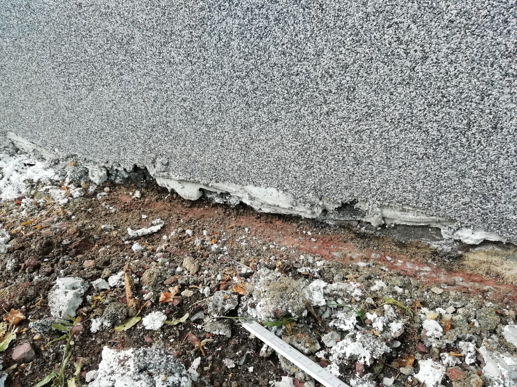

As you can see in the pictures, there is already damage on one wall side in the garage (rising damp and plaster crumbling).
I believe this is because the concrete wedge of the perimeter strips on the outside runs directly up to the house wall (visible in pictures 4 and 5). Water cannot drain here.
At this spot, the rain doesn’t reach due to the roof overhang, and everything above the concrete wedge was dry. Only below it was damp. I have now removed a good portion of the wedge so that water can drain away and the ground underneath can dry out. But how should I treat the masonry? Waterproof slurry and drainage membrane?
Do you think that with the now shortened wedge, this will work permanently?

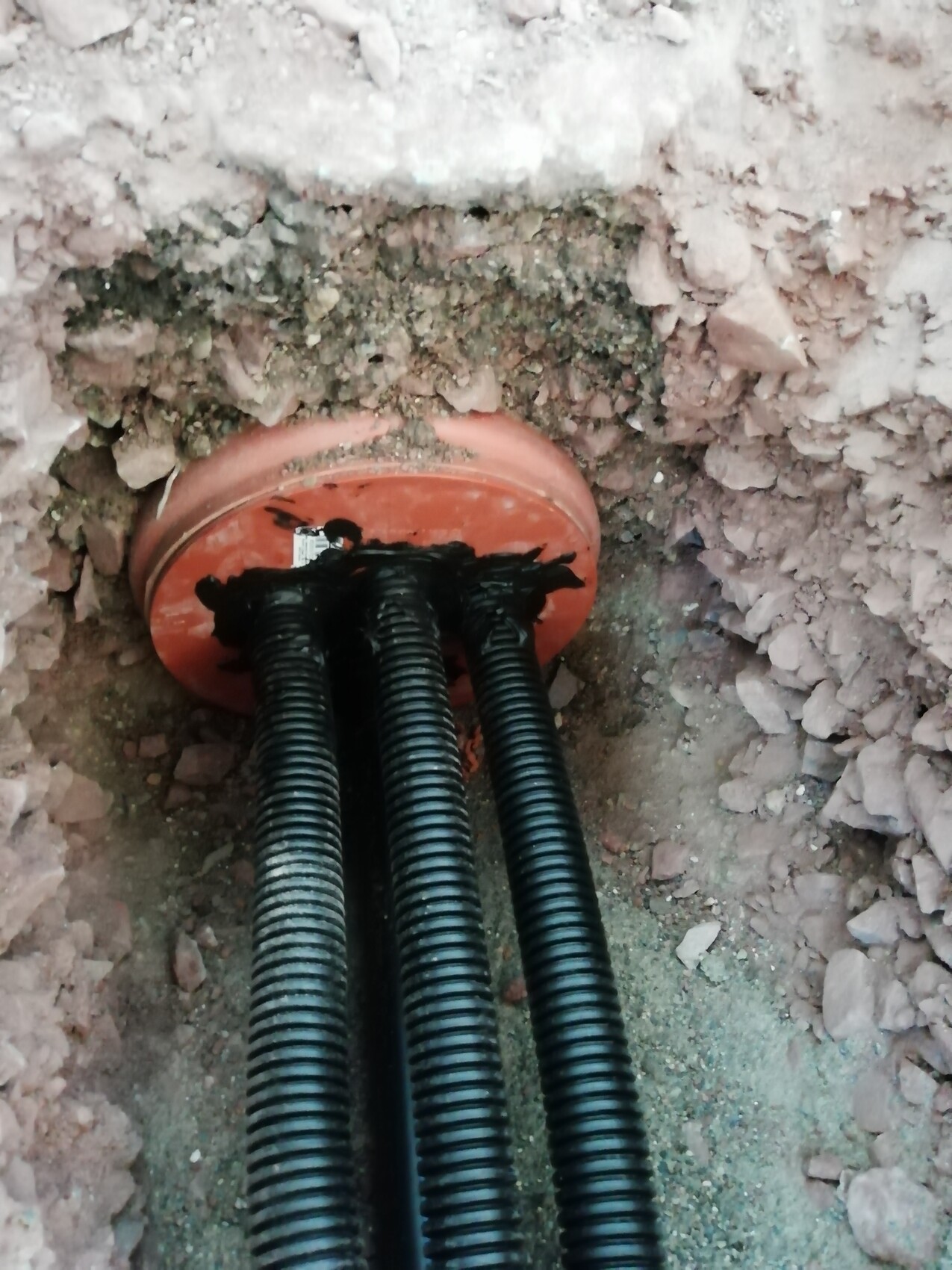

Are you referring to the shaft in the garage?
No, there I installed a few empty conduits that run outside through the strip foundation using PVC pipes. Inside, there are two electrical cables and one water pipe.
Three black flexible cables lead from an orange round cover into the ground.

@Oreider It looks like there is no waterproof slurry, see the post by @gmt94. However, there should be one applied. Whether drainage is necessary cannot be determined from the photos. Just splash water protection alone is not sufficient.
Vicky Pedia30 Mar 2020 17:47
@gmt94 Thanks, I misinterpreted the photo.

I just found a photo taken from outside. This is basically how the entire exterior of the garage looked.
Gray concrete wall with crumbling edge, debris and measuring tape on the ground.
As mentioned, the waterproof slurry must be applied all the way into the junction between the wall and the strip foundation. Otherwise, water always finds its way through the concrete.
