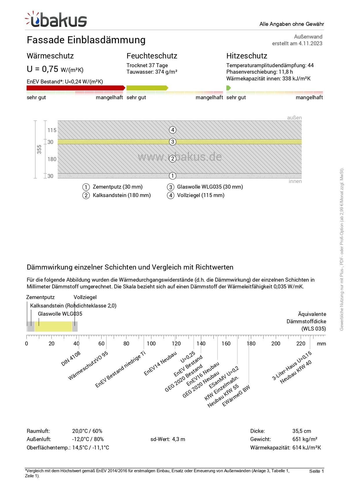

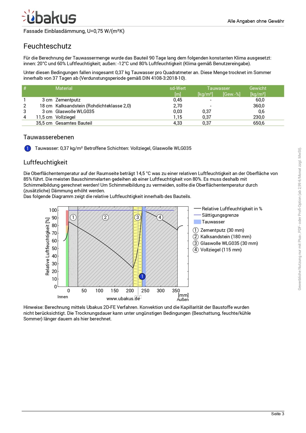

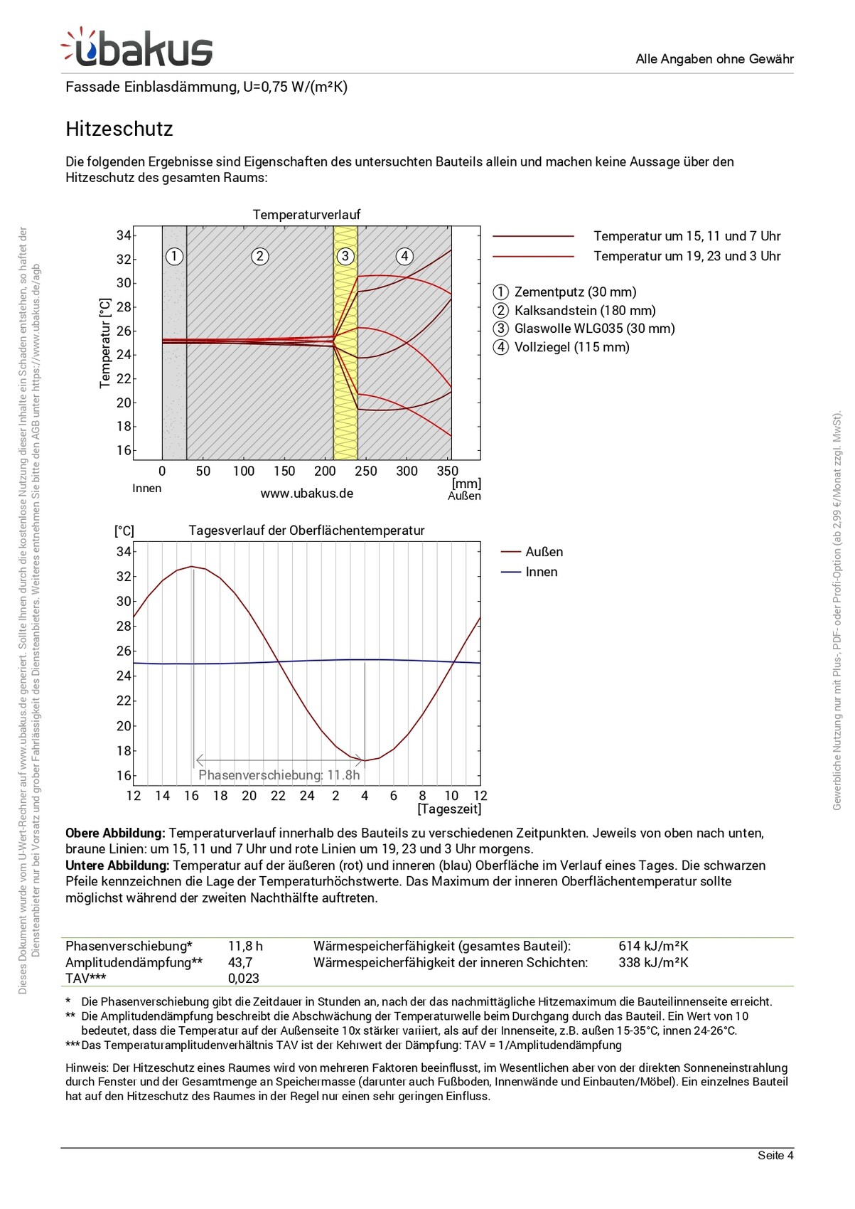

As mentioned, we are considering blown-in insulation. For this, I calculated the construction build-up using Ubakus (attached) and noticed that condensation accumulates in the insulation. I am concerned about making this worse. Adding insulation on the exterior facade is currently not financially feasible.
Has anyone had experience with blown-in insulation and can share their insights?
Best regards, Andre
Best regards, Andre

Then the only option left is blown-in insulation and increasing the room temperature to 22–23°C (72–73°F), keeping furniture away from the exterior walls. Thank you for the information. I have uploaded it as images.
