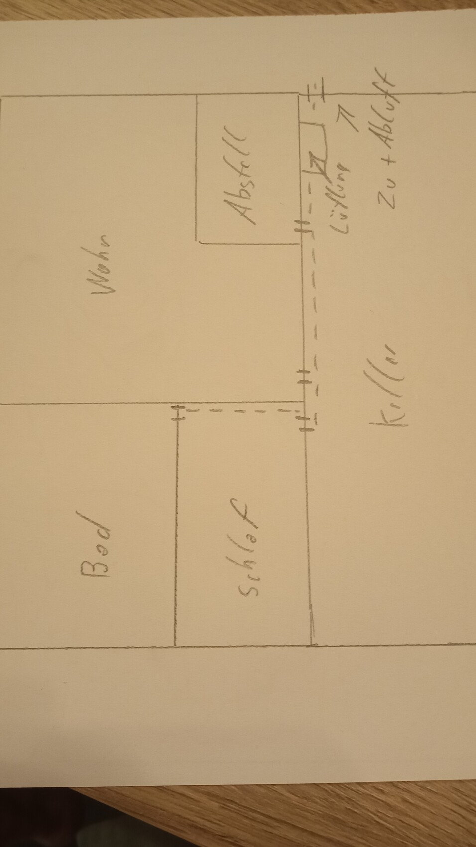

nordanney19 Oct 2024 20:59Stefan1510 schrieb:
Heating is already installed What temperature do you maintain inside the rooms?
Stefan1510 schrieb:
Piping for a central ventilation system wouldn’t be a problem due to the room layout How do you plan to do that? Suspended ceiling? Bulkheads over the rooms above or below the apartment? Where will the supply and exhaust air be located? Where will you place the central unit?
Stefan1510 schrieb:
My concern with decentralized ventilation is that not all rooms would be ventilated If you can’t install a device in every room and the doors are usually closed, then no.
Alternative: An exhaust fan combined with trickle vents in the window frames.
Central is – trust me – a foolish idea.
Stefan151019 Oct 2024 21:27When no one is home, the temperature in the rooms is always set to 19°C (66°F). Installing cladding wouldn’t be a problem; it would only need to cover 3 meters (10 feet) in the bedroom, which will be repainted soon anyway. Everything else can be installed in the adjacent basement room. I have attached a sketch of what I had in mind. In my opinion, a decentralized ventilation system would be more complicated here because I would need to ventilate every room and would have to make at least four core drillings.
Stefan151019 Oct 2024 21:28nordanney schrieb:
If you can’t install a unit in every room and they are all initially closed off, then no. I don’t quite understand this.
Attached is the sketch.
