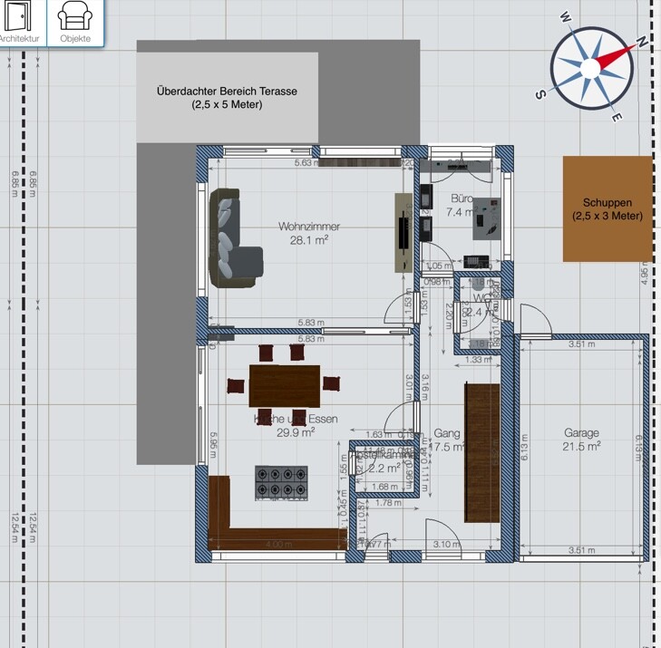

Good Sunday afternoon, dear forum readers,
My wife and I have been following this forum for some time and have already been able to take various things into account in our planning thanks to your contributions.
Since this year, we own a city plot that we plan to build a single-family house on within the next one to two years.
In the past few weeks, we have been working on the floor plan design. For this, we used the software "Home Design 3D."
Our plot is located in the middle of the city and is surrounded on three sides by other developed properties. At the front, about seven meters (23 feet) from the main entrance (according to the current plan), runs a lightly trafficked access road.
A special feature of the plot is its relatively elongated shape (17.5 meters (57 feet) wide, 35 meters (115 feet) long).
We would greatly appreciate your critiques and suggestions for improvement, especially since this is our first (and hopefully last) new-build project.

Who designed it: DIY over the past three weeks…
What do you especially like?
Most of our personal wishes could be implemented in this design (e.g., separated "parents’ area")
What don’t you like?
Relatively small living room, separation between living area and kitchen/dining with sliding door (for noise/smell reasons) is not ideal yet, relatively small cloakroom
Personal budget limit for the house, including fixtures and fittings: 450,000 euros plus additional building costs and landscaping
Preferred heating technology: air-to-water heat pump (system located in the basement technical room)
Why did the design turn out the way it is?
Brainstorming during the last three weeks followed by an attempt to incorporate these ideas into a self-designed plan.
With our current planning, this design provides a living area of about 170 sqm (1,830 sqft) on the ground and upper floors.
We would really appreciate your critiques and suggestions for improvement, especially since neither of us are professionals and this area is new to us.
Unfortunately, the software split some wall sections into smaller parts unintentionally, which does not make it clearer;-(
Thank you very much in advance for reading and your feedback,

Is it allowed for the terrace to be built on the property boundary? Often it is not. According to the building authority, there are no objections at this location. However, the terrace on this side will definitely be kept smaller for the reasons already mentioned here.
Please add it to the drawing. Done.
The entire layout is poorly thought out, and the staircase should be placed in a corner. The straight staircase takes up far too much space! Also, the pantry next to the kitchen is pointless! In a well-designed kitchen, you don’t need a separate pantry. The island is mostly unnecessary if proper ventilation cannot be ensured!
The staircase shown in the avatar is designed for an opening 2.3 m (7.5 feet) wide and 1.8 m (6 feet) deep.
Thielemann03 schrieb:
The staircase belongs in a corner.I have to disagree with you on two points: 1. The staircase is already in a corner, and 2. that is exactly where a straight, single-flight staircase should be placed as one of the last options.https://www.instagram.com/11antgmxde/
It seems to me that we are talking past each other! I said that with so little space, a straight staircase is not very practical, and you can achieve a better room layout if the staircase does not take up so much space!
I agree, and a more efficient room layout is definitely possible with this floor plan.
