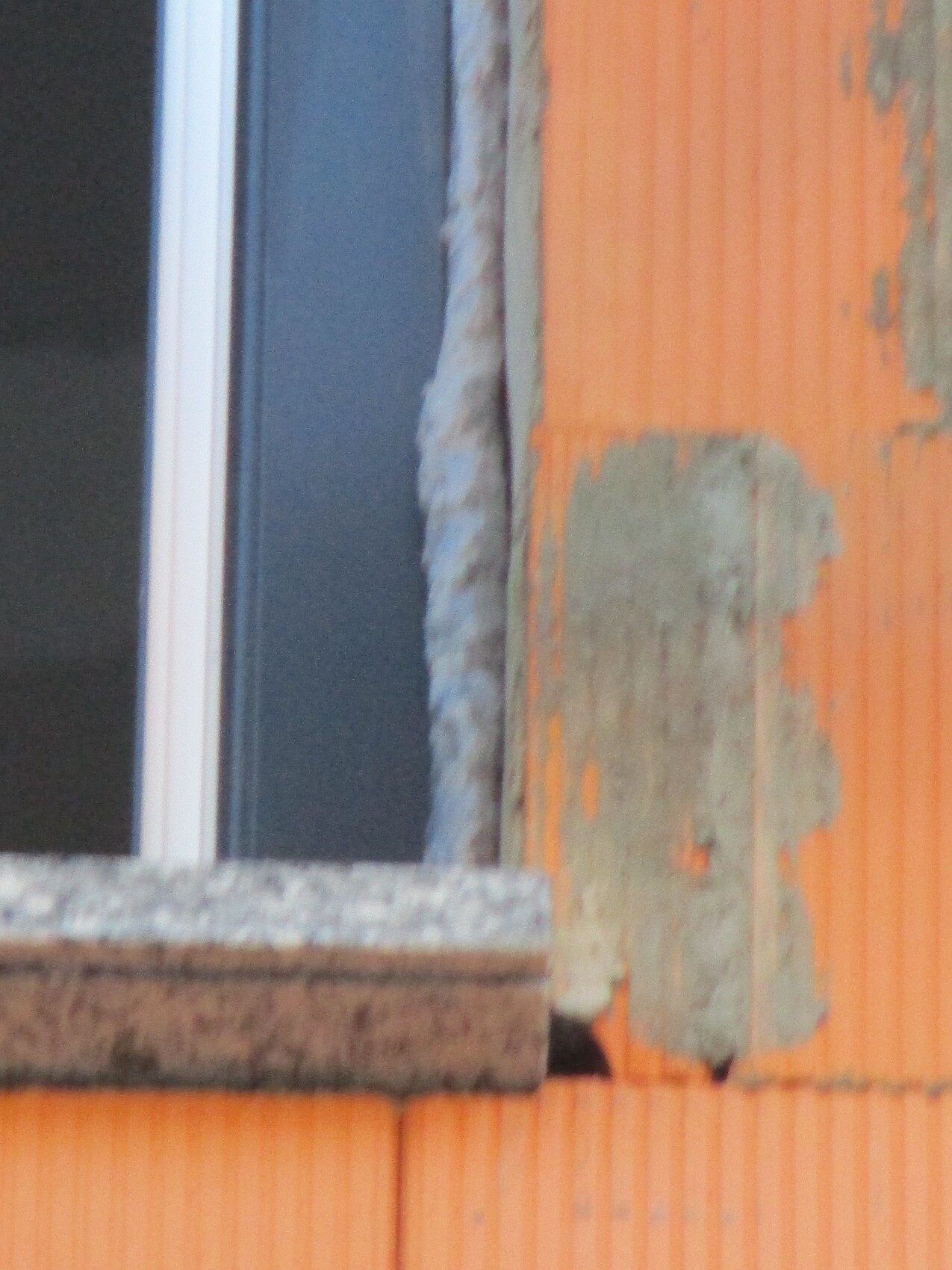

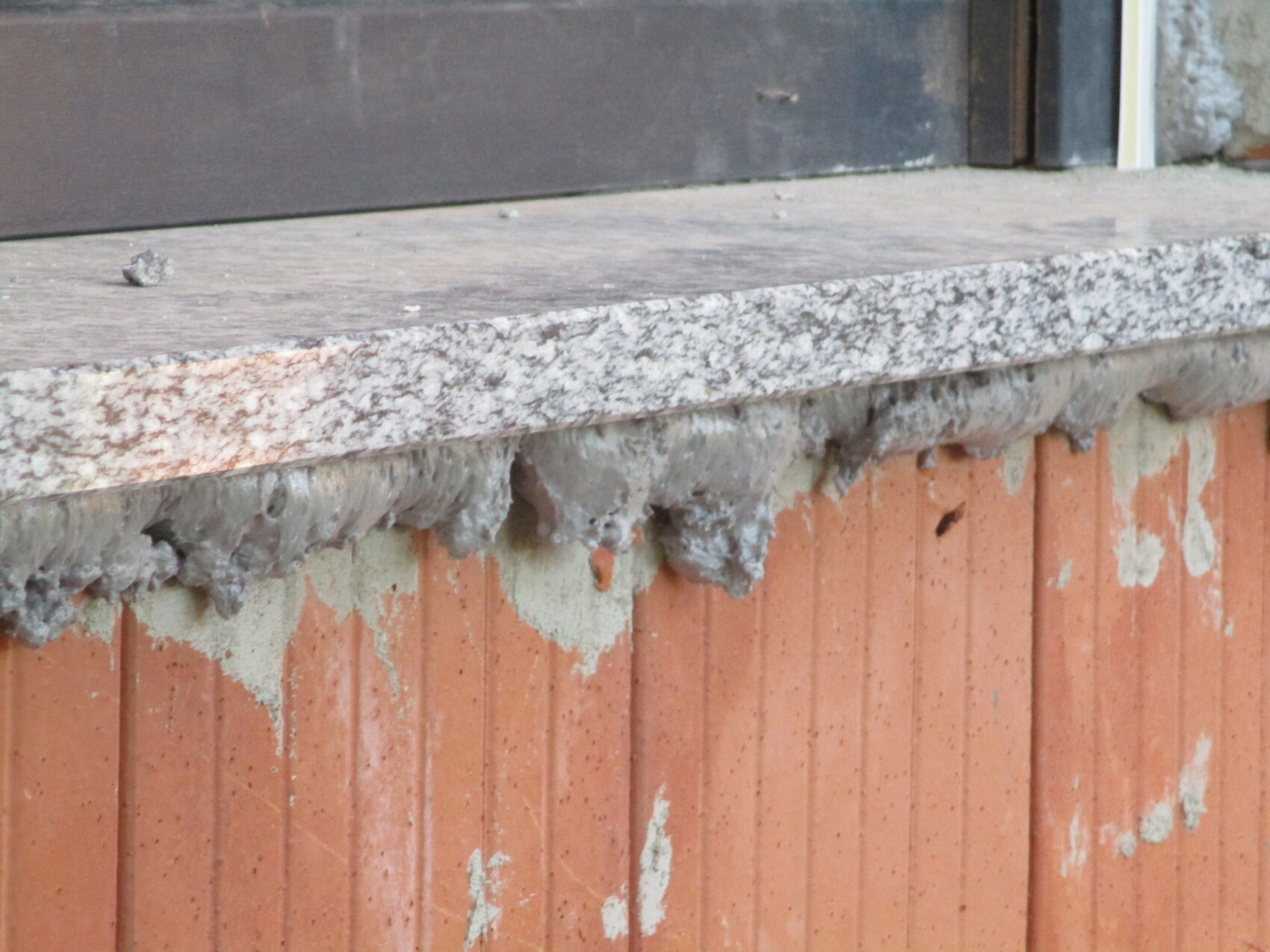

This foam nonsense should be banned. There are regulations and standards for every little thing, but when it comes to sealing windows, everyone does it however they please. This is what our third sealing attempt looked like.
Close-up of a window frame on an orange plastered wall with peeling plaster.
Granite window sill above a crumbling brick wall with plastered masonry.
