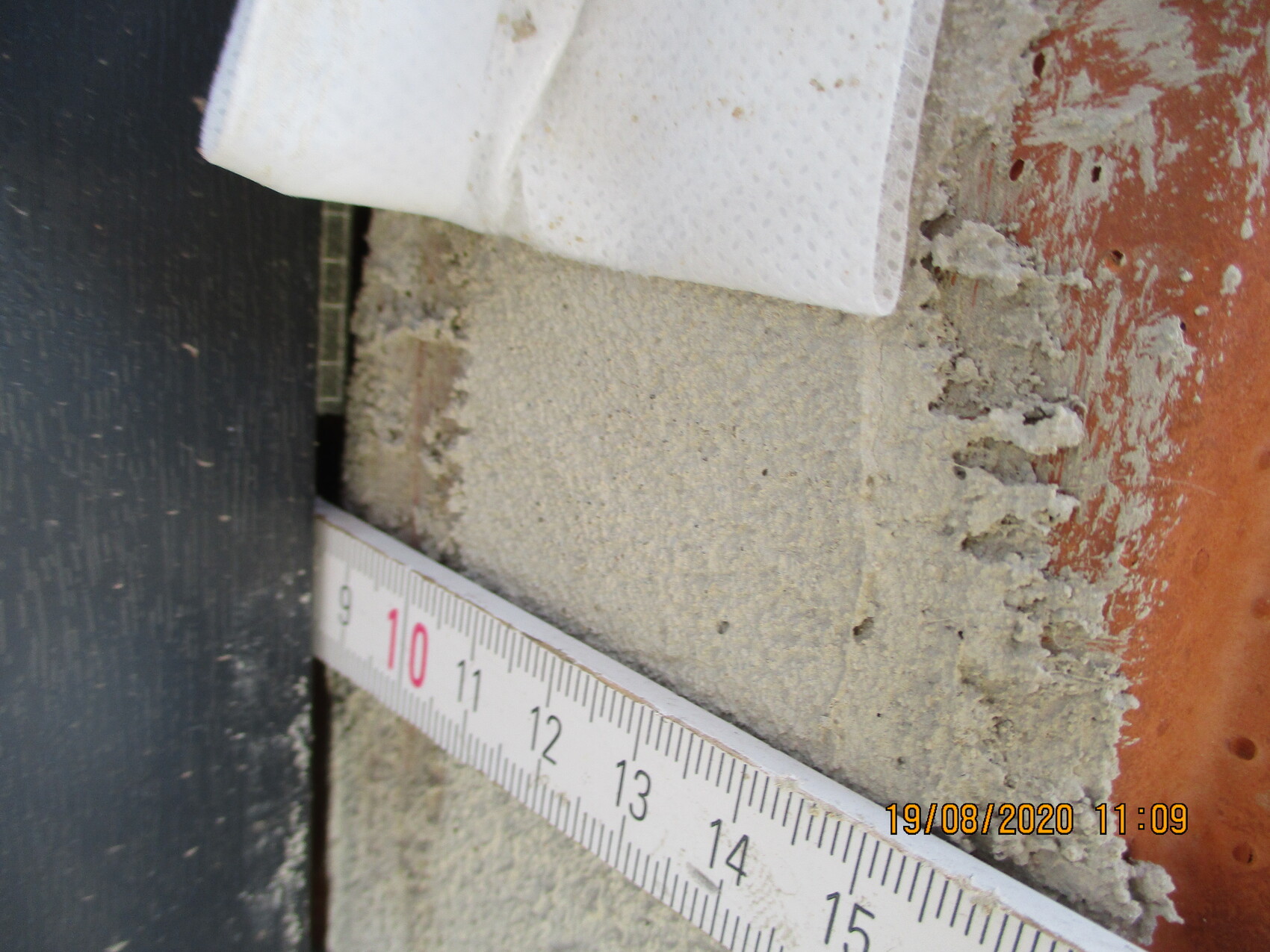

Hausbau08154 Jan 2021 10:53
Schlenk-Bär schrieb:
If I understand you correctly, it’s mainly about spotting whether poor workmanship is happening. Maybe also hoping that being physically present on the construction site will prevent mistakes?
Here is an example: When you remove the tape, you can see what’s behind it—actually nothing. Great waterproofing! You just have to be there at the right time before it gets completely covered up.
Measuring tape lying diagonally over rough masonry with mortar; date 19/08/2020 11:09
