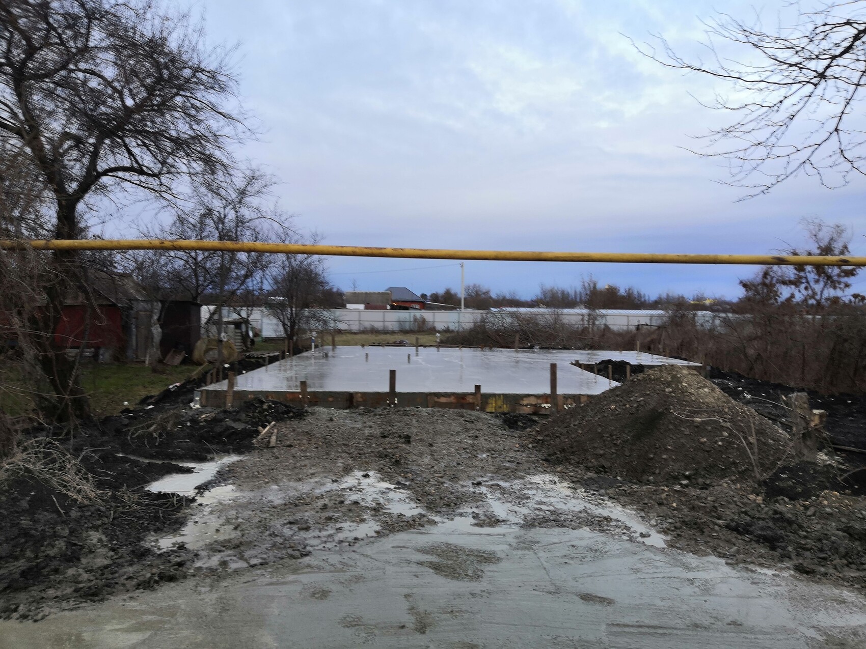

The concrete slab is now curing, so far so good.
Now regarding the topsoil, I only replaced the topsoil with gravel in the area where the slab is.
Does this also need to be done along the strip foundation?
What are the benefits of that, or more precisely, what are the disadvantages if the soil touches the concrete?
There is a plastic sheet between them, or there was one—it is now torn in some places.
