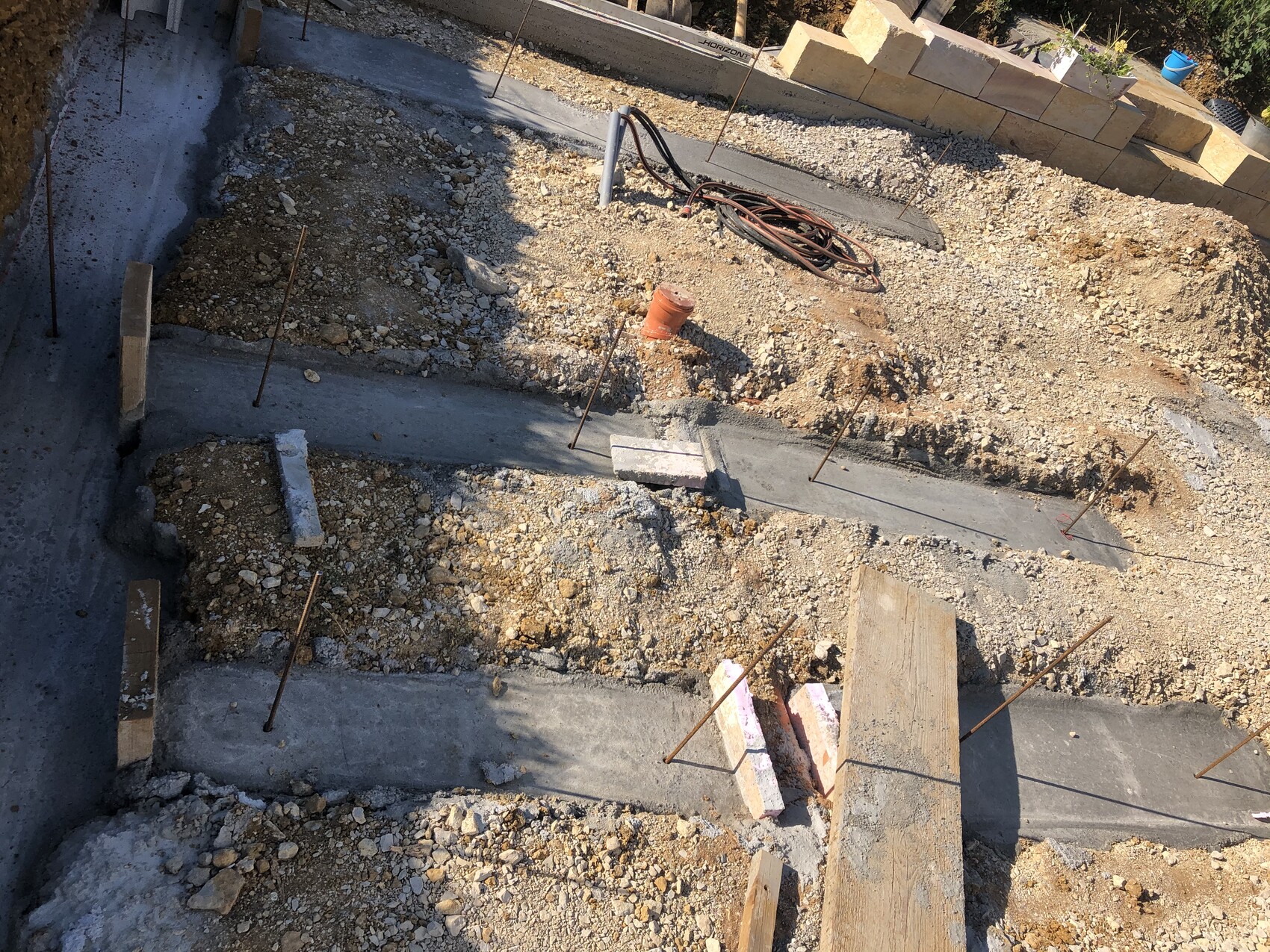

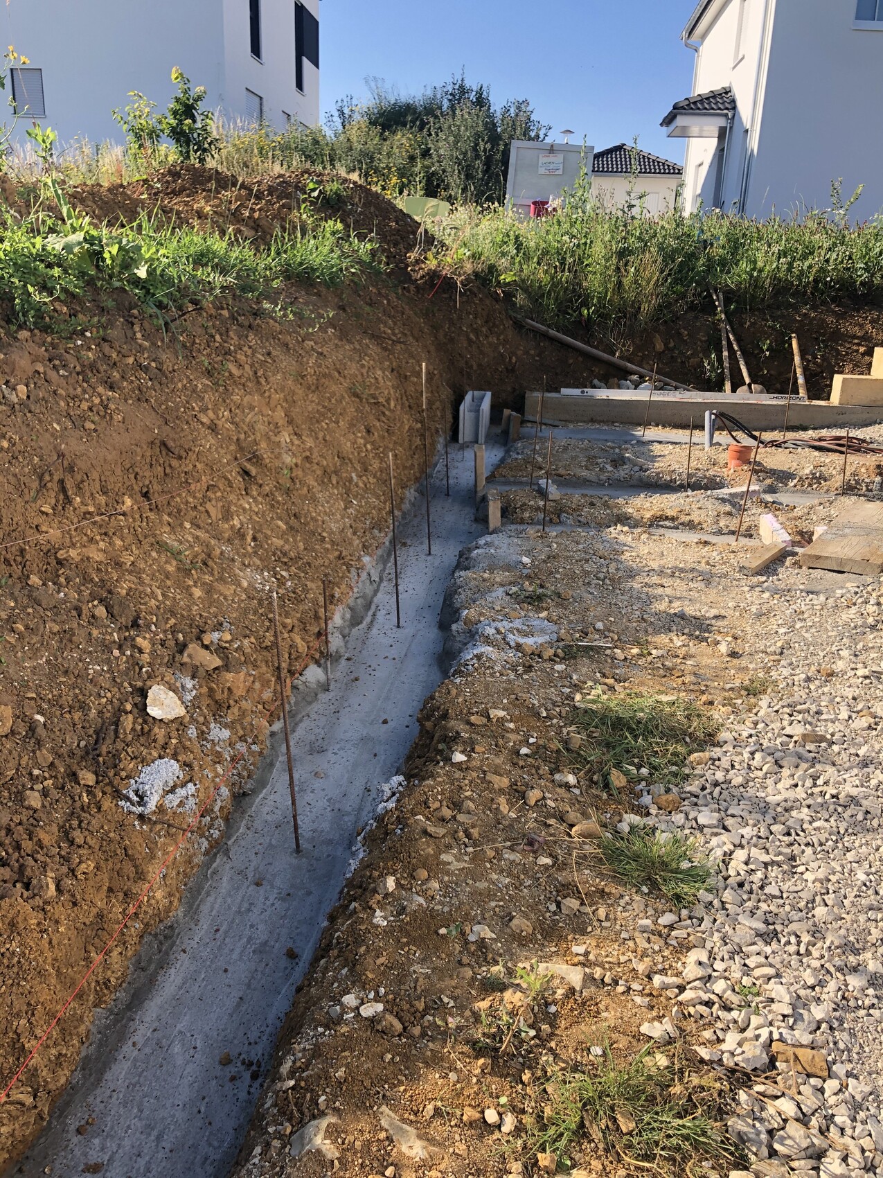

So, after excavating quite deeply, I have poured the foundation.
I will start by laying two rows of the retaining wall blocks and then build the strips for the garden shed onto them. That will basically form a large L shape.
I just hope I can get the garden shed strips nice and straight!
Construction site with deep trench, fresh concrete foundation with reinforcement bars, gravel and soil.
Construction site with gravel, concrete foundations, reinforcement bars, and wooden beams.
tomtom7912 Jul 2020 09:07
Looks good, but more rebar wouldn’t have hurt.
M4rvin12 Jul 2020 09:14
Hmm, okay, now it’s too late. I was worried that it would be difficult to align the bricks. I have now dry-laid the first row and already had to shift them back and forth three times!
tomtom7912 Jul 2020 09:24
The rough layout is done beforehand, but don’t worry if you have to cut some parts the first time. I also had to cut a few myself. I placed planting rings but didn’t account for the quarter circle.
Do you have the formwork blocks with the half-round recess on top? If so, insert steel reinforcement there as well.
M4rvin12 Jul 2020 09:26
It will hold! Yes, for the horizontal layers, I will lay a full course on each row. Additionally, I can also place some vertically on the foundation.

Get 12mm (1/2 inch) reinforcing bars. Measure the position of the concrete blocks. Drill 12mm (1/2 inch) holes about 10cm (4 inches) deep into the foundation. Then insert the reinforcing bars approximately every 30cm (12 inches). Let them protrude 40-50cm (16-20 inches) above. This way you’ll be on the safe side.
