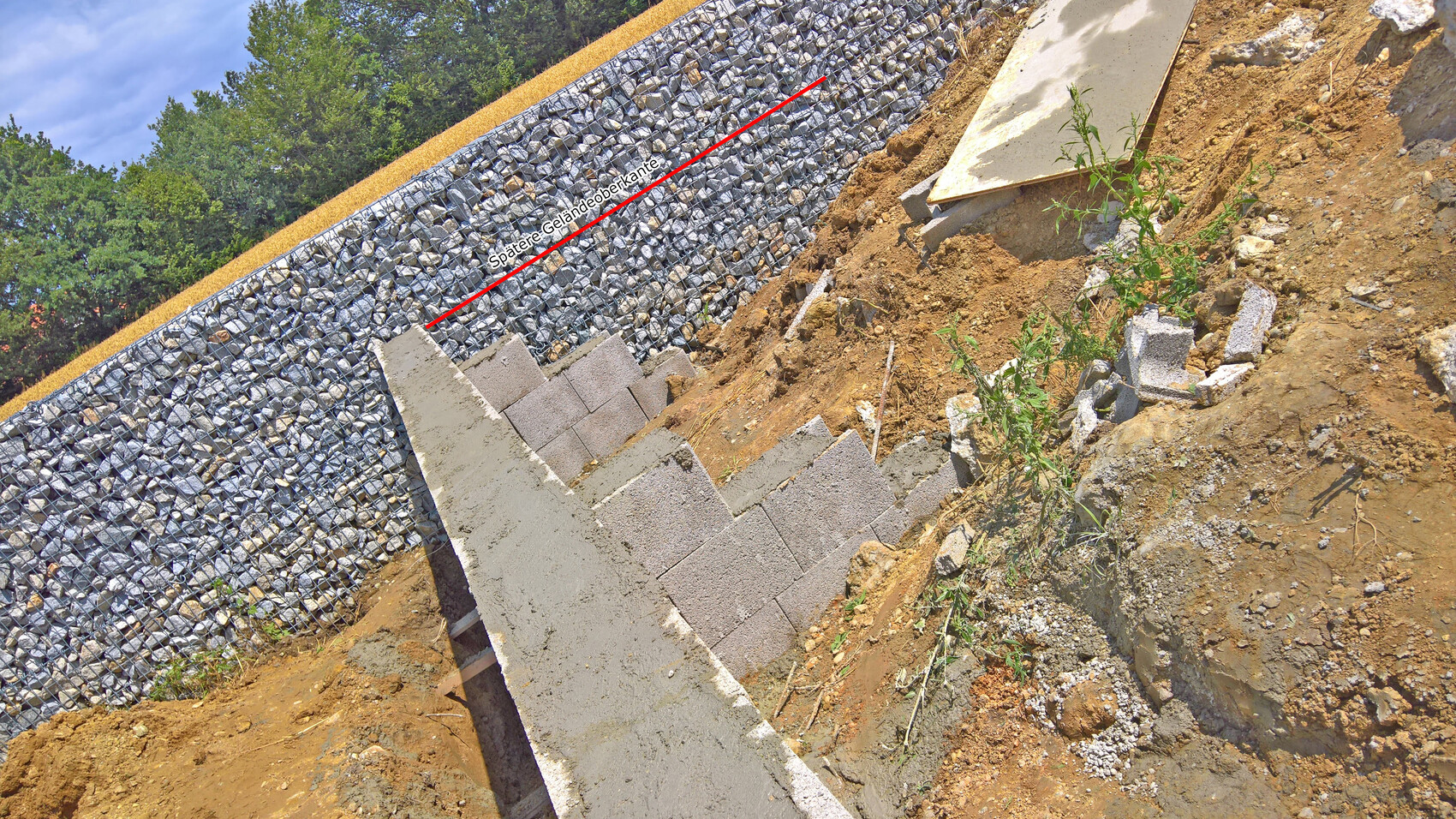

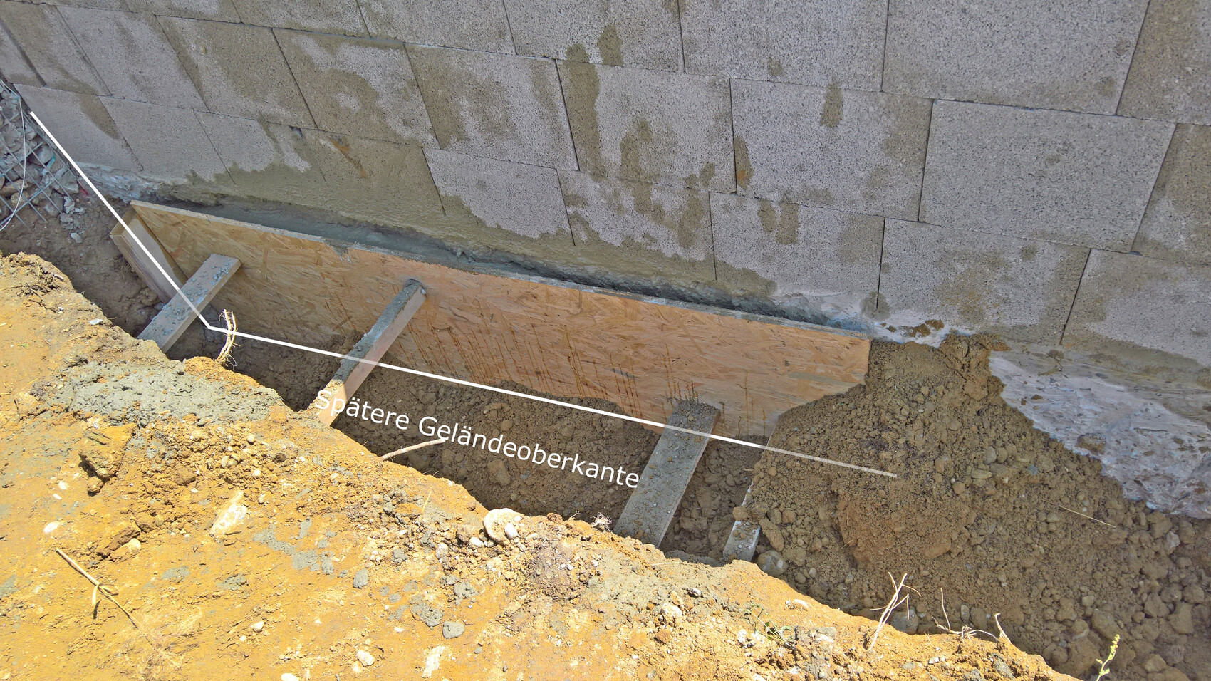

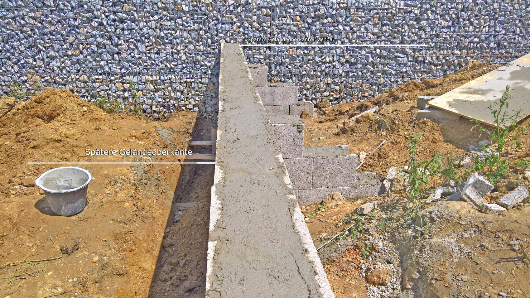

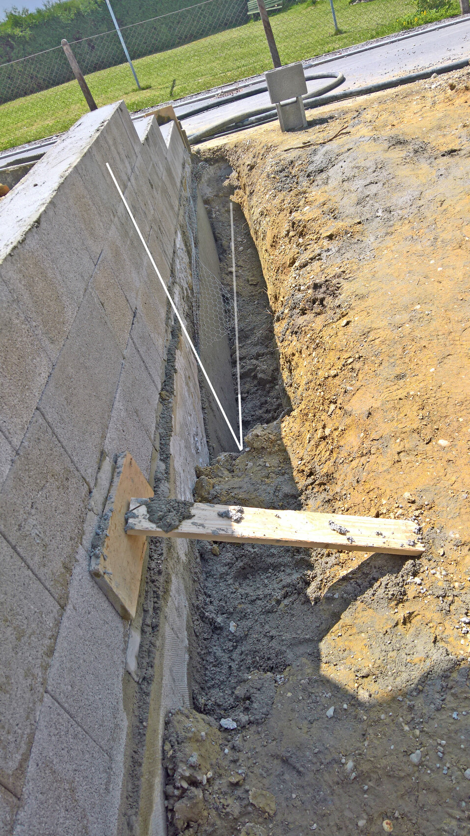

DReffects15 Jul 2017 16:09
Unfortunately, the neighbor has already backfilled most of the area again after the excavation and is freely using our construction water for concrete work.
Here are some photos for you – I’m looking forward to your opinions!
Trench next to a concrete wall at a construction site; temporary wooden bridge over the trench.
Excavated foundation pit next to a concrete block wall, wooden formwork boards and soil.
Construction site: Long strip footing, next to layers of blocks and a gabion wall.
Gabion wall made of stones on a slope, red line with label indicating future ground level.
