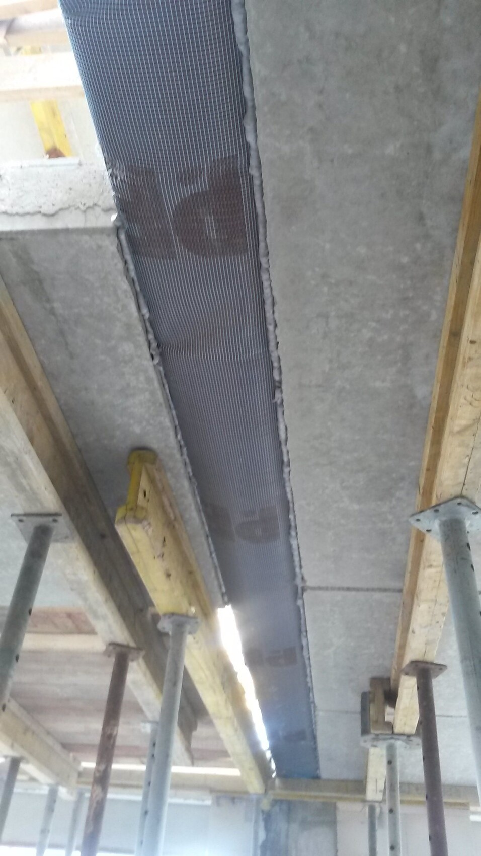

For us, the ceiling looked like this with mesh tape:
This is bridged with reinforcement mesh up to 20cm (8 inches) over the concrete, then plastered. The socket openings are not an issue at all, as the holes are incorporated into the plaster.
The reinforcement mesh can be easily adhered to both steel and concrete, so there is no need to make a big deal out of it.
Using painter’s fleece on the final plaster helps prevent visible cracking in the end.
