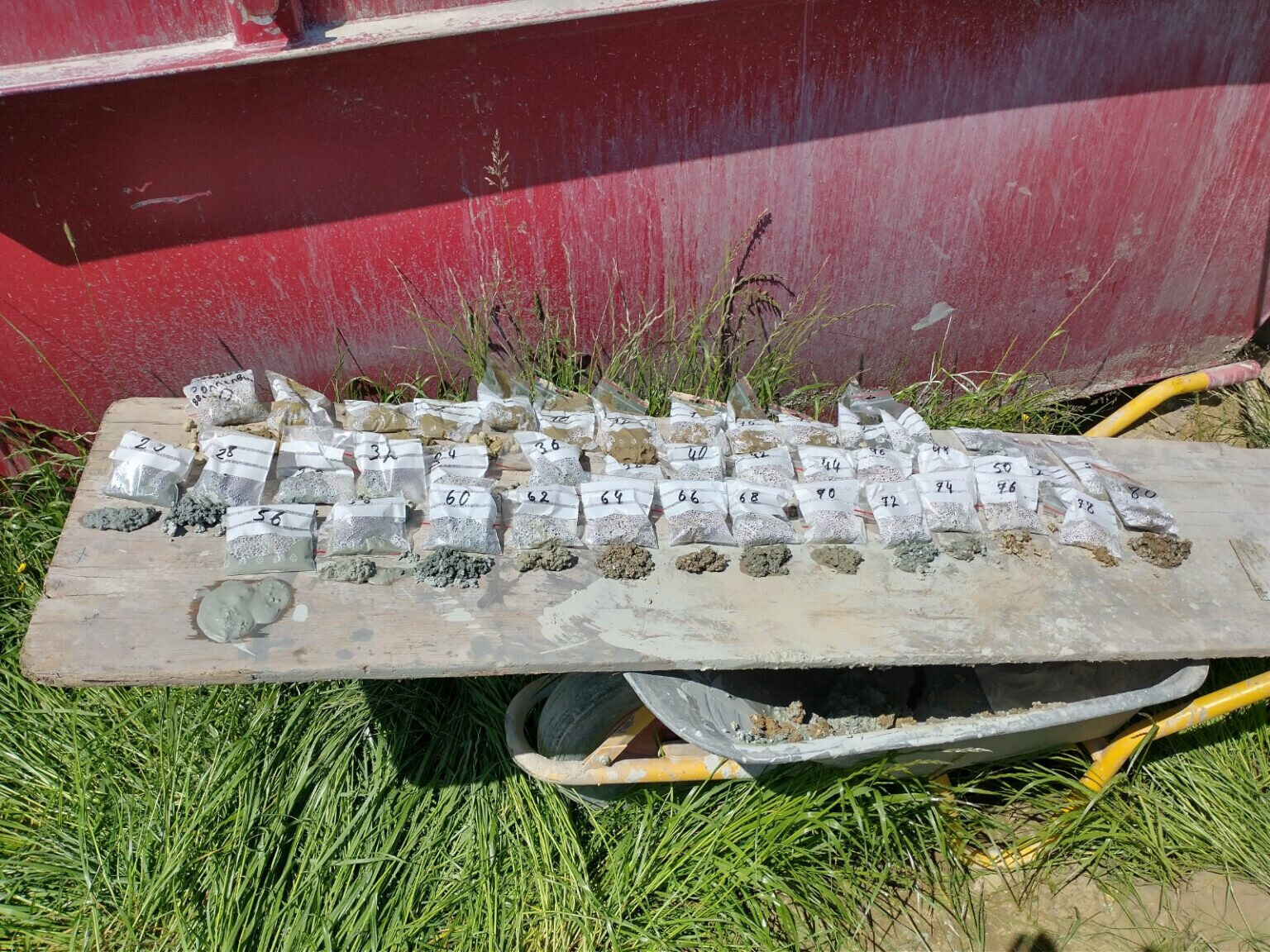

WilderSueden2 Feb 2023 23:17NilsHolgersson schrieb:
2. How are your soil conditions? Regarding regeneration: here we mostly have clay, which is completely watertight – that wouldn’t be ideal for the probe... I have no idea what it’s like at 80m (262 ft), but here the top layer is also clay. However, the soil changes deeper down.
The Federal Geothermal Association or the Geological Services of the federal states provide maps showing the heat extraction capacity/thermal conductivity of the soils, which are sufficiently reliable for a preliminary assessment.
In our case, the rock extended almost completely throughout the entire depth.
