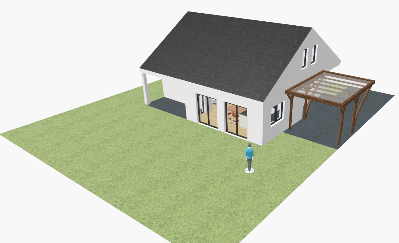

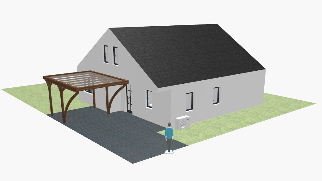

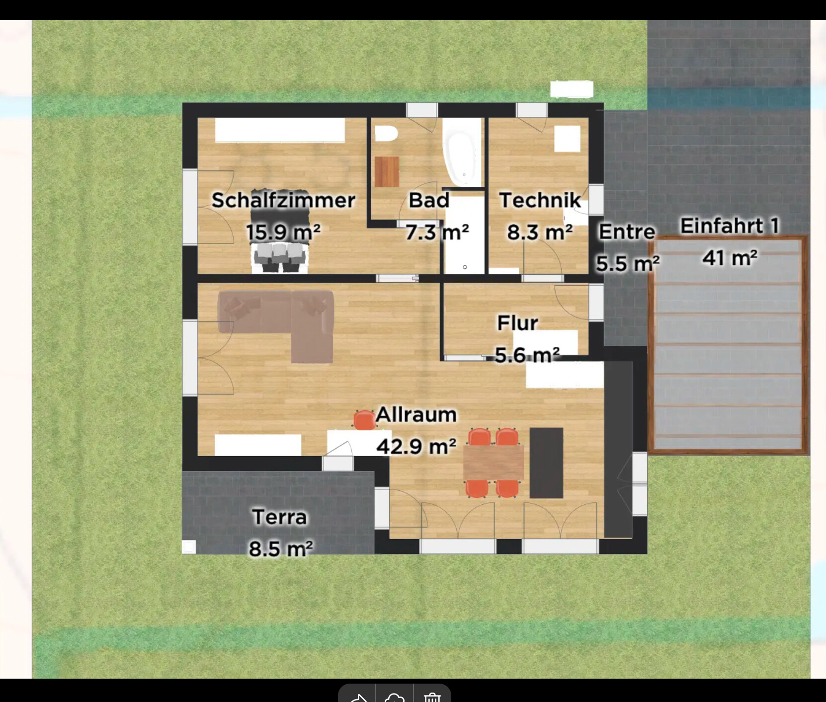

I have one more, between 75 and 80 sqm (800 and 860 sq ft) excluding terracesSo, what do you think @Newbee-BW? Is this still an improvement for you, or a downgrade?
Newbee-BW16 Dec 2024 19:39@ypg I really like this one! But also the other one. Each has its own advantages. In any case, the general layout with the living area along the south side is set. The patio and the entrance near the carport have also been included in the must-have section.
A general question: is the location of the utility room (HWR) dependent on where the utility connections enter the property? Should this be taken into account, or are the “few” meters negligible? If this is important, I will need to contact the local authority to see if I can get the plans. They should also be able to provide the precise external dimensions of the plot. These are not shown on the development plan or the site plan.
motorradsilke16 Dec 2024 20:11I would (and have) base the location of the utility room solely on where it fits best. Of course, you can try to keep the pipe lengths as short as possible, but if it doesn’t fit well, I would rather spend a little more money than spoil the best features of the house with the utility room.
A certain number of meters is already included in the basic fee anyway; you can check this with the utility providers.
For us, it was 15 meters (49 feet) including, and with the same orientation (north-south) and the driveway requirement, there were no complicated considerations.
It will be the same here. Sometimes I do think that the utility room as a planting room would have worked well on the south side for us, but living spaces are naturally more important if you like sun.
