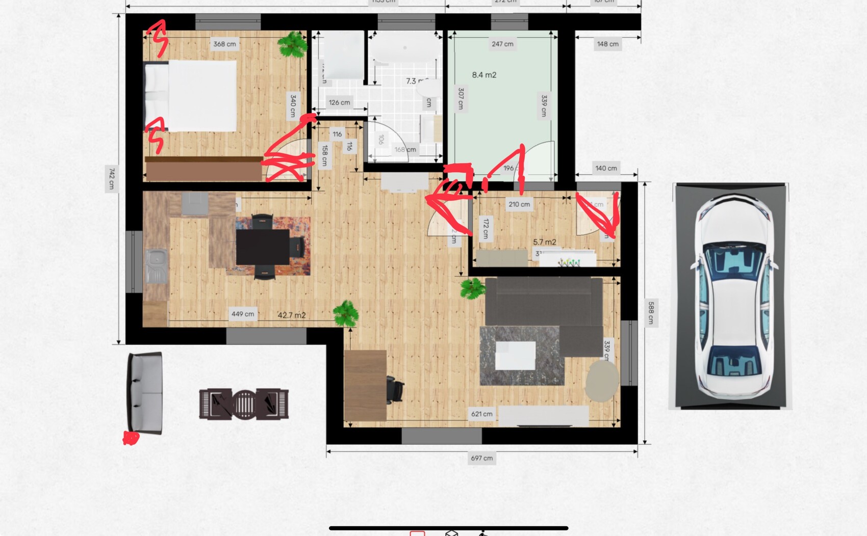

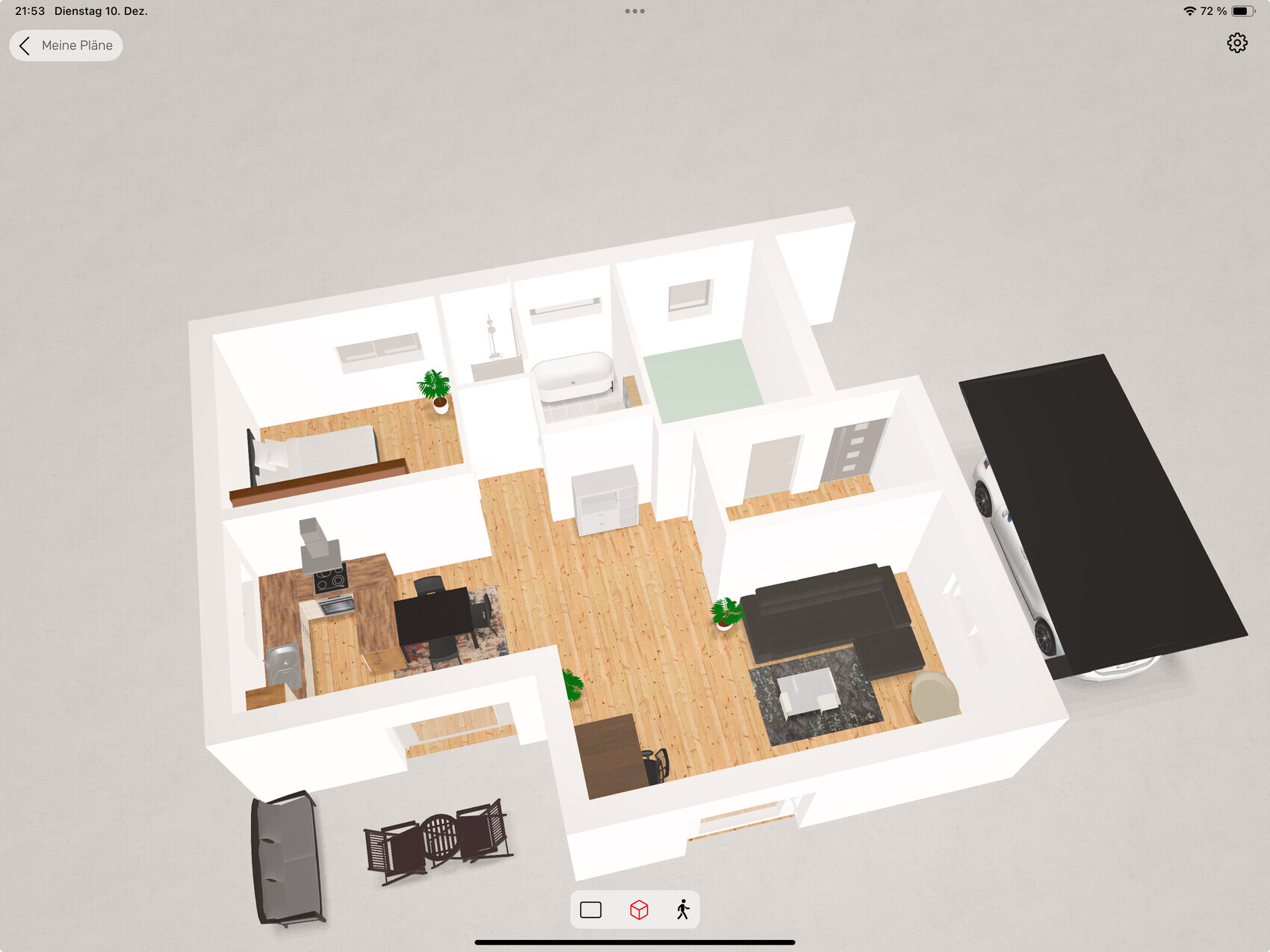

Attached are a section of the development plan and a rough drawing of the house (green), carport (blue) and patio (yellow) on the screenshot from Boris BW.
I have also attached my first attempts at floor plans (once with the entrance in the north and once in the east). I probably used the wrong tool for drafting, but I hope something can still be understood or used.
I look forward to constructive feedback.

Newbee-BW schrieb:
I really like that one too!Would it be worth it for you if I rearranged the last one horizontally, so that the kitchen and living area are more or less separated, like in the last layout?N
Newbee-BW10 Dec 2024 21:52Hehe, I’ll mark a few corrections for you.
The corrections mostly speak for themselves.
The front door should naturally open toward the hallway, not the wall. Move the utility room door so there is storage space behind it. This will actually create more usable space than a wrongly positioned door.
The hallway door should also open into the room, not outward. Plan the awkward corner in the utility room, not in the open living area.
Move the bedroom door away from the corner. If the wardrobe is hidden behind the door leaf, it creates a better entry experience and overall room feeling, instead of having to walk into the wardrobe.
The bed could become tight on the side. My bed was always 165cm (65 inches) wide here.
I would probably place the window on the west side rather than the north and then rotate the bed. That would give you more flexibility with two windows on the north side. The utility room could also have a window on the east side.
The windows will need to be changed anyway, since having one above the bathtub is inconvenient for ventilation and/or cleaning. Windows give a house its character!
Pay attention to the kitchen: I always planned for 3 tall cabinets for enough storage space or the option of a side-by-side refrigerator. Currently, there is only one tall cabinet shown.
The terrace will probably need a support pillar.
Newbee-BW11 Dec 2024 10:18@ypg great - thanks!
My thoughts regarding the entrance door opening and the door to the open living area: I had positioned them that way so the door leaf could open more than 90 degrees. But that probably isn’t very practical.
I placed the bedroom door so that during the move, the long wardrobe pieces could be brought in more easily without hitting the corner of the bathroom. But you’re right about walking into the wardrobe — your suggestion looks better.
My bed is only 140 cm (55 inches) wide, so it should fit with the spaces on both sides. I placed the bed opposite a wall (in case I want to have a TV in the bedroom later and don’t want to look at a wardrobe).
And yes, windows are a topic on their own...
The kitchen with the dining area is still open regarding the best layout. Tall cabinets are great; let’s see how or if I can incorporate them.
Yes, I forgot to include that in the drawing.
The terrace will probably need a pillar.
