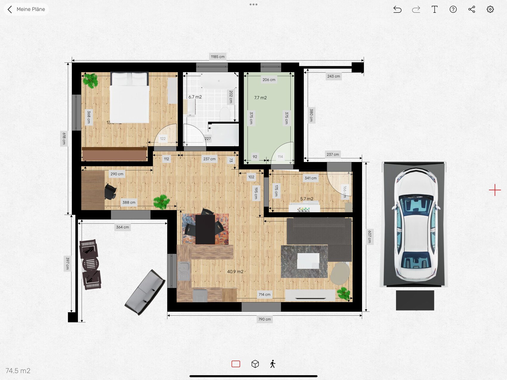

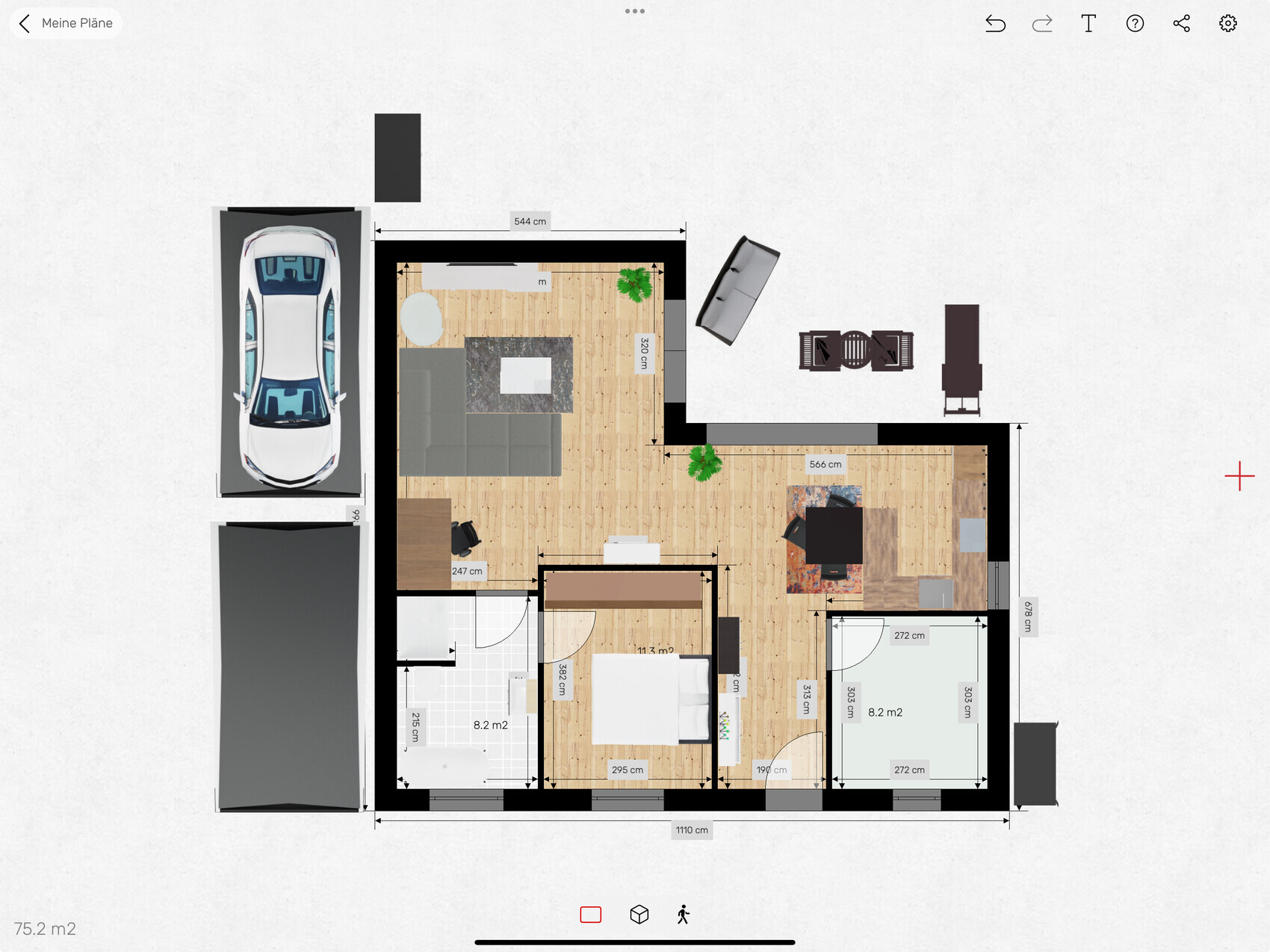

unfortunately, my post simply disappeared again yesterday, so I’ll try my luck once more.
A brief introduction: I am 48, female, single, and based in northern Baden-Württemberg.
I’m still at the very beginning of my house-building planning but already own a plot of land, for which I will sign the purchase contract in the coming weeks.
I want a small, single-story house without a basement, with a small, low-maintenance garden and nothing fancy.
It is unclear whether another person might move in ever, so I don’t want to plan for that at this point.
Basically, it would depend on the cost what 10-15 m² (100-160 sq ft) more would mean, as my budget is naturally limited.
Room plan
Kitchen + Dining + Living + Work approx. 40 m² (430 sq ft)
Bedroom approx. 14 m² (150 sq ft)
Dressing room -
Work/Guest/Child room approx. 10 m² (110 sq ft) optional
Bathroom + WC approx. 7 m² (75 sq ft)
Hallway approx. 5 m² (55 sq ft)
Utility room approx. 8 m² (85 sq ft)
Guest WC -
Storage room -
Total approx. 75 - 85 m² (810 - 915 sq ft)
Questionnaire regarding the floor plan:
Plot size 392 m² (4,220 sq ft)
Slope North-south gradient approx. 1.5 m on 21 m (5 ft on 69 ft)
Site coverage ratio 0.4
Floor area ratio 0.8
Building envelope, building line and boundary see development plan
Edge development Setbacks according to open construction style
Number of parking spaces 1.5 (rounded up) per dwelling unit, so 2
Number of stories II (two stories)
Roof type Pitch 38–43°, half-hip roof or double shed roof
Architectural style ?
Orientation East-West
Maximum heights / limits 8.5 m (28 ft)
Further requirements Cistern of 4.5 m³ (160 cu ft) recommended
Garage: with gable roof or green flat roof, carports?
Filling allowed up to 1.8 m (6 ft)
Builder’s requirements
Style, roof form, building type Exemption from gable roof at 30°? Bungalow
Basement, number of floors One story without basement
Number of people, age see introduction
Space requirements on ground and upper floors Ground floor 75-80 m² (810 - 860 sq ft)
Office: family use or home office? Home office, integrated in living-dining area
Number of overnight guests per year 0–1
Open or closed architecture ?
Traditional or modern construction style ?
Open kitchen, kitchen island Kitchen island with depth like regular kitchen cabinets, followed by dining table
Number of dining seats max 4
Fireplace Undecided
Music / stereo wall No
Balcony, roof terrace No
Garage, carport 1 carport, 1 parking space
Vegetable garden, greenhouse No
Further wishes / special features / daily routine, including reasons why some things should be included or not - No separate office for home office because I don’t want to spend most of the day in a smaller room but rather in the living room with a view of the garden
- Retractable staircase to the attic (additional storage space)
- Wall in bedroom for wardrobe at least 2.75 m (9 ft) long
- Wall in living room at least 2.45 m (8 ft) long for lowboard with TV
- Bathtub – uncertain if necessary
- Larger shower 90 x 120 cm (36 x 47 inches) with tiled partition wall (avoid glass wall)
Who designed the plan: DIY, based on floor plans from Hanse Haus and various other small house providers
What do you like? Why? Open living-dining-working area in the southern part of the house, utility room not directly next to the bedroom (noise from technical equipment)
What do you dislike? Why? Possibly the hallway / entrance area is rather small
Cost estimate according to architect / planner: ?
Personal price limit for the house, incl. equipment: 250,000–270,000 Euros (approx. 270,000–290,000 USD) turnkey, excluding foundation slab, earthworks, secondary building costs, furnishings, and landscaping
Preferred heating system: Not yet decided, possibly underfloor heating
Other considerations Maximum house length 11.5 m (38 ft) because plot width approx. 18 m (59 ft) minus carport 3 m (10 ft) minus setback 2.5 m (8 ft) minus 1 m (3 ft) buffer in case plot is shorter than 18 m (measured on Boris BW)
Carport position could also be on the west side
To maximize green space and deal with the slope: house with long side parallel to the street
No preference yet regarding solid construction or timber frame, KfW 55 or 40 or X standard
Outdoor facilities - Patio approx. 15 m² (160 sq ft) level with the house
- Lawn may have slope
- Carport with parking space in front
Earthworks Southern boundary: retaining wall needed to manage slope, neighbors (right and left) have done this with 1.4 m (4.5 ft) L-shaped concrete blocks or hollow blocks,
rough offer from earthworks company is available (wall, grading, compacting and preparations for foundation slab, foundation slab, patio and carport [= crane location], graveling, drainage, grounding ring, multi-utility lines, site setup etc. all together approx. 60,000 Euros)
Attached are a section of the development plan and a rough drawing of the house (green), carport (blue) and patio (yellow) on the screenshot from Boris BW.
I have also attached my first attempts at floor plans (once with the entrance in the north and once in the east). I probably used the wrong tool for drafting, but I hope something can still be understood or used.
I look forward to constructive feedback.
Thank you in advance for your time.

4 Dec 2024 14:27
Thanks for the kind words.
Newbee-BW schrieb:
Simply wow! Thank you so much for your feedback – it’s great to be here!
I’ll take that as referring to us friendly users.
With the house size you want, almost everything is possible since you don’t really need to consider any significantly complex structural engineering. Small and neat can work well, for example, a Pax wardrobe can serve as a built-in closet in the hallway, providing storage space even in a small room for miscellaneous items.
Anyway, your two designs are a good starting point – I’ll take a look this evening to see if I can come up with some straightforward ideas. Or do you definitely want this slanted wall? (Don’t say the wrong thing…)
By the way: has the question about the plot width already been answered? And how tall are the neighboring houses? Is there already a neighbor on the right side of the property?

Small and neat, a built-in wardrobe like a Pax can occasionally be used in the cloakroom, so that even in a small space there are storage options for clutter?!
Yes, the Pax is definitely welcome. I like to keep things practical.
Or do you really want that slanted wall? (Don’t say anything wrong...)
No, it’s not a must. I saw it on the Hanse Haus floor plan for the “Bungalow 80” and thought it was nice because it’s something different from a straight wall. But it’s not essential.
Thank you for taking an interest in my “masterpieces” – much appreciated!
Plot width: measured on Boris BW online about 18 m (59 feet)
Neighboring buildings: now on both right and left, each with a basement, garages, and two stories. Both have their garages located right on the boundaries of “my” plot. I hope that makes sense...
