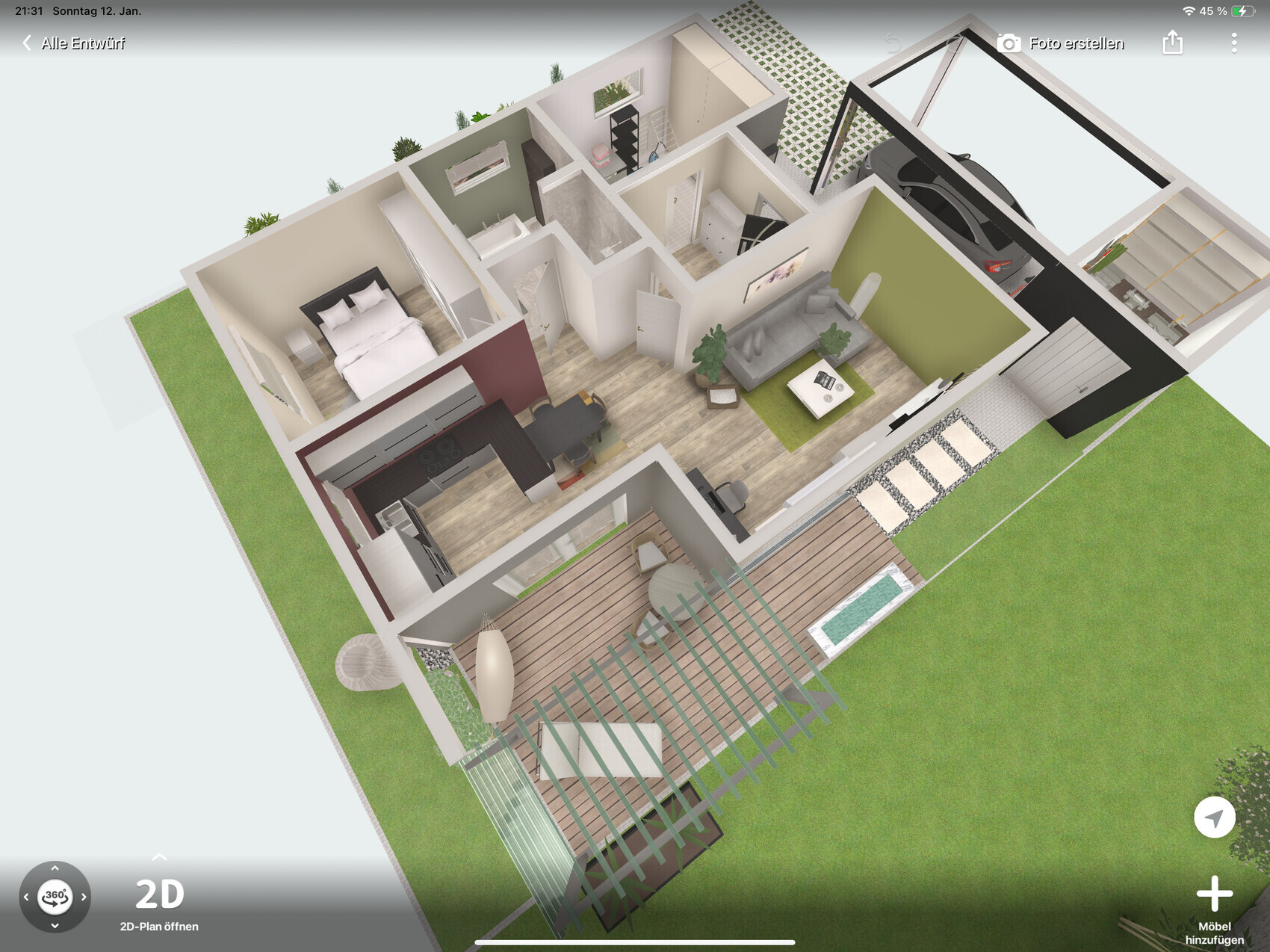

Newbee-BW12 Jan 2025 21:35@ypg Hello, thanks for asking. I have a surveying appointment in two weeks, and after that, I’ll meet with the architect for an initial draft to see how my desired floor plan fits best on the plot. In the meantime, I’ve had preliminary talks with Talbau and Hanse Haus and should receive their offers within the next two weeks. So, nothing is decided yet and it stays exciting. I’m happy to share my preferred floor plan with you – I’ve experimented a bit… but I just like it, and I discarded all other options because something was always off.
For the patio doors, one panel is fixed glass and the other is a regular patio door. I’ve also already completed an initial kitchen layout using the I*EA configurator…
Newbee-BW schrieb:
HelloGlad to see you’ve made a decision for yourself. I recognize many elements from the other designs: the desk position, the shower, your preferred kitchen and sofa layout. The outdoor area is also well planned. I don’t want to pressure you, but some progress photos of the build and the finished terrace would be much appreciated. Haha
Newbee-BW12 Jan 2025 22:37I will definitely keep you updated here and, of course, still have many questions. I will get back to you as soon as I have the plans.
