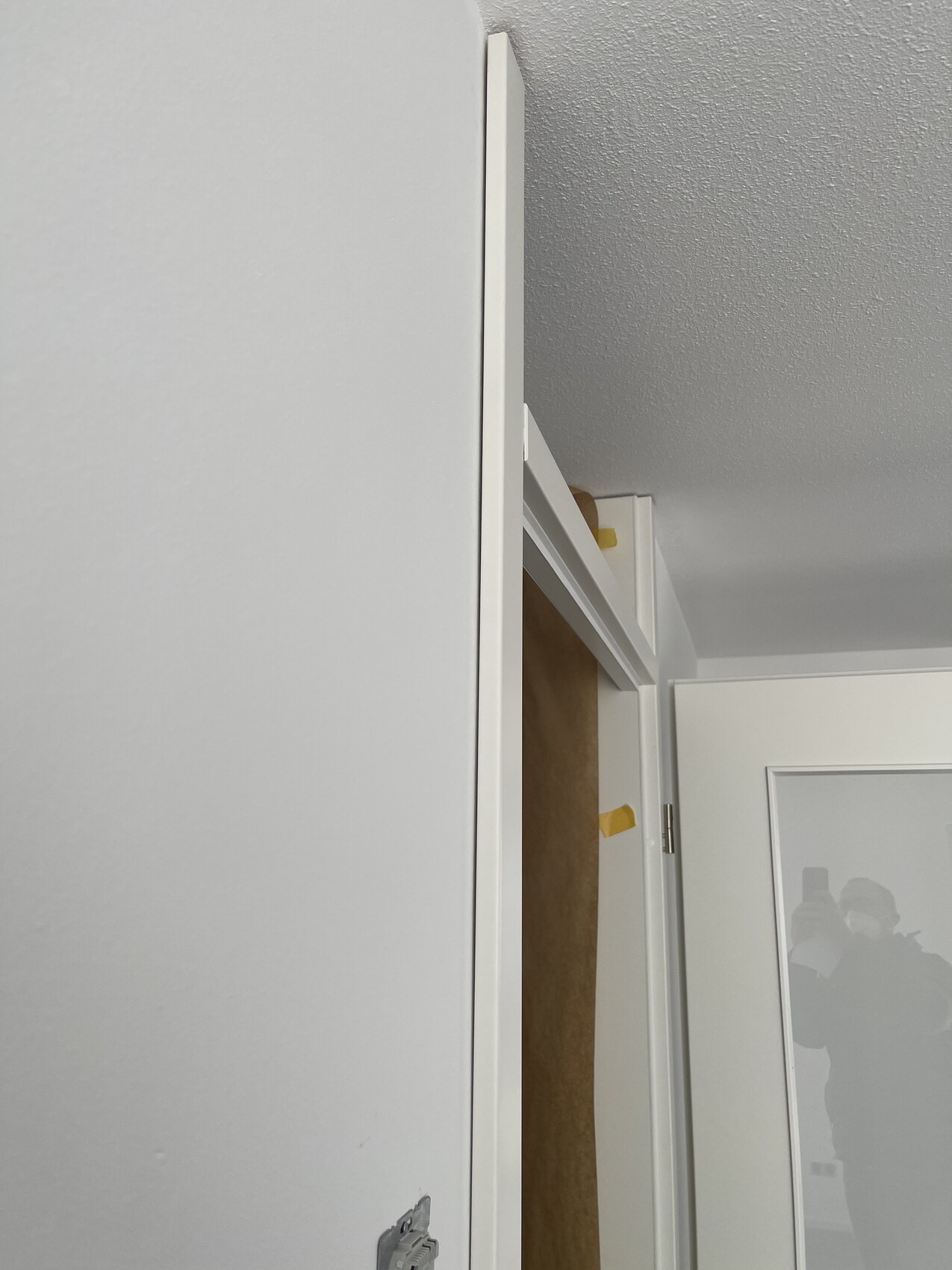

Stargate85
30 Apr 2021 10:45
Many thanks for your answers.
I also have a photo of the door. They all basically look similar. See attachment. No one will make any corrections, I just want to know if I can expect financial compensation at handover and declare this as an official construction defect.
Interior photo: white doors, painter’s tape on the frame; door with glass reflecting a person.
KingJulien30 Apr 2021 12:38
The door frames must not be aligned based on the wall. They need to be set perfectly level; otherwise, the doors will always swing open or shut on their own.
So that works, provided they are level.
Acrylic is also suitable.
