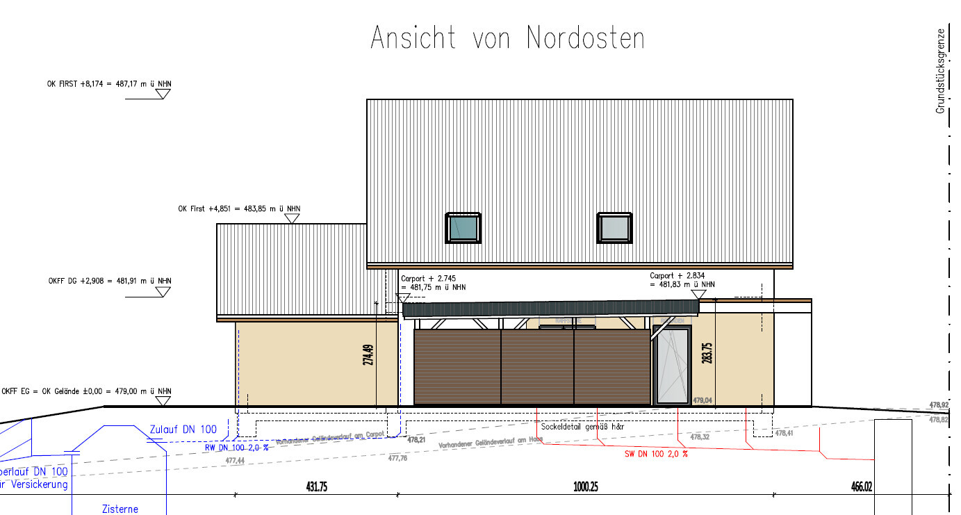

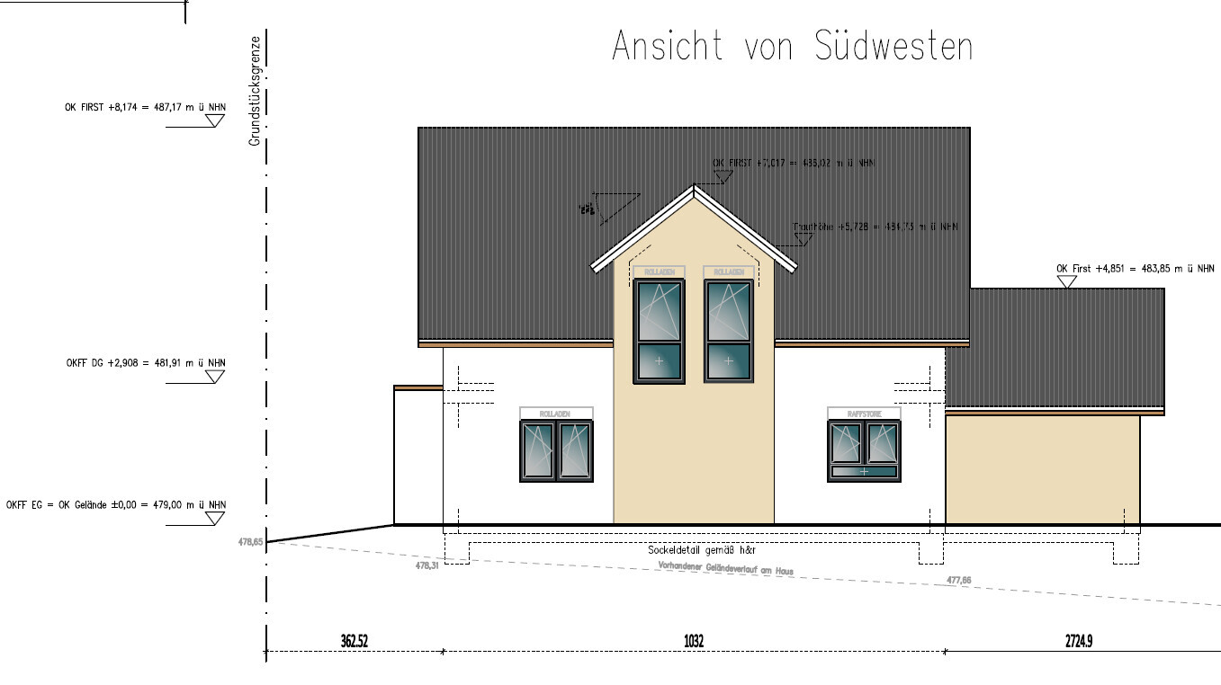

The building permit application has been submitted. In my opinion, hardly any further changes to the floor plan make sense now. But some are absolutely necessary. At least the height was not indicated in that section.The heights were just cut off because otherwise I wouldn’t have been able to fit the entire elevation profile of the plot into the image. I have attached them again. By the way, the building permit was approved today! 🙂

OK, then have fun building. I would reconsider the option of significantly simplifying the site and saving another tens of thousands. You will get a much larger area in the southeast that will be level with the house. The terraced grading is not excluded in the building permit / planning permission, so I would try to lower the house’s starting height by a few centimeters (inches) and also reduce the amount of fill a bit. Part of the fill around the house can be replaced with the excavated soil.
I will report back on any unexpected issues and how accurate the cost estimation was. 😀
